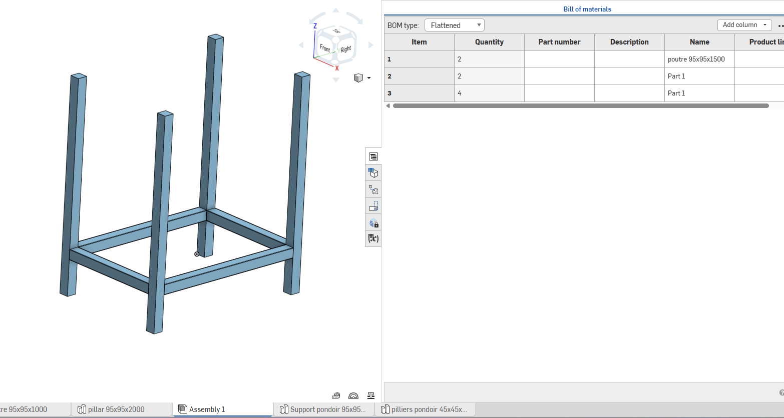

I se just "part 1", instead of the name I gave it. Or do I have to create a version first, and why?NeilCooke said:What do you see?0 -
A Part Studio can contain multiple parts - you have to rename the part in the Parts List, not the name of the Part Studio.Senior Director, Technical Services, EMEA0
You can use the BOM on the right side of the screen, choose Name from the drop down list
You can also change the name here as well.
The Bom list is empty
@martijn_grunwald - Now try clicking the "Add column" button at the top of the BOM list and adding the column for Name.
It looks like the BOM is correctly showing the quantities of the parts, but it appears empty because the parts don't have descriptions or Part numbers. If the parts have names, they'll show up when you add the Name column.0 -
It isn't empty, it is showing the part number and description of 7 unique parts. You have yet to fill in any information into those properties so they are still blank. What you are seeing are the default 4 columns 'item no' 'qty' 'part number' 'description'. This will need to be changed on every assembly you want to view a BOM with

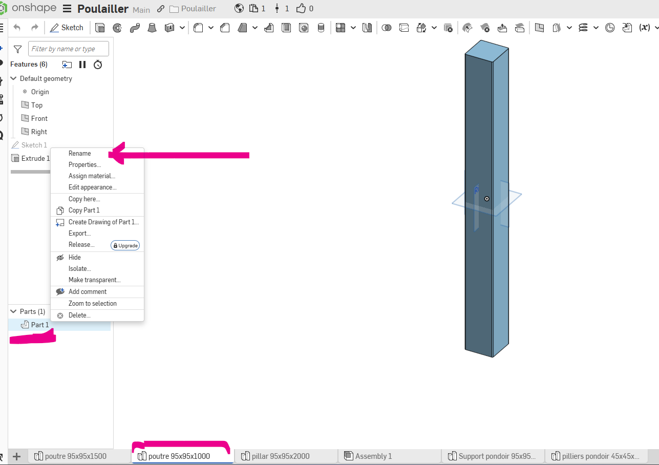

Hi! I had the same issue, I couldn't see the part name even if I added the "name" column, it would be only "part 1" on every part, so you just have to go in your part and rename the solid (see picture at the bottom left). It is weird (to me being a SolidWorks user originally) but it works.
Hope it helps,
You're missing one of the biggest advantages of Onshape. Your whole design should be modeled in a single part studio. Not one piece in one part studio like you have now. The name on the bottom tabs of the screen is only the name of the part studio. It never shows up in the BOM, as it has nothing to do with any individual parts. Think of it more as a folder or category for all the parts modeled inside of it.
Renaming the part studio TAB has nothing to do with part name.
Rename the part not the tab.
