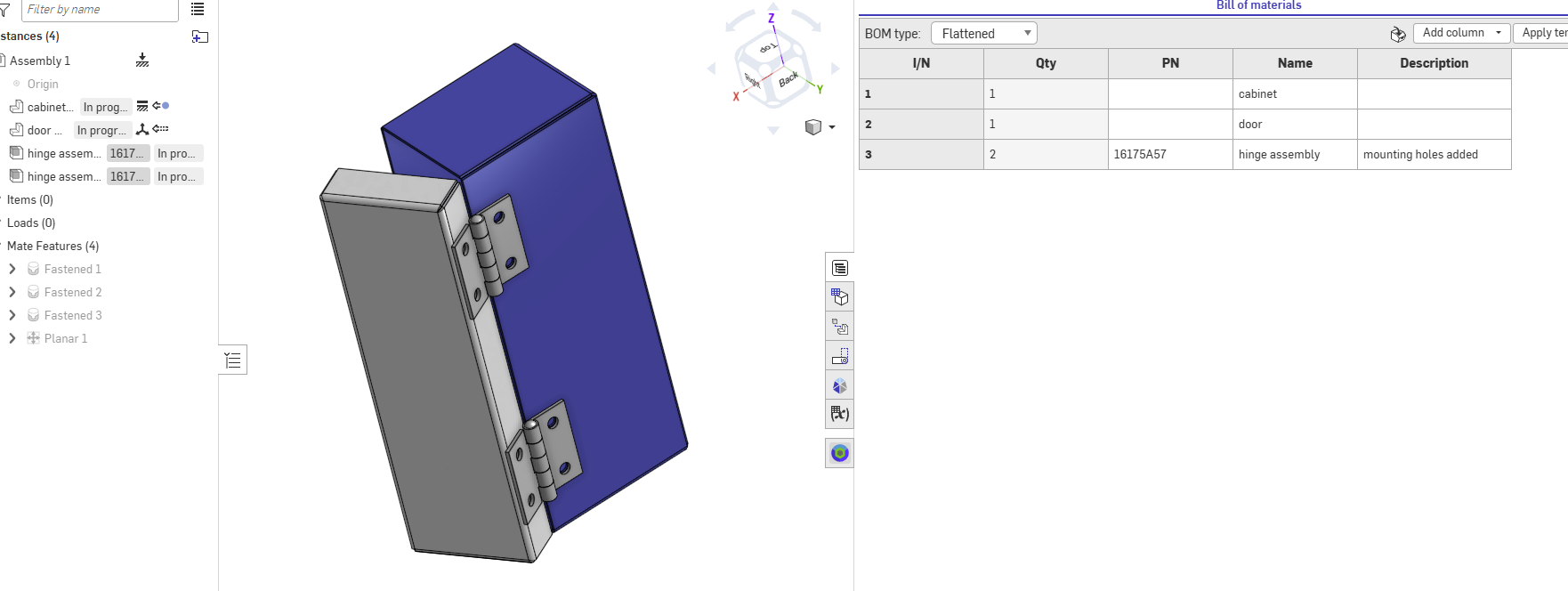

    Here's another example from SW:

  • paulpat1000
    paulpat1000 Member Posts: 3 PRO
    @eric_poulson
    We also arrived at this last 10- step approach. But it has one (fatal?) flaw: at some point, someone will eventually execute a "show all" in a some assembly higher up and then the un-modified part will re-materialize. Have you found a way to deal with this?
  • glen_dewsbury
    Here is a sample that uses and assembly to make a working off the shelf part. All the parts in the assembly are excluded and will not show unless you're in the BOM and pick show excluded/suppressed but there will be no item number applied. Parts don't show in levels above. Vendor and part number are applied to the assembly as though it's one part.
    https://cad.onshape.com/documents/475a626dc9c0481583cfe0da/w/5ecc800cc510f005bbf64320/e/30b38f6fb9f30c4bfa0e5e64
