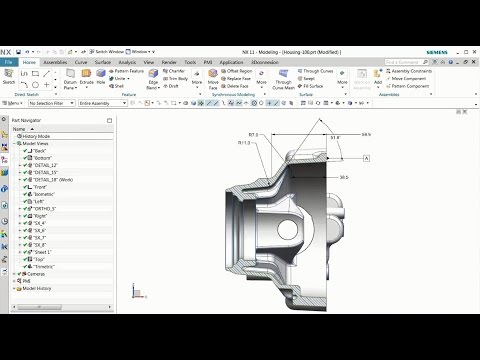

    Or... we'll have to have a Convert to 3D MBD like NX which is really nice in hindsight; the reverse philosophy.
    https://www.youtube.com/watch?v=fTekE-Jyrk4
