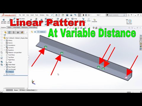

    I agree my "solutions" were over the top. I meant them to be examples of some of the powerful stuff you could set up in other situations. I do remember liking how Solidworks handled it. Here's a video showing the workflow https://youtu.be/oisuBea5LI8?t=113
    Huh, I didn't know you could do that - must be a recent-ish addition? My apologies for doubting you @David_Bower1
