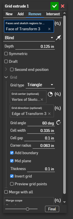

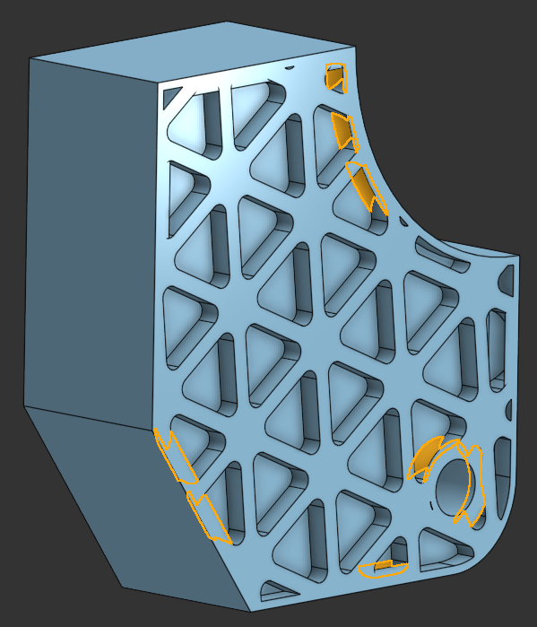

  • william_knoblauchwilliam_knoblauch Member Posts: 20 ✭✭
    Hey Evan,

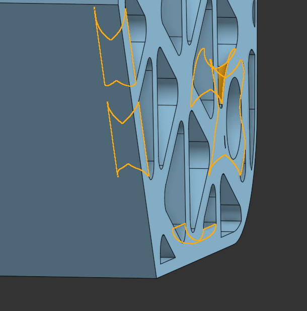

    I recently found an issue with your script when trying to make a grid that subtracts from a part. I'm getting these weird fillets at the border of the pattern.
    It doesn't seem to be a systemic problem. It just happens when inverting the grid with a border and corner radius. Here are the settings I'm using:
    I'm pretty sure it's just the fillet query for the edges of the boundary.
    if (!tolerantEquals(definition.cornerRadius, 0 * meter) && !isCircleHex && !isCicleSq)
                    const moreToFillet = qUnion([qNonCapEntity(id + "boundary", EntityType.EDGE), qCreatedBy(id + "boundaryBoolean", EntityType.EDGE)]);
                    opFillet(context, id + "fillet2", {
                                "entities" : moreToFillet,
                                "radius" : definition.cornerRadius
    Restricting the queried edges to follow the direction of the extrude works, but there are still some edges that fail. (That's why I added try{} because opFillet() seems to fail even if you just look at it wrong)
                    const moreToFillet = qUnion([qParallelEdges(qNonCapEntity(id + "boundary", EntityType.EDGE), direction), qParallelEdges(qCreatedBy(id + "boundaryBoolean", EntityType.EDGE), direction)]);
                    try {
    I made a copy of your document and added those qParallelEdges() functions, and it works pretty well when doing what I wanted. The fillets fail when making a new part with a boundary, but with the original query, the whole script fails anyway.
    Thanks for the awesome script!
