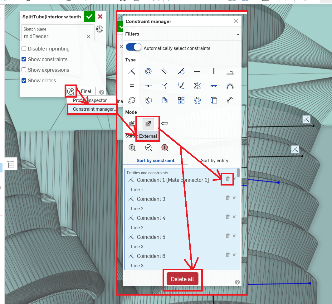

  • m_m452
    m_m452 Member Posts: 2 ✭
    So, the problem is when you use delete part its still in your document history, and can cause things to slow down or hit the complexity limit.
    There is a way to break the links in the sketch, but still leave the points as they are. You then need to/can dimension/constrain the sketch as normal.
    sketch dialong box>magnifying glass+pencil button>external references option>delete all. You need to do this for all sketches that reference the original stl. Then just go back in your history, and delete your import.
    (Sorry, I am aware that this is an old post, but there is (now?) a better way of doing this, and it'd be good to have for future users searching, or possibly even op.)
