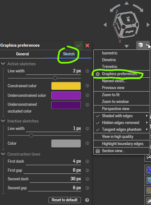

In sketches, how can I change the colour of my under-defined lines ?
john_smith077
john_smith077 Member Posts: 175 ✭✭✭
Hello
In my sketches, I am having trouble visually distinguishing between under-defined lines (blue) and full-defined lines (black). How can I change the colour of my under-defined stuff?

    But that is ridiculous. It's just not all that easy to distinguish between that fairly dark blue and actual black. Edges aren't too bad but vertices can be very  difficult.  I am still evaluating onshape so voting for things may (or may not!) come later.

    Hi @john_smith077 ,
    Thanks for the feedback!  Some other users were having similar troubles and had a discussion about chrome plugins that can change our site to be of higher contrast:
    https://forum.onshape.com/discussion/comment/32391
    Our improvement requests are located on this forum in the section marked "Improvement Requests".  If you go to that section and click "New Idea", you can type in your idea and similar ideas that have already been submitted will pop up.  You can either vote on one of these similar issues or if none of these describe your issue well enough, submit your own request.

  • eric_pesty
    Note that you can now customize sketch line colors (and line thickness):
