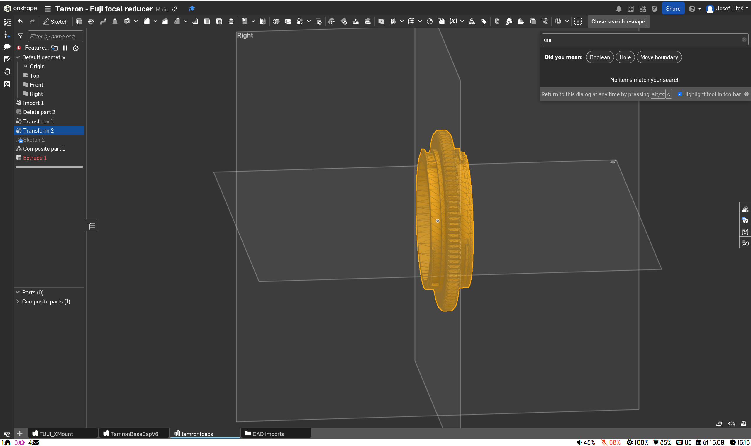

  • josef_litošjosef_litoš Member Posts: 2
    Hi, I'm fighting the same problem, but I cannot find a "unite" action. How could I achieve that?
