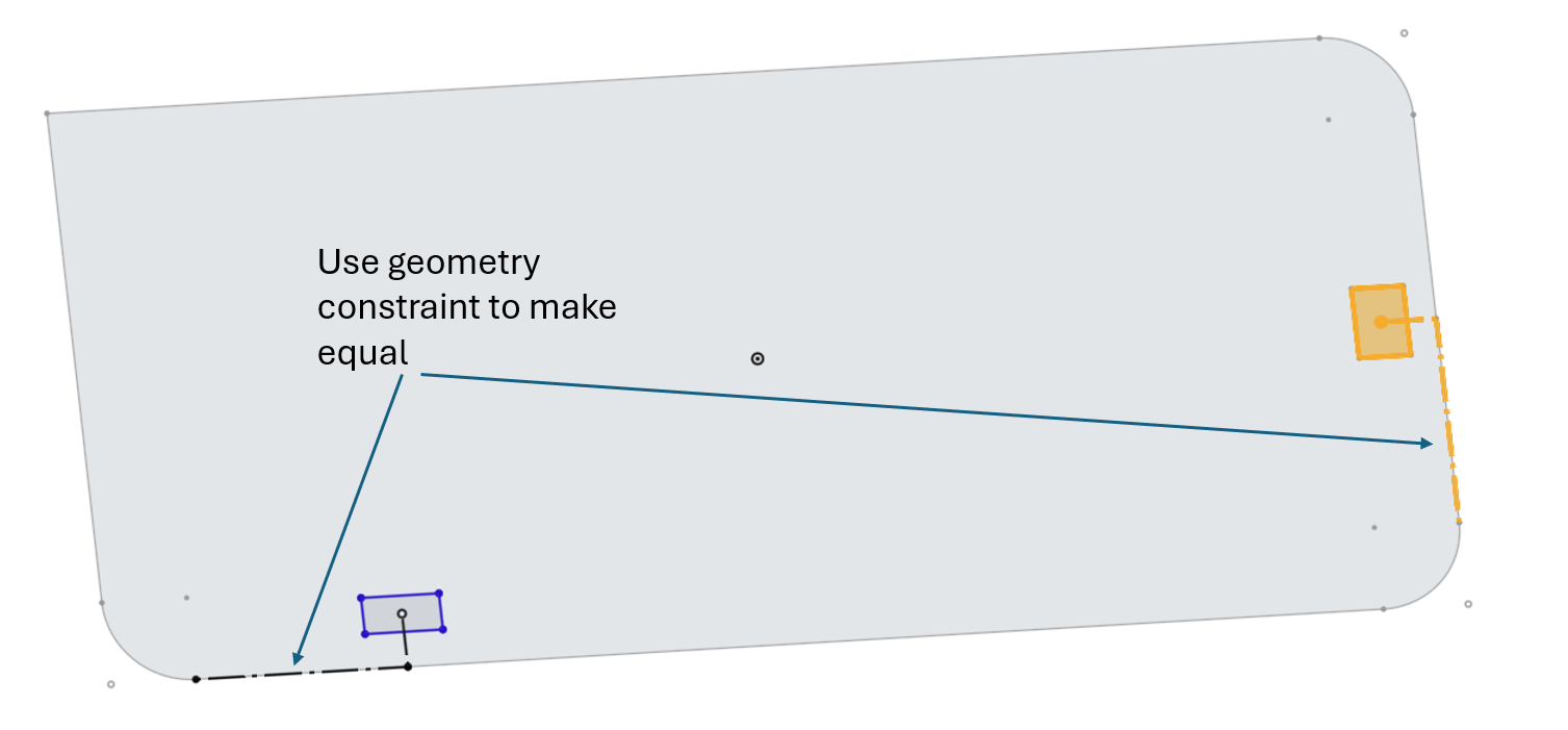

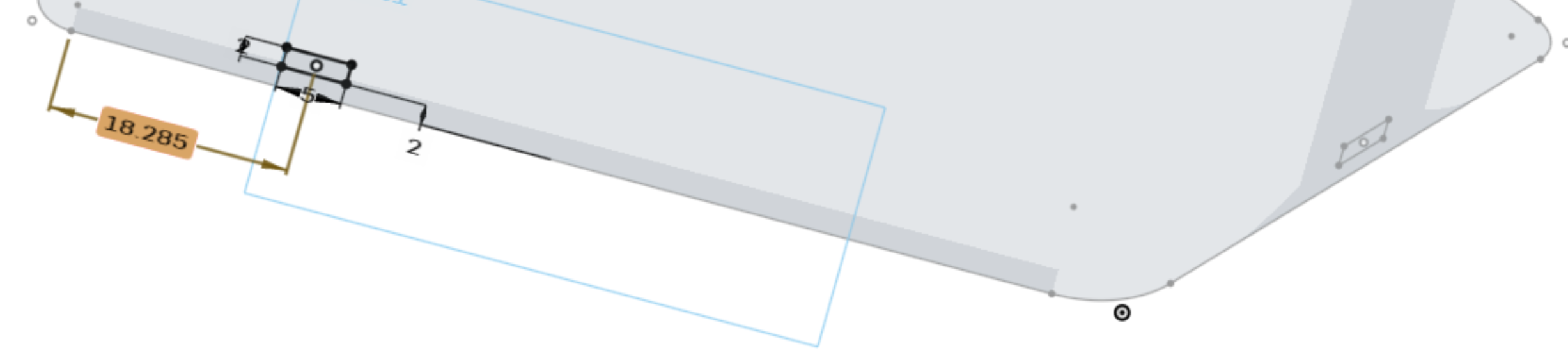

I have these two holes that I want to create, as shown below. The one on the right is in the middle of that surface (I used midpoint).
I am struggling to define the dimension highlighted. I would like it to be the same distance as the other hole is from the right wall. Is there any way to make this happen?
Hi Denwen,
Probably the easiest way to achieve what I think you are trying to do is to use a geomtry contraint to make two reference lines equal. I know my geom is 2d whereas it looks like your sketch maybe on a 3d surface but the approach should work either way.
Hope this helps,
Paddy

Cool, thank you much for this suggestion!
