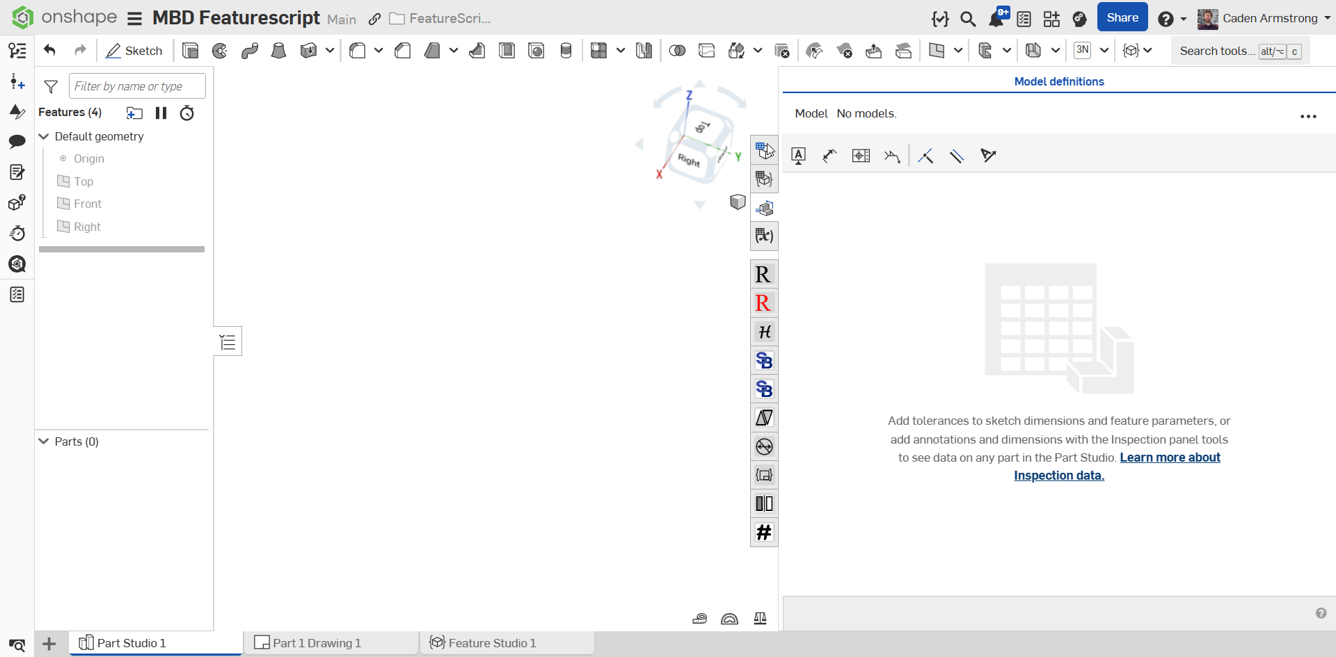

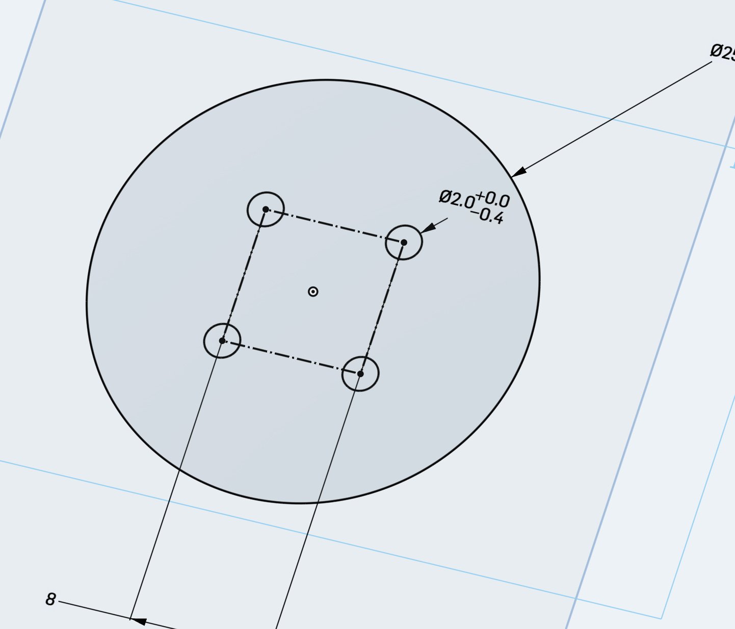

MBD isn't working as shown in the demos for me. There is no tolerance icon to click on or expand.
Followed the example from Onshape on YouTube step by step. What's wrong?0 -
Was also confused by that for a bitโฆ
The dimension has be from line to line rather than just the length of the side of the rectangle.3 -
That was it! Thank you.
It works for a new part, but old parts can't be used. No way am I going to redimension everything now.Also still can't get it to create a Datum.

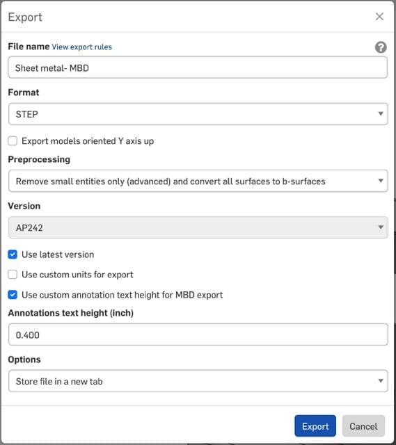

MBD represents a real shift in workflow. With properly defined model-based data, traditional drawings become optional in many cases. Modern CNC and sheet-metal systems are increasingly capable of consuming models with embedded MBD directly, reducing documentation overhead and minimizing interpretation errors.

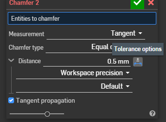

I had a thought and decided to go and check and it turns out that you can in fact use variables in MBD dialogues, so you could automatically relate a clearance dimension (eg added with a "move face") and the MBD tolerances.
For example make the clearance between two parts 2X the tolerance value.
As far as getting the MBD info into drawings, the hole feature basically previews how that would work as the part studio tolerances have been brought into the 2D drawing environment for a while for these.
