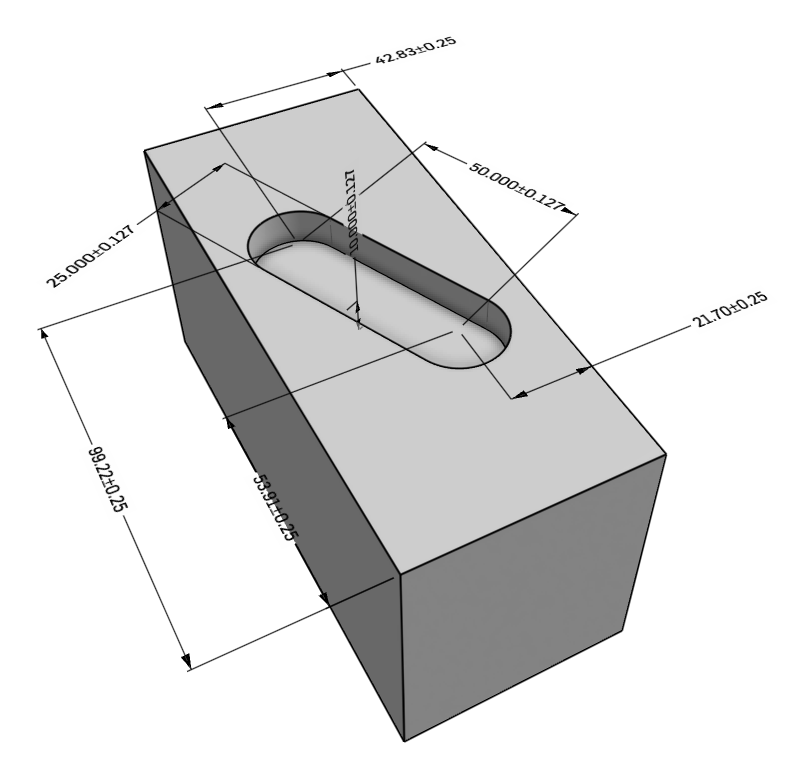

  • GregBrownGregBrown Member, Onshape Employees, csevp, pcbaevp Posts: 380 image
    If anyone is interested (and I suspect some of you are already hard at work doing this anyway) here is an example Custom feature that includes MBD dimensions. This is the Slot feature that I showed in my demos:
    You can examine how the dimensions were set (line 408 onwards) - this section also shows how queries need to be formed in order to perform the setDimensionedEntites. Line 85 has an example of one of the feature parameters being made tolerant.
    This is only meant as an example, perhaps to trigger others to have a go at leveling-up their own Custom features to include MBD. I'm not publishing this just yet as a lot more I'd like to do to it before that milestone is reached.
