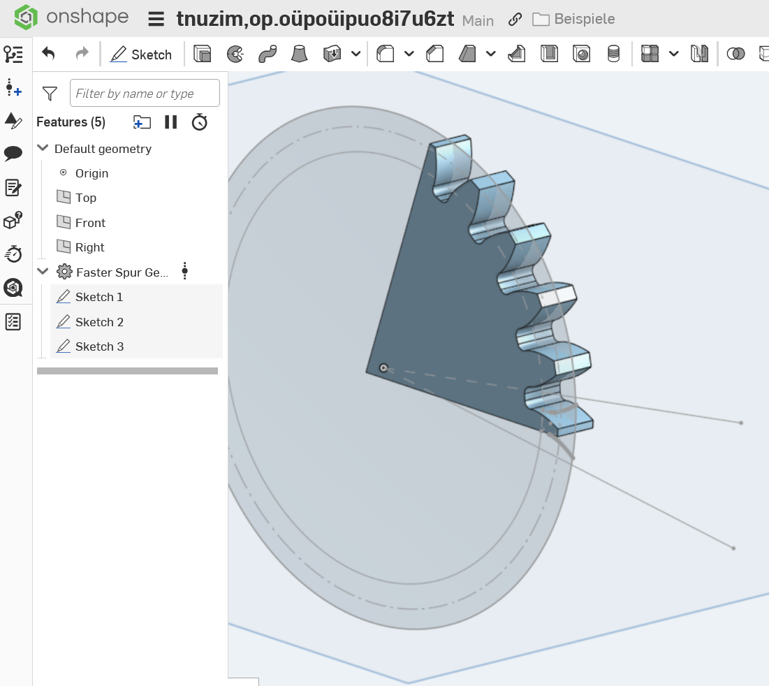

Who created Spur Gear? I made it faster.
Spur Gear is great, but can er very slow for large complex gears. We have been using it to make curved rack and pinion sections and it means making a gear with hundreds of teeth and then chopping it down.

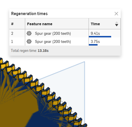

Taking inspiration from Performant Part Pattern, I made the hundreds of boolean operations recursive (pattern, boolean, pattern that, boolean again, etc. so instead of 400 Booleans, there are 8.
This greatly increases performance as you can see in the image from This Doc.

In my defence, it was the first feature I ever wrote (in Jan 2016), way before we had any profiling tools.

All i did was add a small performance boost, but it probably took me longer to do that than it took you to write it.
also, why are some of the listed queries not recognized, Like qInFrontOfPlane?0 -

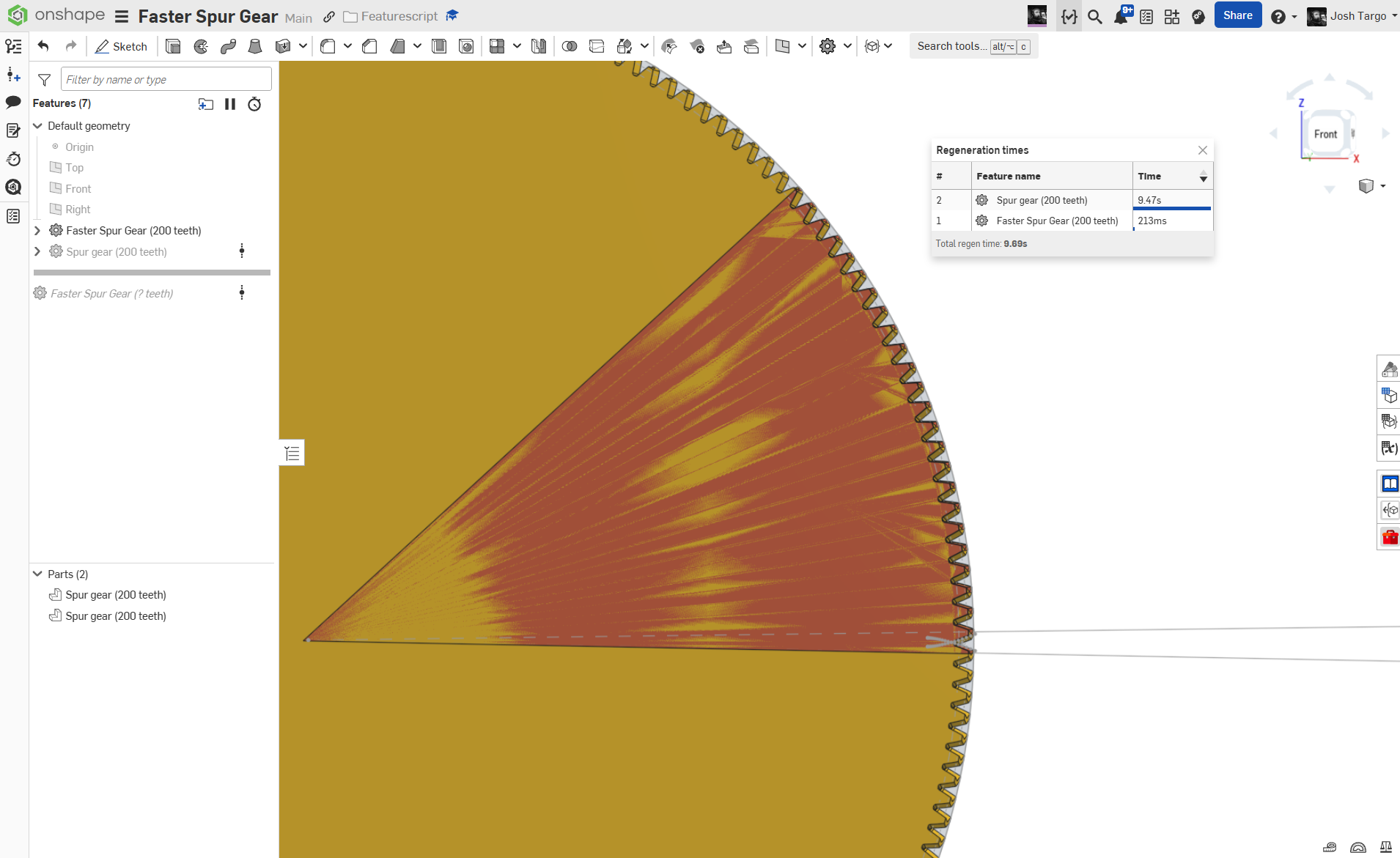

OMG, now we are talkin'! Partial gear support is the performance boost we really needed. 9.47s down to 213ms.

That’s a later query. You’ll have to update the library version.

Partial gear, yeah, great! :0) 👍️Why create teeth we don't need in the first place.
Just a question I came across when playing with it: Wouldn't it make sense, in case of a partial gear, to start with a full tooth (that is in the center of a groove) instead of making a half tooth on both sides?
