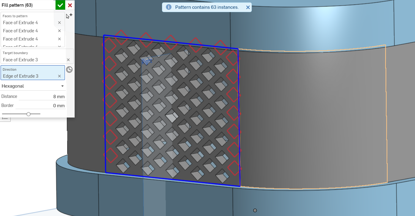

Hello, Everyone.
Does someone know how to use the "Fill pattern" custom feature on curved surfaces, in a way that follows the original fill order?
Is there a different custom feature that can do this?

    You will have to use something like Approximate Face to "merge" the separated faces into one face then use fill pattern on the one large face.

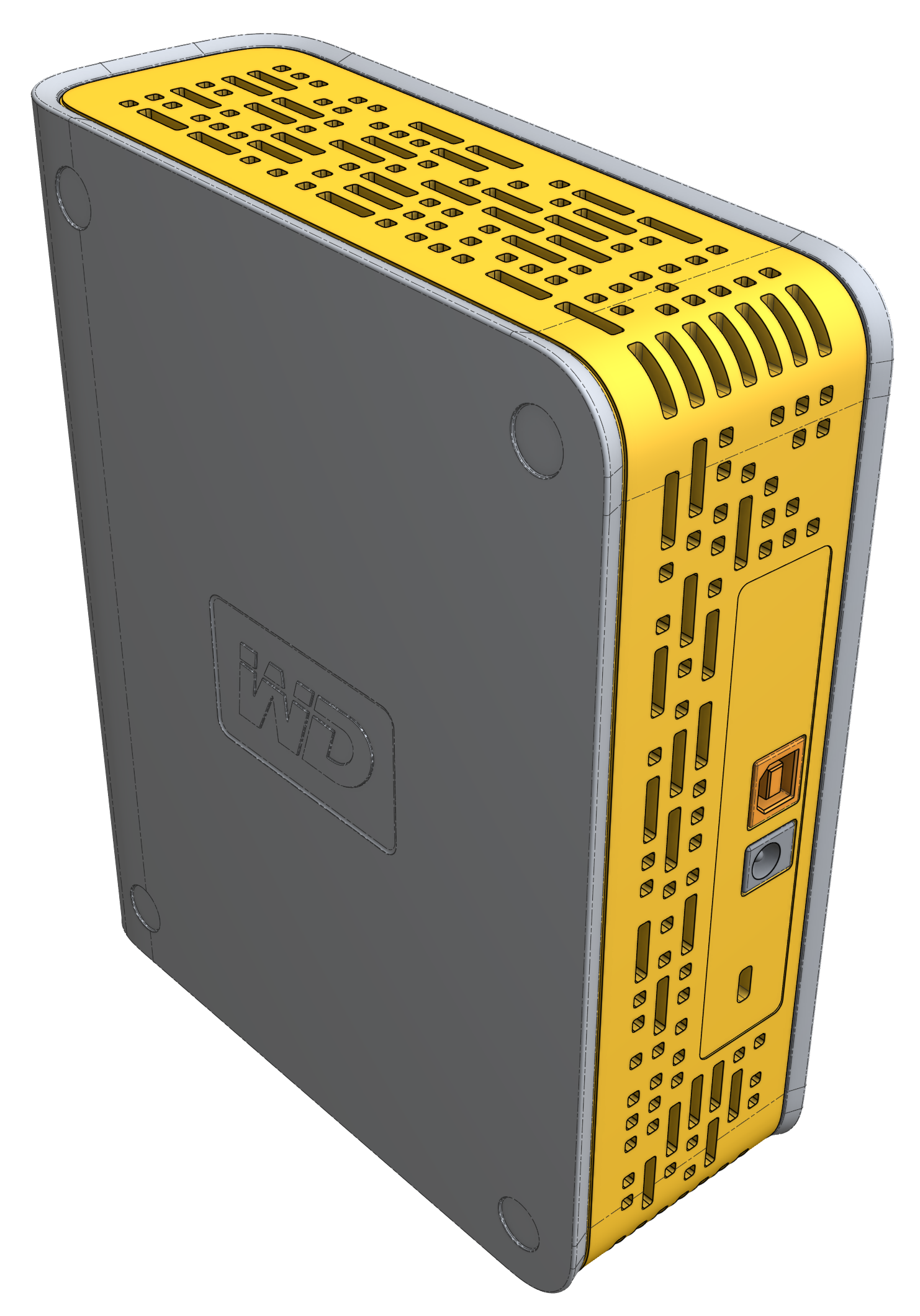

    This brings back some PTSD from doing this the hard way in Solidworks many years ago. The holes all needed to be drafted for injection molding. This also involved a font that the designer created to do the Morse code, which was then set up so we could use the text feature to write out the patterns. Oh and those are curvature continuous-ish corners done with crappy fitsplines.

    Very cool design. But….What does it say?
  • ron_moise
    ron_moise Member Posts: 18 EDU
    I've tried, It "became" one large face yet it just doesn't "allow" it to be selected…Do you know other ways?
    S1mon Member Posts: 4,615 PRO
    Hmmm "citation needed".
    https://en.wikipedia.org/wiki/Western_Digital_My_Book
    The Morse code message written into the drive case is made up of a selection of the words "personal", "reliable", "innovative", "simple", and "design".
    Those were the "brand principles" that we helped define at IDEO for WD.
  • MichaelPascoe
    You could do @S1mon's way 😎
    Share your document link (with copy access) and I'll show you how to do it.
