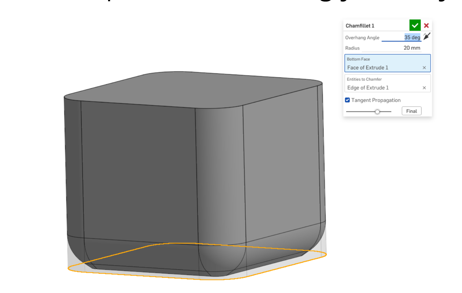

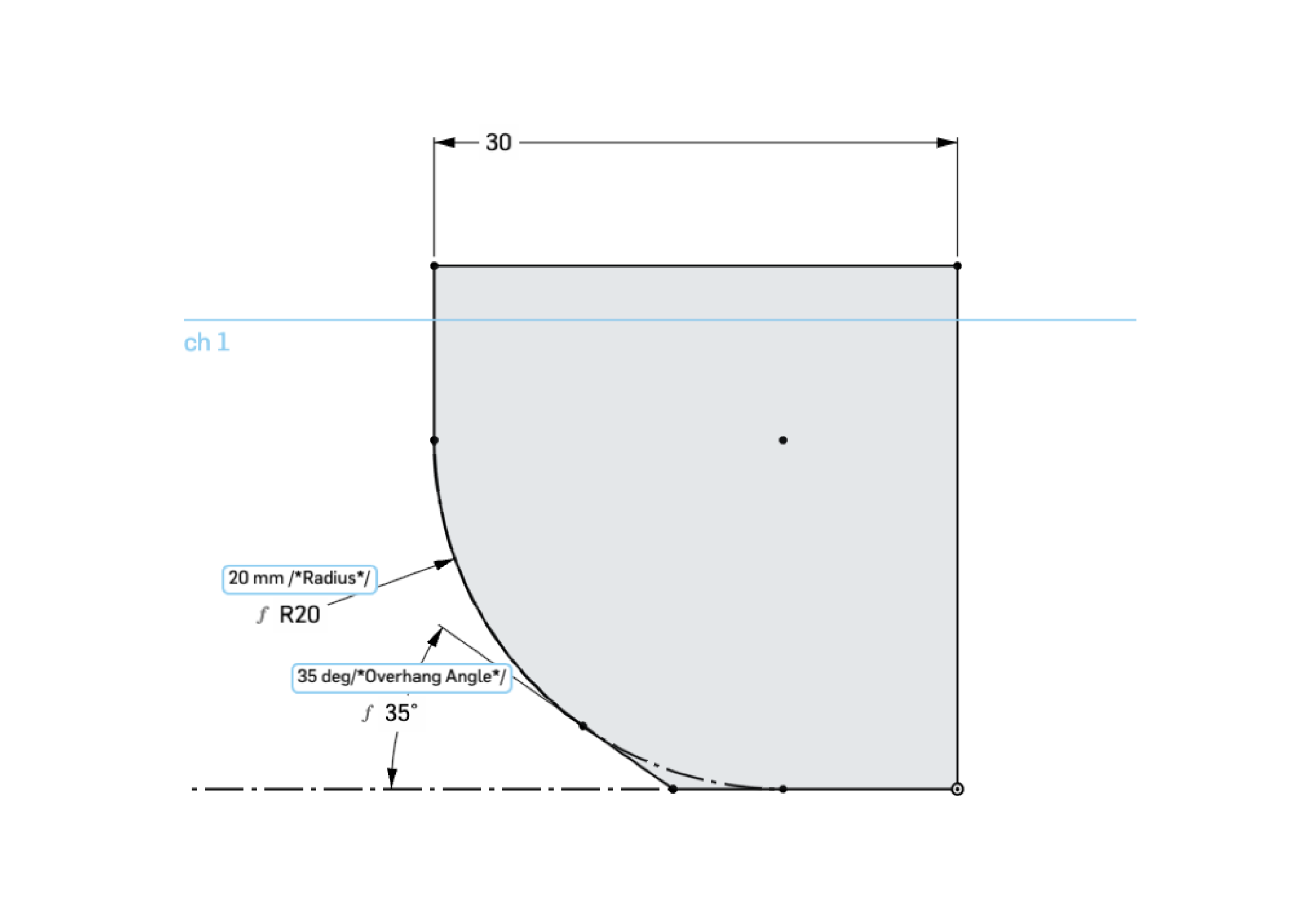

A common problem with 3d printed models (FDM) is that a fillet on the build plate ends up looking ugly because the printer cannot print a horizontal overhang. Usually, if you are designing a 3d printed part, you then use a chamfer on the bottom face because most FDM printers can print at least a 45 degree overhang. But what if you still want a nice curved bottom? Enter Chamfillet! You select the bottom face and the overhang angle your printer is capable of and then it creates a chamfer that blends into a fillet. I did some quick trigonometry to make sure that the chamfer/fillet combo is the exact same size as a fillet on its own. The sketch in the second image shows what is being calculated.

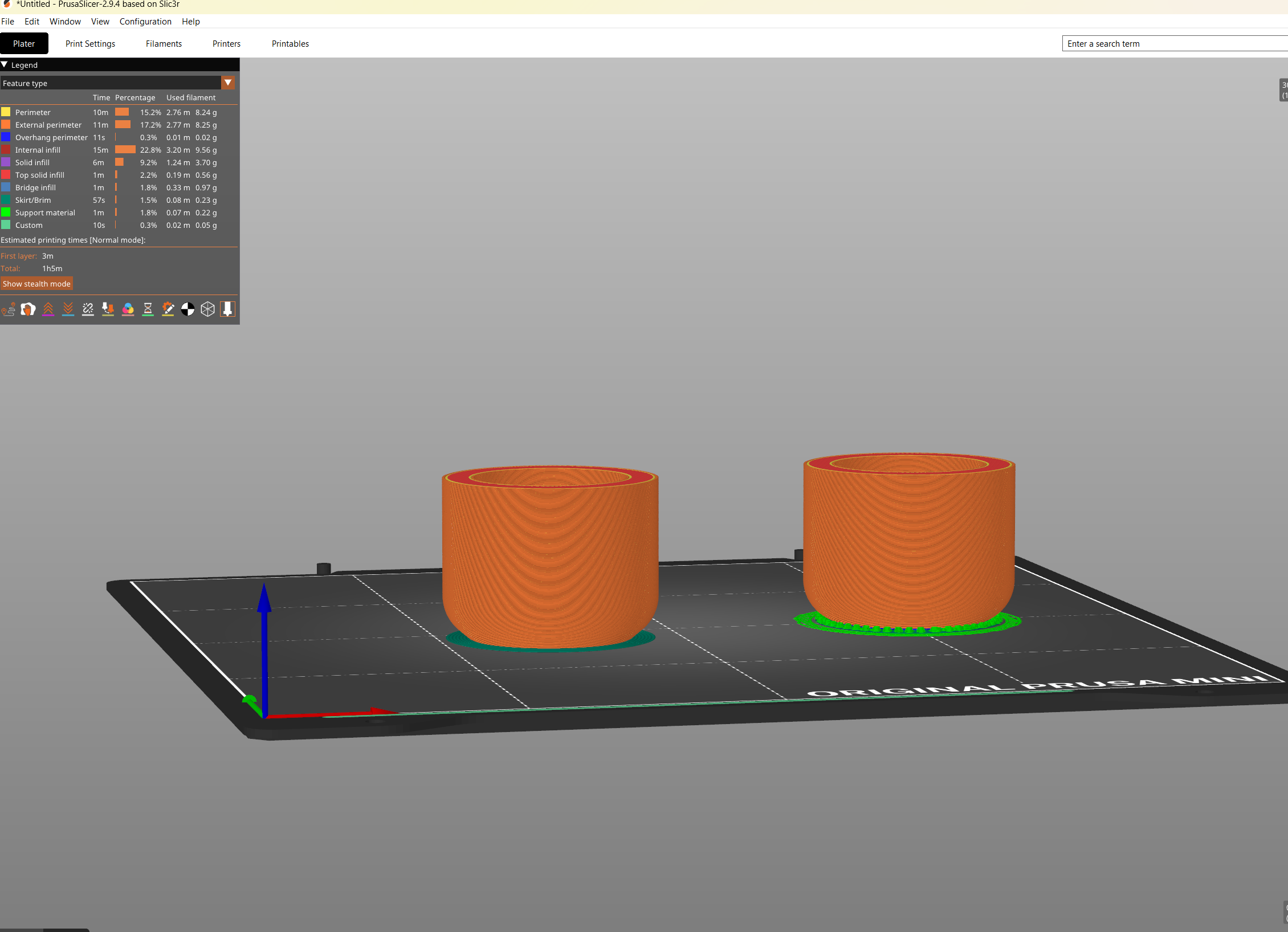

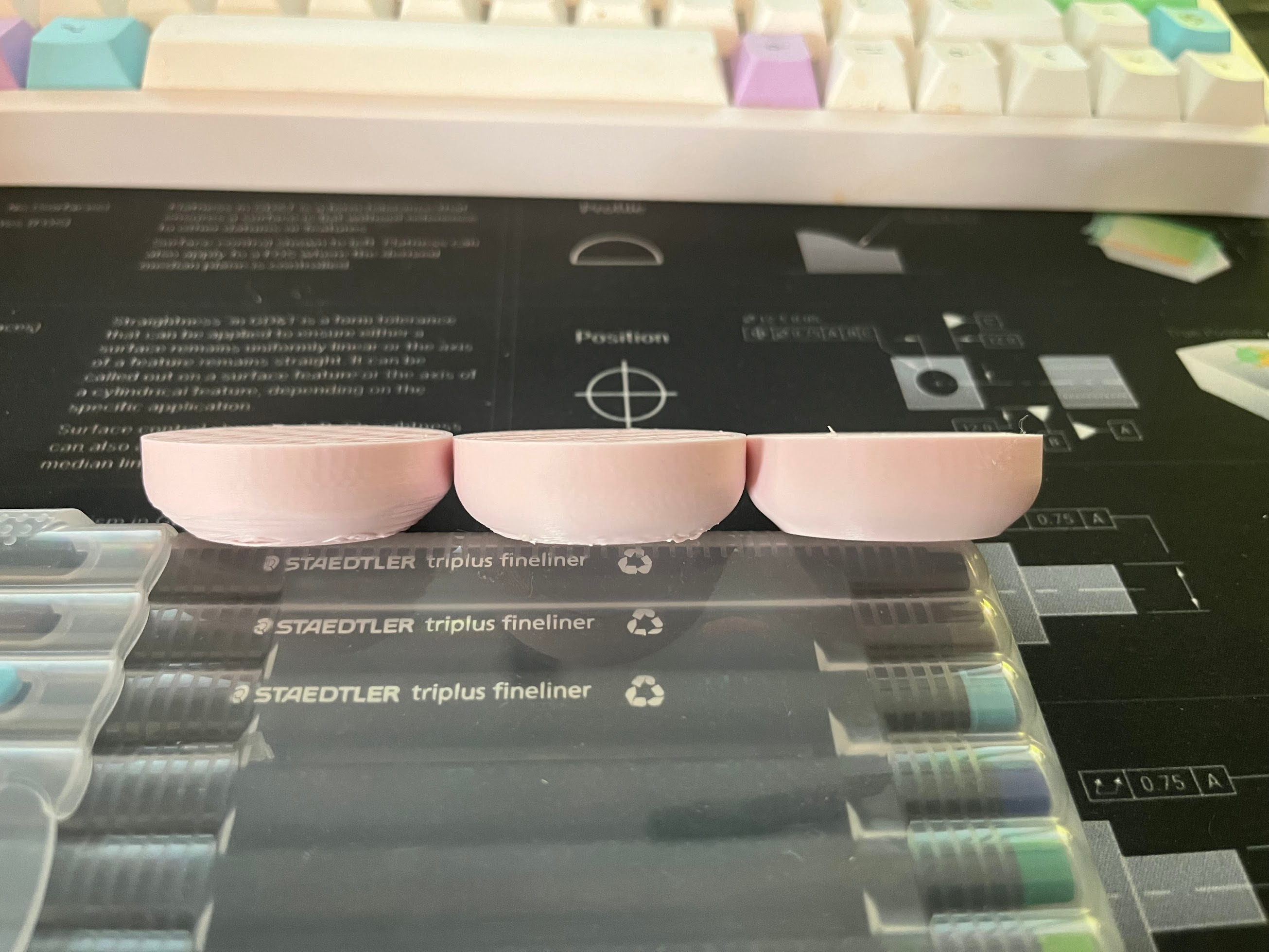

The image below shows a sliced model with a 8mm Chamfillet (left) and a 8mm standard fillet (right). As you can see, the slicer wants to put support material under to standard fillet to support the surface because the fillet is technically 0 degrees from the bed, which the printer cannot print. Supports are annoying to remove, especially at production volumes over 1-5x and will leave marks on the surface.

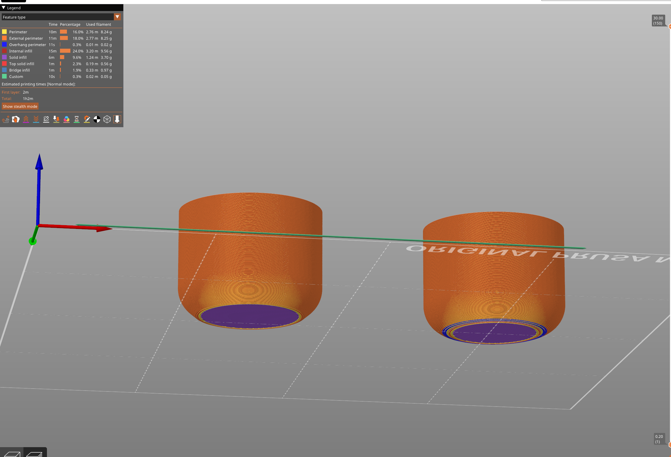

The other option is to turn off supports, which the slicer rightfully warns us about. The blue lines represent unsupported lines.
3D Printing Results: Fillet, No Supports (Left), Fillet With Supports (Middle), Chamfillet (Right)
The Chamfillet and With Supports models look about the same, but the Chamfillet does not require post-processing. No supports looks droopy.
Good Luck!

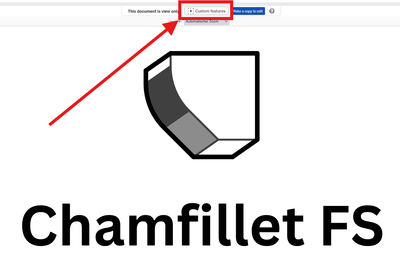

@jim_zamecnik That's pretty easy. Go to Brett's first message, hit the link at the top. That gets you to an Onshape document where you will find this:

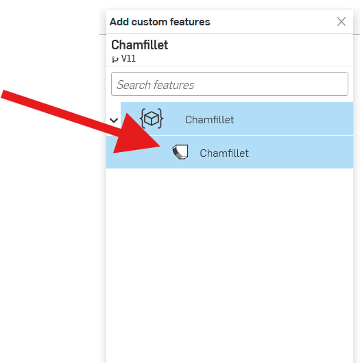

Hit that buttonat the top. After that, in the box that pops open, select the Feature Script to add (sometimes, there are more than one):

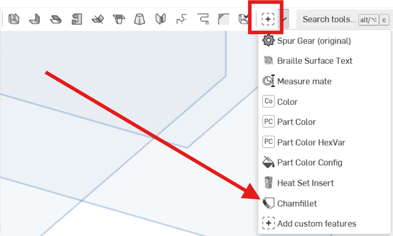

You will now find the feature script in this place, as soon as you open an Onshape document:
It will basically behave like all the tools/features in Onshape. Feature Scripts are actually a very strong point on Onshape and there's a lot of quite useful ones out there already. Have fun!

I tried the Chamfillet on a little hole test block I was printing last night. It worked nicely. No support to scrape away and none of the usual roughness that's left behind 👍
