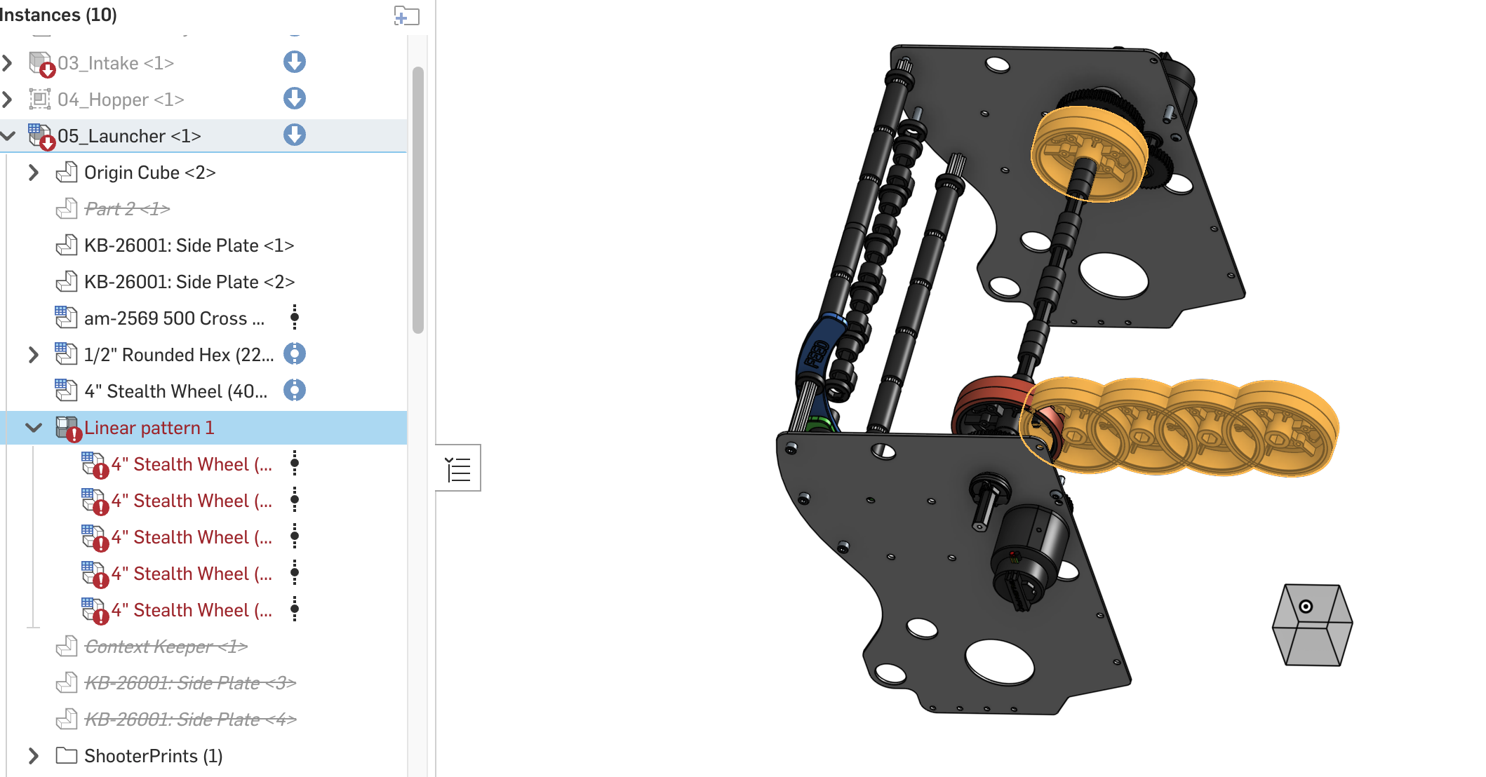

Subassembly in top level has errors, but at the subassembly there are none. How do I diagnose?
steve_cohen
steve_cohen Member Posts: 29 EDU
In the top level, I have this.
The Linear Pattern 1 is highlighted. When I hover, it says "Mate overdefines the assembly".

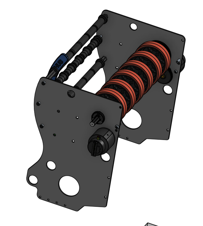

In the subassembly, all is well.
How do I troubleshoot which mate is a problem in the top level, as specified in the error message?
Here are the top level mates.
Here is a link to the model.
https://cad.onshape.com/documents/4d2d7802e286412184fc175d/w/5cdf00aaf404045a054fb394/e/97d24492f16861e38d13de72?renderMode=0&uiState=69b9c8adb6a966d0a2ec1724
Thanks!
