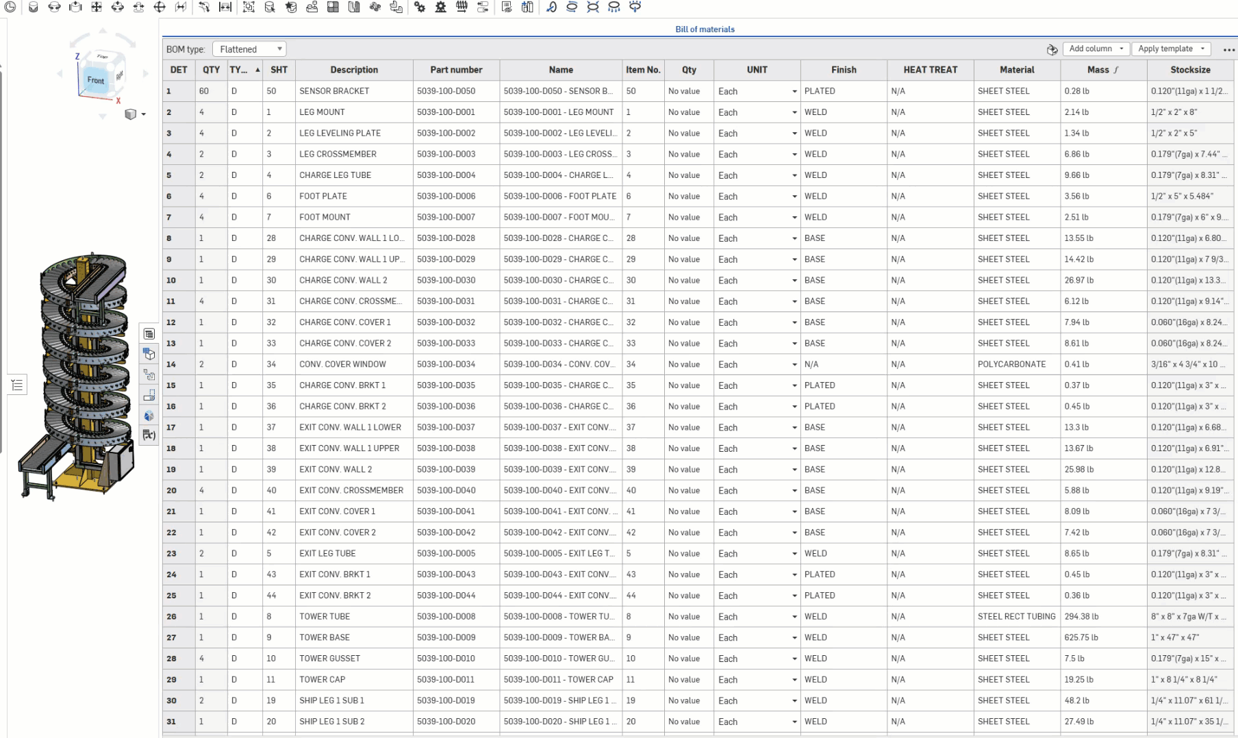

    Sheet-Metal is mostly of what we use. for example here's MDR conveyor with 56 unique manufactured parts. only 2 aren't sheetmetal. The tower tube, and the lexan window.

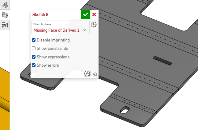

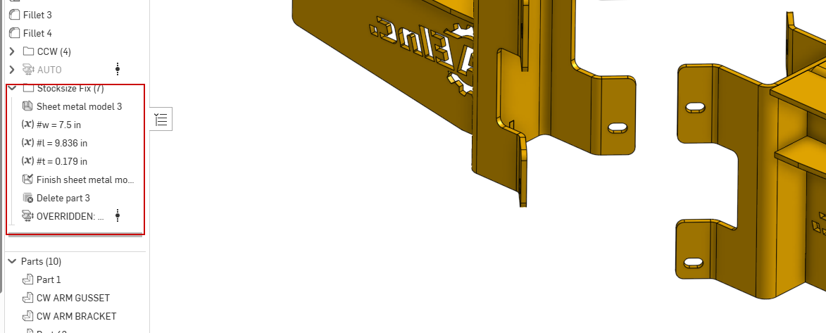

    Here is a quirk I just encountered for the first time today. I'm deriving a sheet-metal part from another part studio (it's built off adjacent geometry) I checked the box to import as active sheet-metal (which is a nice recent feature) But for some reason this one behaves.. different…
    I ended up having to add 7 steps into the tree to fix it so I could push the flat pattern stocksize into the part properties. Usually my featurescript for this does it automatically for all parts in the studio at once. but it was measuring the bounding box of the formed body instead of the flat pattern. even though my debug report was showing it went through the flat pattern sub routines.

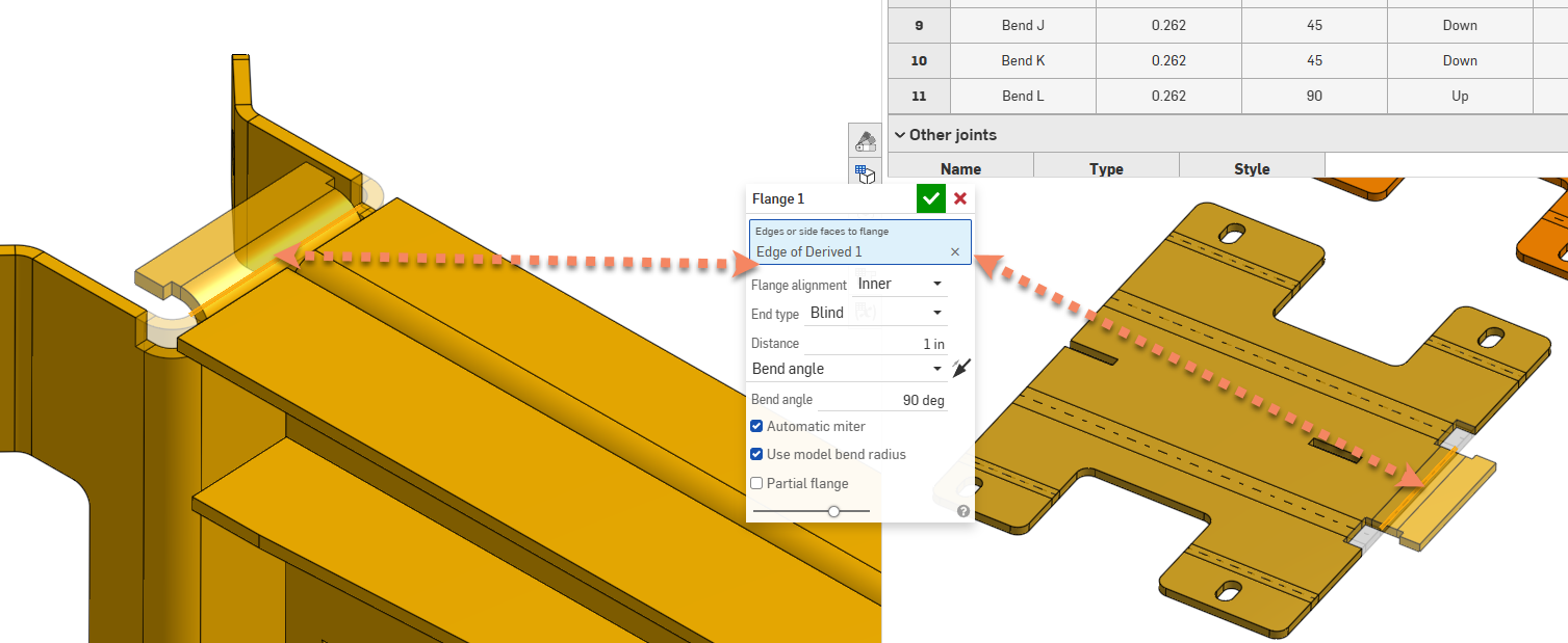

    I basically had to re-create the sheet-metal from faces, to make a clone of the part. Then did things to it. Basically, measure didn't work, I can't select faces in the flat pattern to sketch there. Just weird random stuff. (side note, when making this post, Measure now works again… hmmm)
    But I can add flanges, so it is truly active:
    I haven't created a bug report yet, but I'm wondering if anyone else seen this, or is it just a one-off glitch?

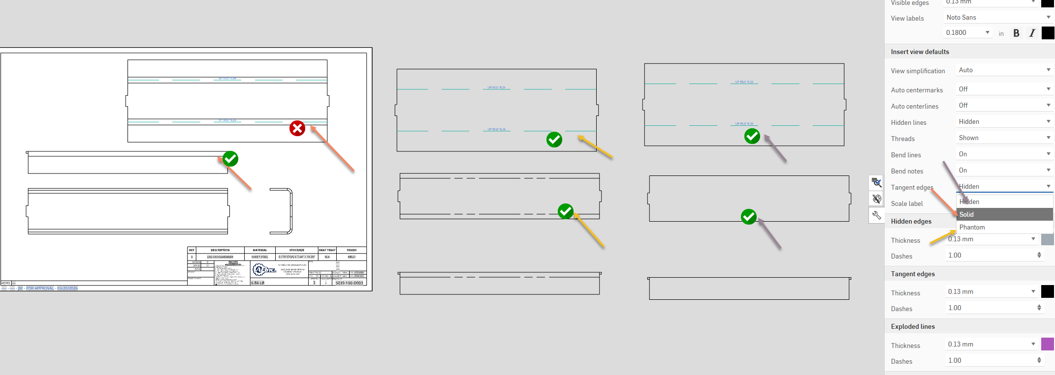

    Here is another one that started happening a few updates ago. I haven't been detailing much recently so I keep forgetting to bug report this. (I'm making a bug report for this one now)
    The tangent lines is the flat pattern are showing up if you have tangent lines to solid. So, you have to manually hide the tangent lines in the flat pattern.
    It used to always be hidden by default in the flat. the two outside the border are tangent phantom and tangent hidden options when inserting the view.
    those two still work fine and don't show tangents in the flat pattern.
