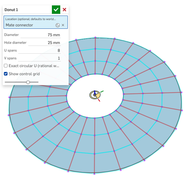

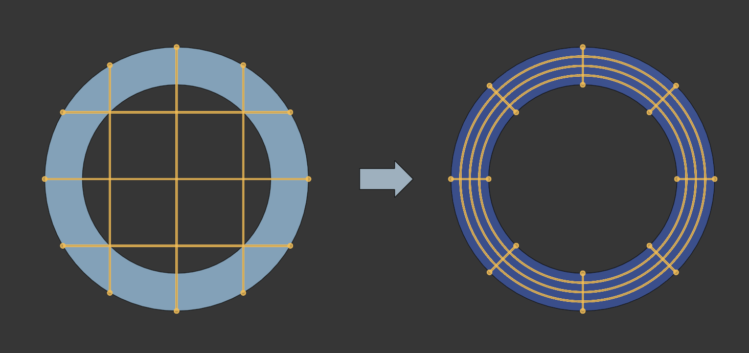

Is there a way to remap a revolved flat surface to make the coordinates polar rather orthogonal? I was trying to use Attractor Pattern on a revolved surface (not a full 360 revolve. I'm aware of the limitation) and realized that the underlying grid was perpendicular UV lines and giving me undesired results. The profile for the image on the right is a line that's tilted by 1 degree for demo purposes.

    If you revolve something at a microscopic angle from normal to the axis, it will create the surface with the desired UV structure. The minute you do something that could be flat, Parasolid will try to be helpful and make it a simple grid.

    edited June 16 Answer ✓
    I may be overthinking this… but try this ;)
    https://cad.onshape.com/documents/b4a6390ff08540b94b378e64/w/ae411fd2ec988dc3efd3f8a2/e/16153c47ea2e417695cdef36

    You'd need to replace the plane with a planar NURBS surface, I can't think of a way except for that…

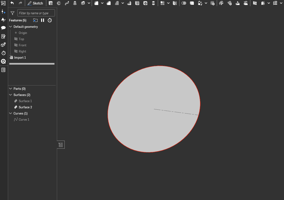

    So it's just the Parasolid kernel doing its thing? Rhino was pretty explicit about the surface, but @ilya_baran you mentioning NURBS makes sense.
    I just tried importing a Rhino file into my part studio and while the surface did import with a seam, the grid is still orthogonal. Overall, this isn't a big deal to me, but just a quirk I found in the software. I'm sure there are workarounds for this that don't involve UV.

    But this does do what I asked for. It's really mainly for things like attractor pattern where the UV layout matters. I also saw you made it in 6 minutes. Was this done using an LLM? If so, that's really impressive. Also impressive if you figured all that out in 6 minutes as well.

    Ha! Yes, I appeared to do this quickly as it was copied over from a different doc that I had been working on. And yes it was part of some MCP testing… I also happen to have a couple thousand lines of NURBs helper functions from those MCP tests and could pull some hints from that, which bootstrapped things nicely.
