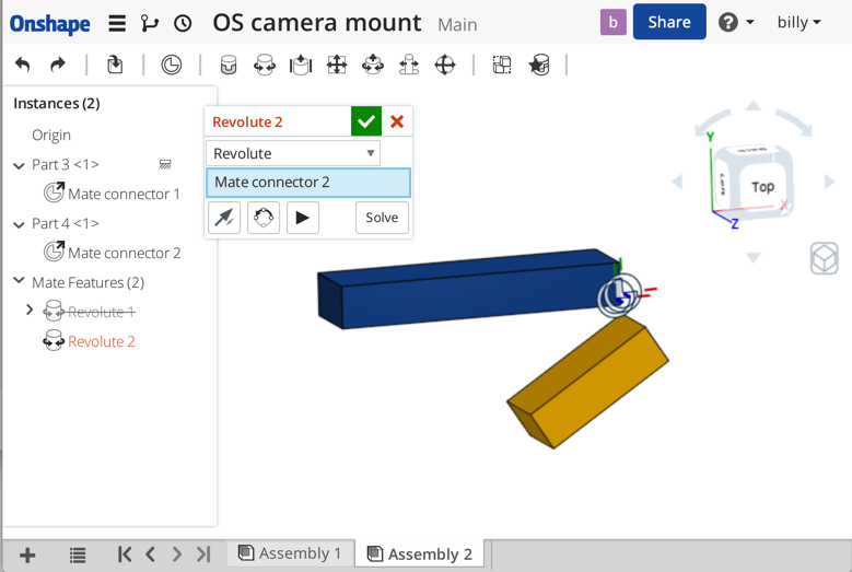

    Ok, so I think I constructed what you guys are talking about.
    The Problem

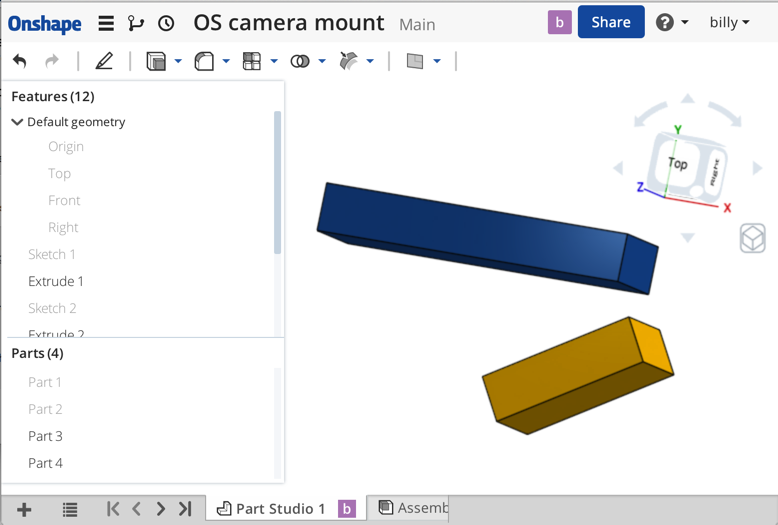

    Part studio with 2 blocks:

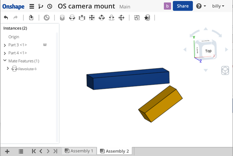

    Assembly with rotate mate connector:

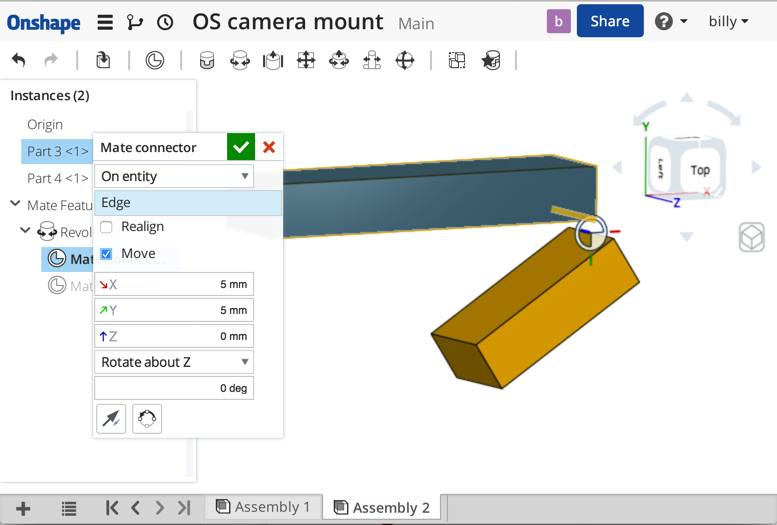

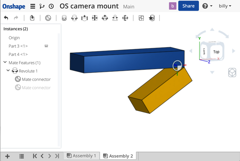

    I believe this is new (edit & add move offsets):
    You can edit both mate connectors and create a hanging mate connector in space (I really like this):
    ***Now whats important is that I haven't created a separate mate connector. But as a designer, I not sure this is what I want.

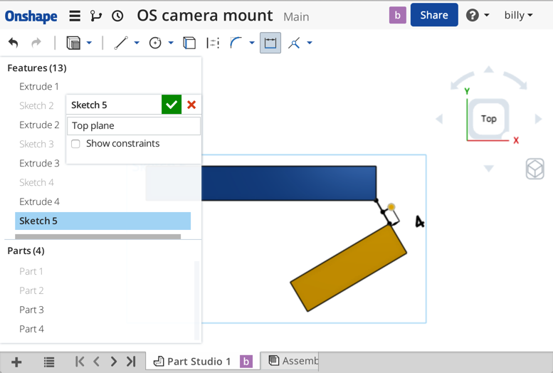

    As a designer I want to control the hinge point graphically to make it easier for others to understand what I'm doing. Back in the part studio and create a sketch showing the hinge location:
    To pass this location to the assembly I want to access this sketch in the assembly but can't:

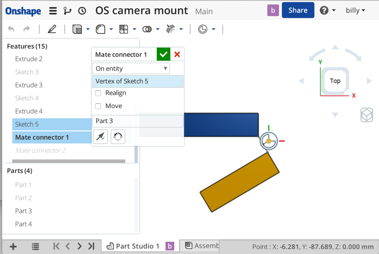

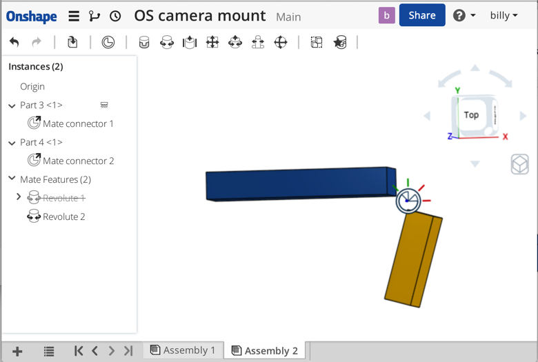

    So I'm forced to create 2 mate connectors in the part studio for each component:

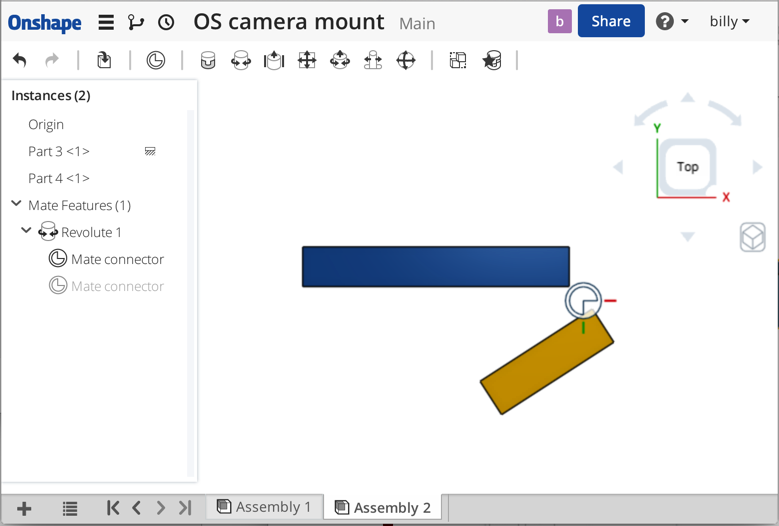

    Now I can assembly my controlled hinge point in an assembly to see it move:
    I can now move my 2 components with a graphical controlled hinge point using a part studio & assembly:
    I think to Traveler's point, is this for real? 2 hinged blocks and it's this complex.
