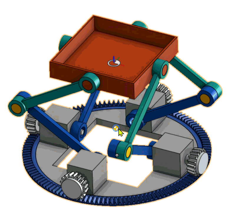

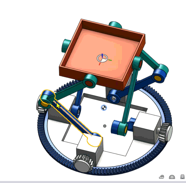

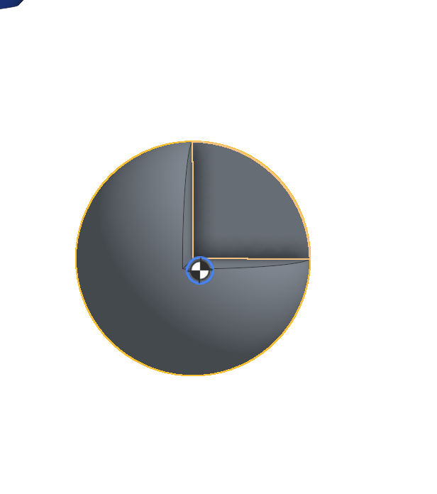

PERSISTENT CENTER OF MASS INDICATOR IN ASSEMBLIES
You can now keep a center of mass indicator visible in Assemblies without the mass properties dialog open. Right-click an instance or the top-level Assembly in the Instance list to show its center of mass, and watch the indicator update as you drag parts and change the design. Show indicators for several instances at once, and hide them from the same menu or by right-clicking the indicator itself.
https://onshape.wistia.com/medias/rnhss9r1wo/embedType=web_component&seo=false&videoWidth=960

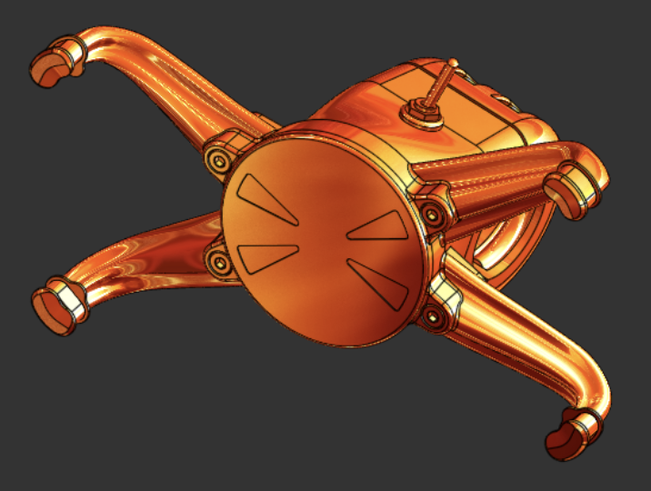

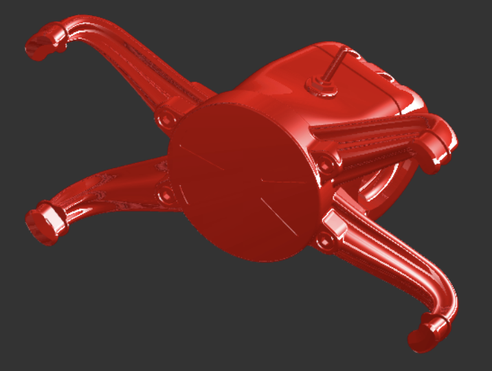

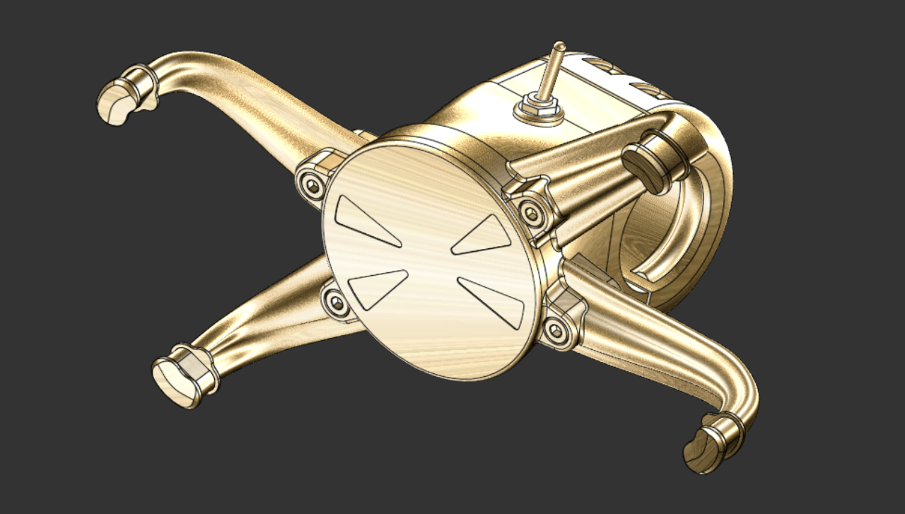

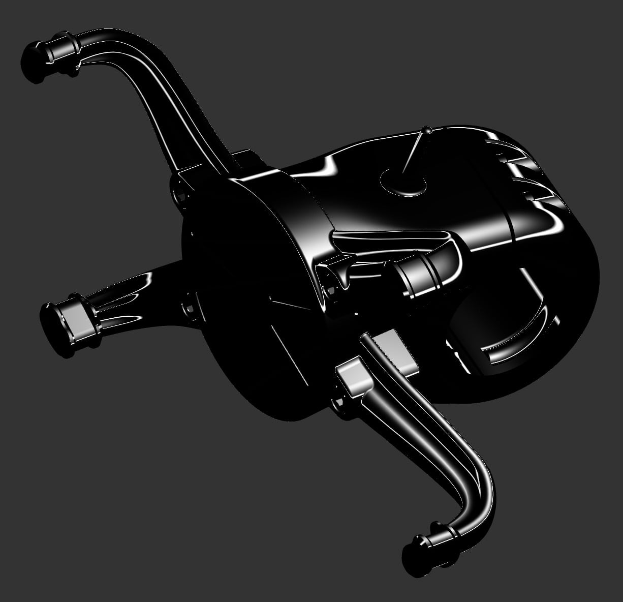

  • billy2
    edited October 12

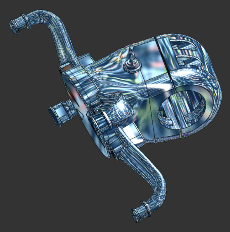

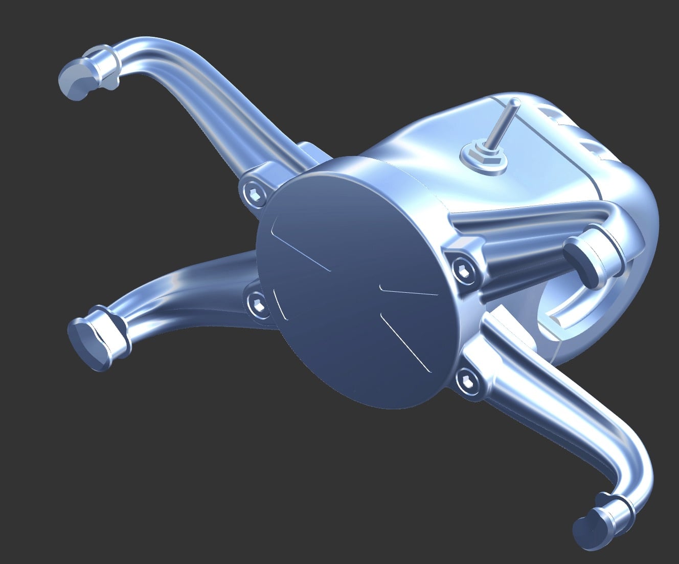

    Oh yeah baby!. Could we make it so different parts have different analysis? Now I can have brushed nickel, brass, fly cut aluminum. This could be really cool.
    Gloss enamel black:
    Come on, throw me a bone. Map these to individual parts and let me live a little.
    candy apple red
    burnt orange crate
    brass attack
    boring aluminum
    oh derek
    I'd be happy to name the new color palette for you
