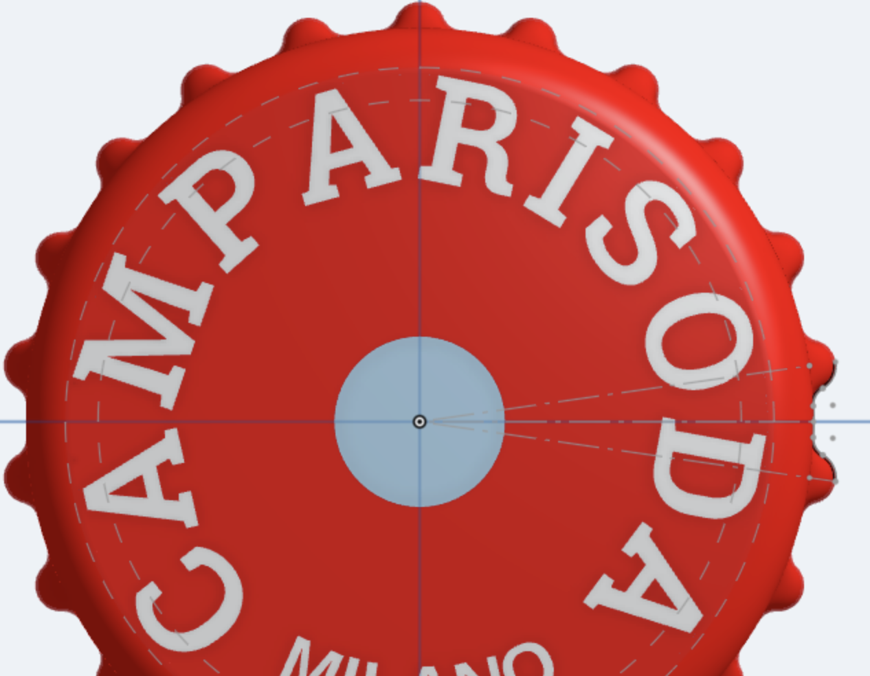

  • nic_r
    nic_r Member Posts: 9 ✭
    Hi Dave,
    thanks so much for this feature-tool, made really fun and saved me a lot of time. I only have a issue with a curved text with the letter "P". It ist slightly tilt and then it looks like a bigger gap to the other letters (sorry for beeing sooo picky here ;) ). Looks like that the mid-point for this letter is different and therefore doesn´t look like correct on a arc. On some fonts it´s not visible much, but on the "Roboto Slab bold" it does for me.
    Saw also here in the comments the picture with the sign from kevin_mason558 "CANS ONLY", the space between L and Y is bigger then to the other letters. Is it dificult to fix?
    Could you maybe adapt this in a future version please?
    Thanks in advanced
    Cheers Nic
  • dave_cowden
    dave_cowden Member, Developers Posts: 484 ✭✭✭
    Hi @nic_r
    Unfortunately I can't address how certain letters look— i'm limited to what the Onshape font produce. When text is built, under the hood each letter is created separately using sketch.
    Spacing, however, is definitely fixable with the current version. Have a look at the kerning parameters— this allows you to tweak the spacing between every character individually (you must provide a kerning value between each letter, as a comma -separated list). This is very common in the typesetting space— lots of fonts commonly need tweaks between particular letter combinations to look nice.

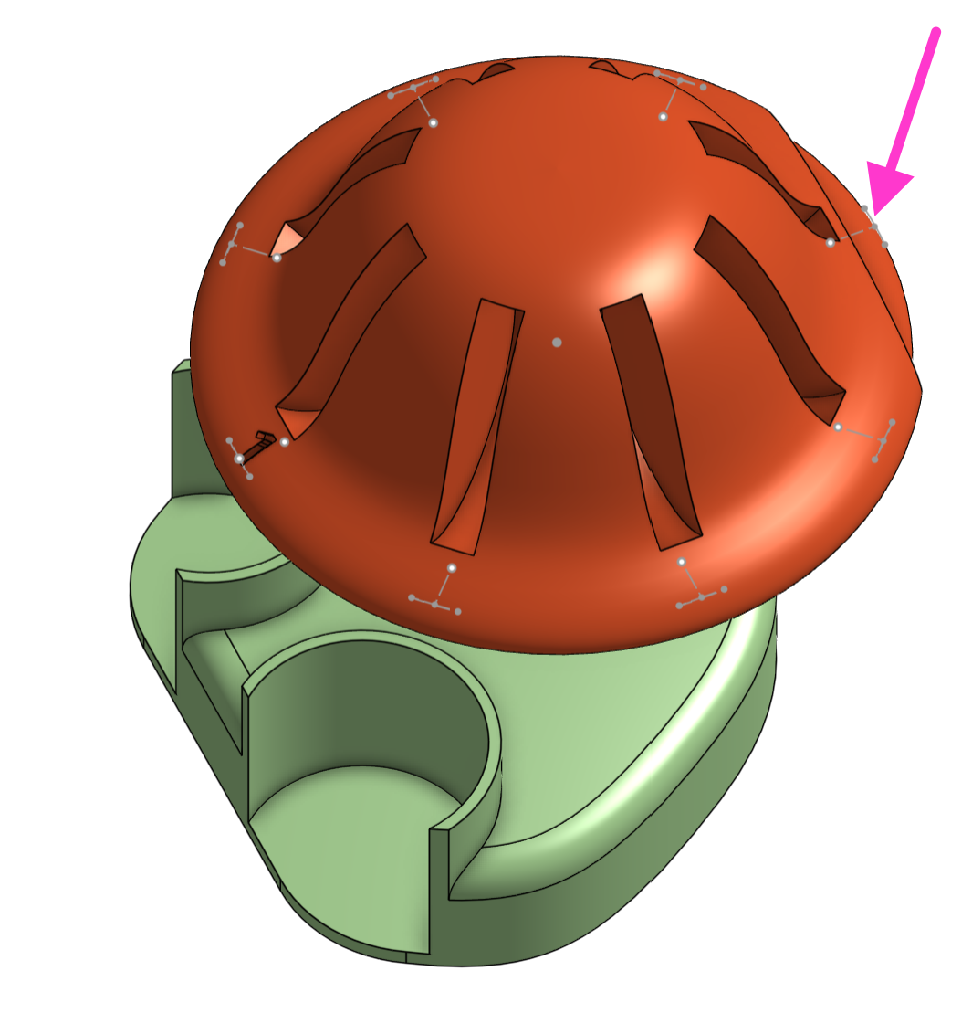

    Thanks @dave_cowden for a wonderful script! Just thought I'd let you know that I'm having an issue where the script appears to be removing a part of my object when I use it
    Link to project here: https://cad.onshape.com/documents/1a6889a61ec254aa9c55a761/v/315e95712de11b57f9f10917/e/61786b6acb7bc2f9d2dfd0f0?showReturnToWorkspaceLink=true
    Also, Edward's suggestion above re having a 4th option where we could have a cutout and fill would be really handy for 3D printing where you can assign a different colour to the produced text. At the moment I'm using the thicken tool but it's not very elegant and sometimes it doesn't work well.
