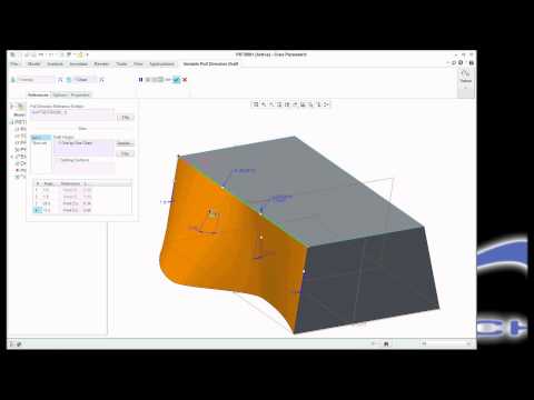

    Hi Onshape, I am designing a part for injection moulding and could really need a variable draft. Now that you are aquired by PTC, have a look at this: https://www.youtube.com/watch?v=Wk79QoN5-Fs
  • NeilCookeNeilCooke Moderator, Onshape Employees Posts: 5,979 image
    Hi @PeterM - I checked our improvement request database and I can't find an entry for variable draft, so please create a support ticket with your request. Realistically, since there is no entry then it is not on our radar and therefore will take a significant amount of time before it is implemented. I am not sure if Parasolid even has this capability, making it 10x more difficult. Just trying to set expectations.
    In my experience, variable draft is mainly used on forgings where the top and bottom surfaces of the part are important and the draft faces are not as long as they meet at a mutual split line. This can be achieved using parting line draft on one side and loft on the other. If you have an example I can show you how.
