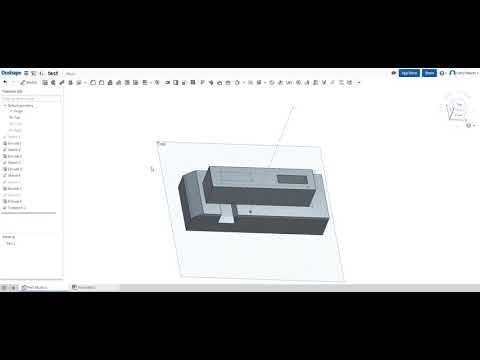

I created an assembly and noticed a part was oriented incorrectly. I rotated the part 180 to its proper orientation but when I went to edit the sketch to make small adjustments I noticed the sketch had remained in its original (now incorrect, off by 180) orientation. Must be simple but how can I rotate both the part and the sketch? Or just the sketch and have the extrusion follow?

    Hi @larry_hawes, great way to post a question, and welcome to the forum BTW.  One thing we always suggest is that if your doc isn't confidential post a link to it and we can actually demo our suggestions to you.
    What you're seeing is normal, and as ever with CAD there are may different ways to approach this.  Please excuse me if I'm telling you things you already know.
    (1) OS works down the feature list each time you open the doc or rebuild any feature, it's "just" a list of commands run in order.  So as you've seen the order matters to a degree.  Have you used the "roll back bar" yet?  If you go back and edit the sketch you'll see this happens before the rotate.  As such there is no need to rotate the sketch as well.
    (2) You can as you point out if you rotate the entities in the sketch and then you don't need to rotate the part.  There is a "sketch transform" tool with a manipulator triad that will allow you to move and / or rotate stuff.  (Note you can drag the circle at the origin of the rotate triad to define where you want to rotate things about.) Details in the help here:-

    THANK YOU OWEN, Lots to digest for a new user but will explore and see if I understand the concepts. LOVE the idea of modeling multiple parts in one part studio but don't quite understand that dynamic yet. Seems like it would solve a lot of problem with multiple parts in multiple studios and fitting them perfectly in an assembly later. LOTS to learn and your help is greatly appreciated.
    I hope the video below describes the problem and I am sure there are reason to not have to perform the operation as described but if one were to try and rotate a part and all of its sketches how would/could that be accomplished?
    Thank you in advance
    http://www.youtube.com/watch?v=jWnpalVQmnI
    https://cad.onshape.com/documents/49abe483f26a82ce4b0871b4/w/0b69226a007ac223581cae8a/e/c827dc9d796392ef5a0323c5
  • NeilCookeNeilCooke Moderator, Onshape Employees Posts: 5,938 image
    Hi @larry_hawes as Owen says the transform tool cannot move sketches (or any other features before it). It is only used to move solid bodies. When you edit the sketch it reverts back to the time when it was created.
    Don't confuse a part Studio with an assembly. Onshape does not care in which orientation a part is modelled because you can fix it in an assembly.

    Owen, Neil,
    I think I finally understand the paradigm and was able to simply rotate the part in the assembly using the Triad Manipulator. Not sure why I missed that so many times but sometimes I'm not the sharpest tool in the shed.
    Many, many  thanks for your help.
