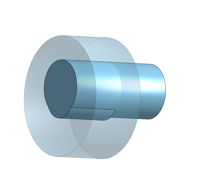

    WOW very cool tool, Thank you so much!! Did notice that the input shaft has the central piece pointing out too much so that it doesn't fit into the bearing..
