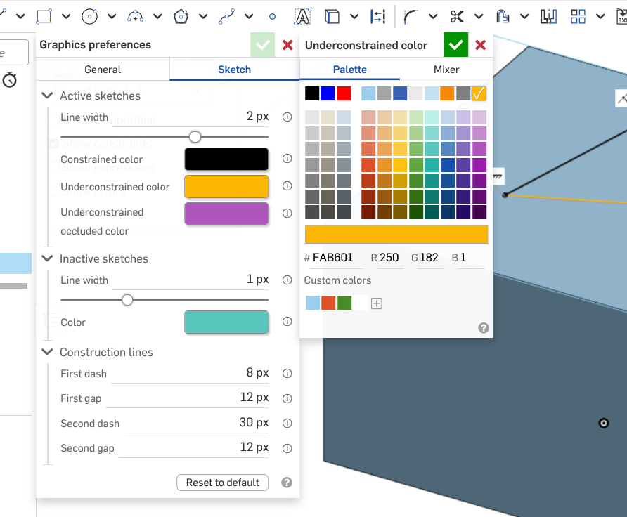

    You can choose your own 'underconstrained' color now (recent enhancement) . . .
