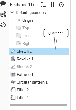

  • chris_notforpublication
    chris_notforpublication Member Posts: 9 ✭
    I came here looking for some annotation for parts drawing @EvanReese said that it is not obvious that a sketch is annotated unless that annotations bar is open.
    However when the annotations bar is open an icon appears next to the sketch. but it disappears as soon as the annotations bar is closed
    Why not just leave that icon visible whenever an annotation is present?
