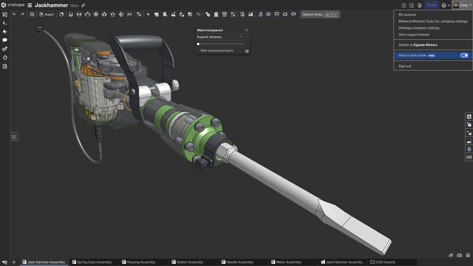

    so i guess i figured it out. i might has something to do with this beta darkmode or dark mode extension. always happened when i had it on , didnt happen when it was off so far ..
    btw i notices some weird bugs in darkmode or in normal mode with darkreader extension aktivated the hole ui , parts almost everything bugs out & it is gray in gray in gray or after a refresh blue in blue in gray , so that you cant see anything. and this happens btw almost always after a few clicks….: solution dark(mode or extens.) off - refresh mode back on everything looks right again few clicks later same procedure again.
  • NeilCookeNeilCooke Moderator, Onshape Employees Posts: 5,973 image
    Shouldn't need any extensions anymore so make sure they are disabled/removed. I would be surprised if it was our dark mode since it is just CSS.
  • aeppikxaeppikx Member Posts: 6
    yea for now i use onshape in eyehurting white and keep my darkreader and darkmode off. 😁

    I'm following up to say that I was also using Dark Reader with OnShape, and I haven't experienced any more crashes since I disabled it. I removed a bunch of other less-critical extensions altogether at the same time so I wasn't initially sure, but aeppikx's diagnosis seems to match my experience.
    I hadn't noticed that OnShape added Dark Mode. I'm very happy to learn about this and not need Dark Reader anymore.
