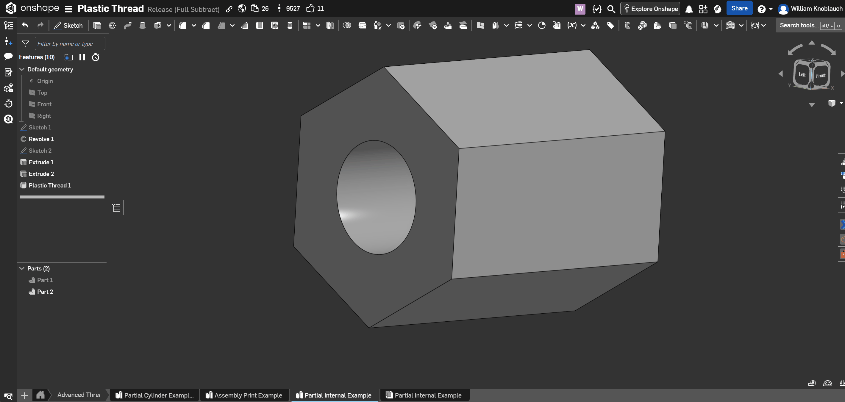

  • william_knoblauchwilliam_knoblauch Member Posts: 19 ✭✭
    @shameek_vats,
    Your comment actually got me to add the partial internal thread functionality to this featurescript finally. My initial idea was that people wouldn't need a partial internal thread, but after several requests, I realized it's not about implementing what I think people want; it's about giving everyone options.
    New version: Plastic Thread V1.6
    So I've implemented partial internal threads and, in the process, cleaned up the partial threads functionality.
    You can update the featurescript in the toolbar by right-clicking on it and clicking update.
    If you encounter any bugs with the code, please let me know. You can also partially thread double-headed bolts. I don't know why you would really want to do that, but now you can.
    Oh, and I made it a little more lenient when selecting a cylinder that isn't exactly equal to the theoretical cylinder size. It should now accept cylinders that are slightly smaller or larger when uneven chamfers cover the edges of the cylinder. You still can't add threads to a hole through a rod, mainly because the chamfer doesn't look good.
