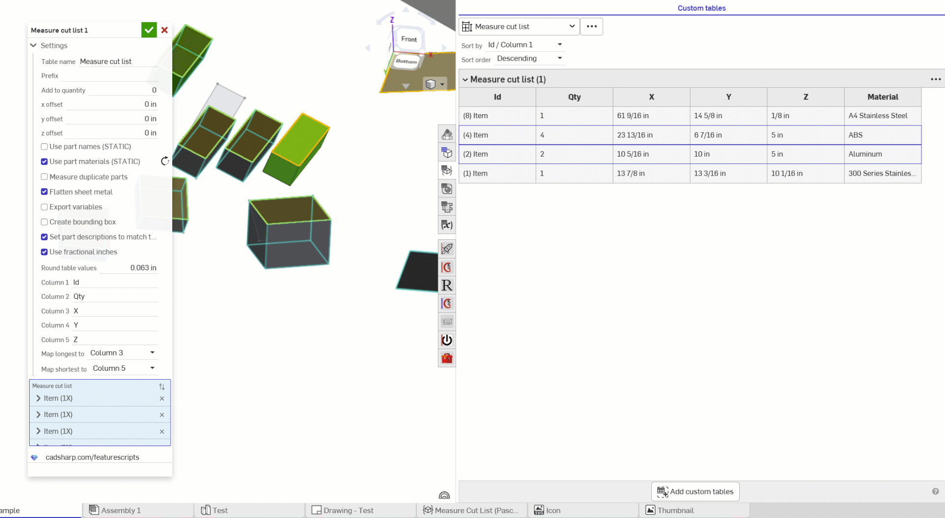

    Use the custom feature "Stock Size" in your Parts Studio. Insert the parts into an assembly and you will find the part dimensions in the Title 1 column of the BOM. Your box has only three unique parts- a better workflow would be to insert multiple instances of the parts as needed and mate them correctly in the assembly. https://cad.onshape.com/documents/3593aa8fd07a18d2106641a6/w/d5fa0b0cf83c1cd6f75c0f93/e/41cfb6a794413cc7f42bf1c6

    @chadstoltzfus  Cutlist+ is for frames. Measure Cut List is for generic use with things like cabinets. I should probably merge them into one feature. Measure Cut List will also name the parts so that you can have them show up in the bom list with sizes, or you can keep them in the part studio and use the custom table it produces to view the cut list.
