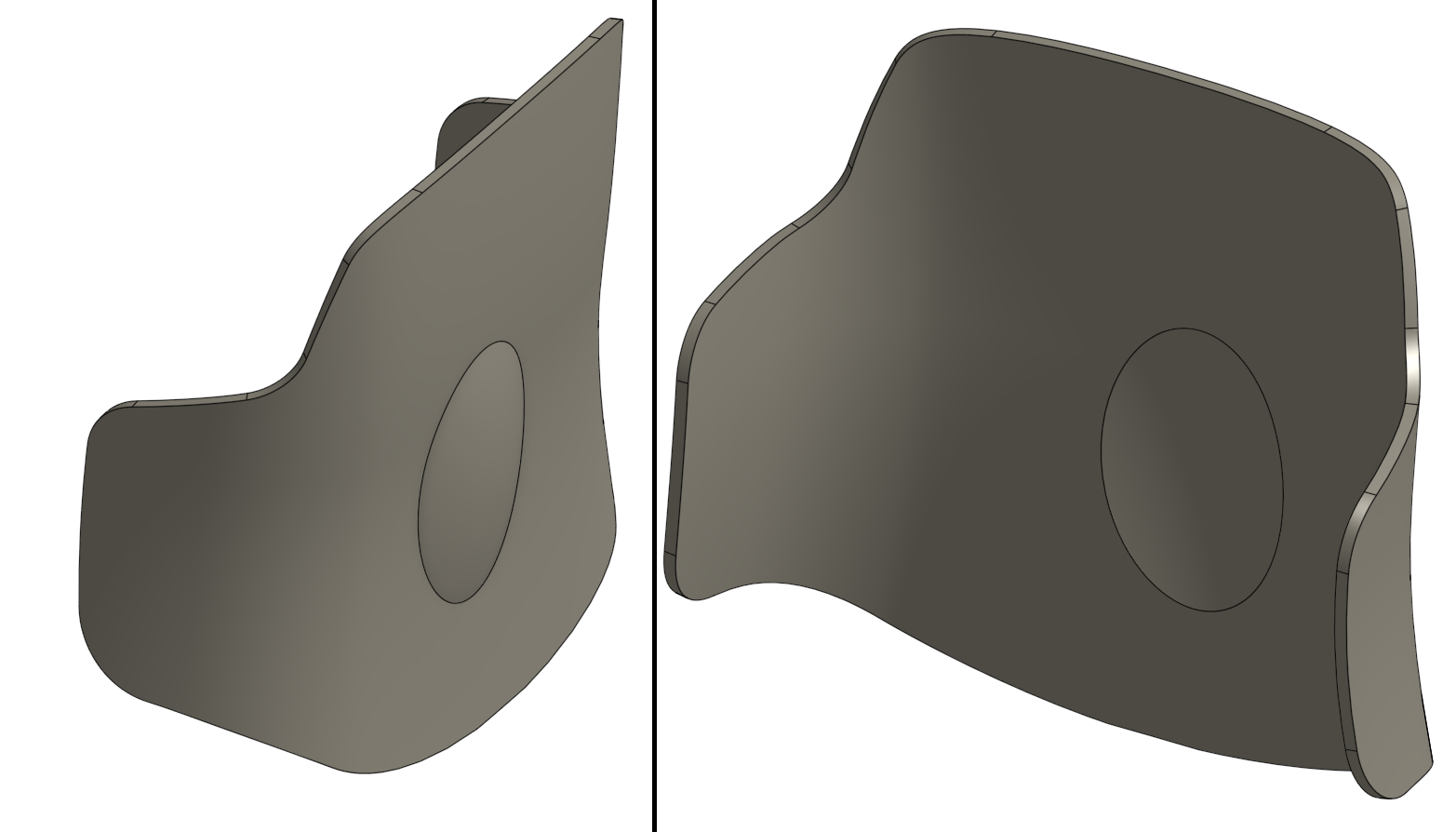

The model I'm working with right now is not mine to share, but it is essentially one highly configurable thickened surface model of a chair back. The model pretty seamlessly accommodated a huge variety of widths, heights, and other variables. Some applications require a divot in the chair back (shown below). I'd like to use configurable min/max limits on the placement and size of the divot to prevent it from being placed outside the bounds of whatever the chair back's width/height happens to be configured to right then.

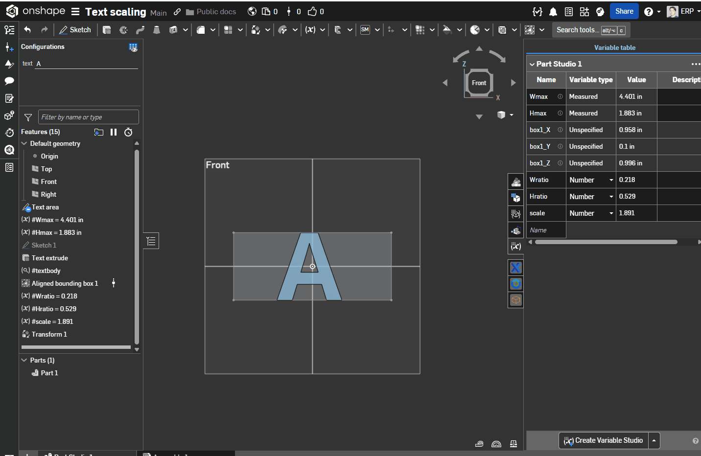

Here's a video I released recently that covers a workaround. Should have another one up today that expands on it.
Here's one with a better approach. I'd still like to have configurable min/max on configuration variables though
