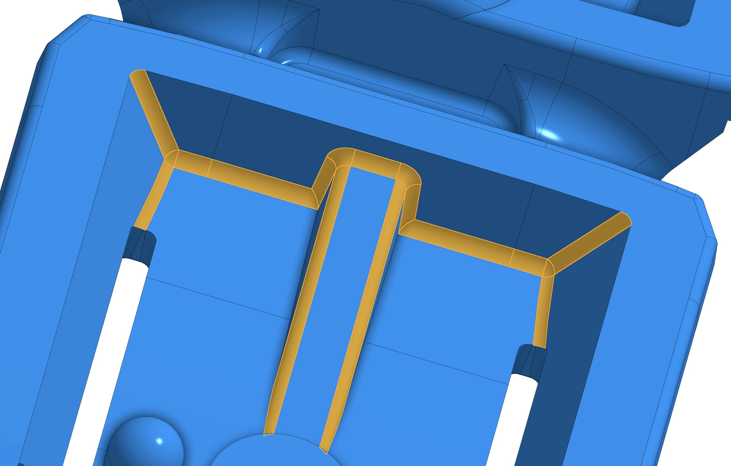

    Basically, for the moment I'm comparing when Delete Face and Replace Face would succeed or not…
    Now playing around deleting these:
    https://cad.onshape.com/documents/d8e7dcd265542207d898ceba/w/e3cf115734a2f294d26b0477/e/d483de1fa76feb87c667729f
    NX would delete them in 1 go.

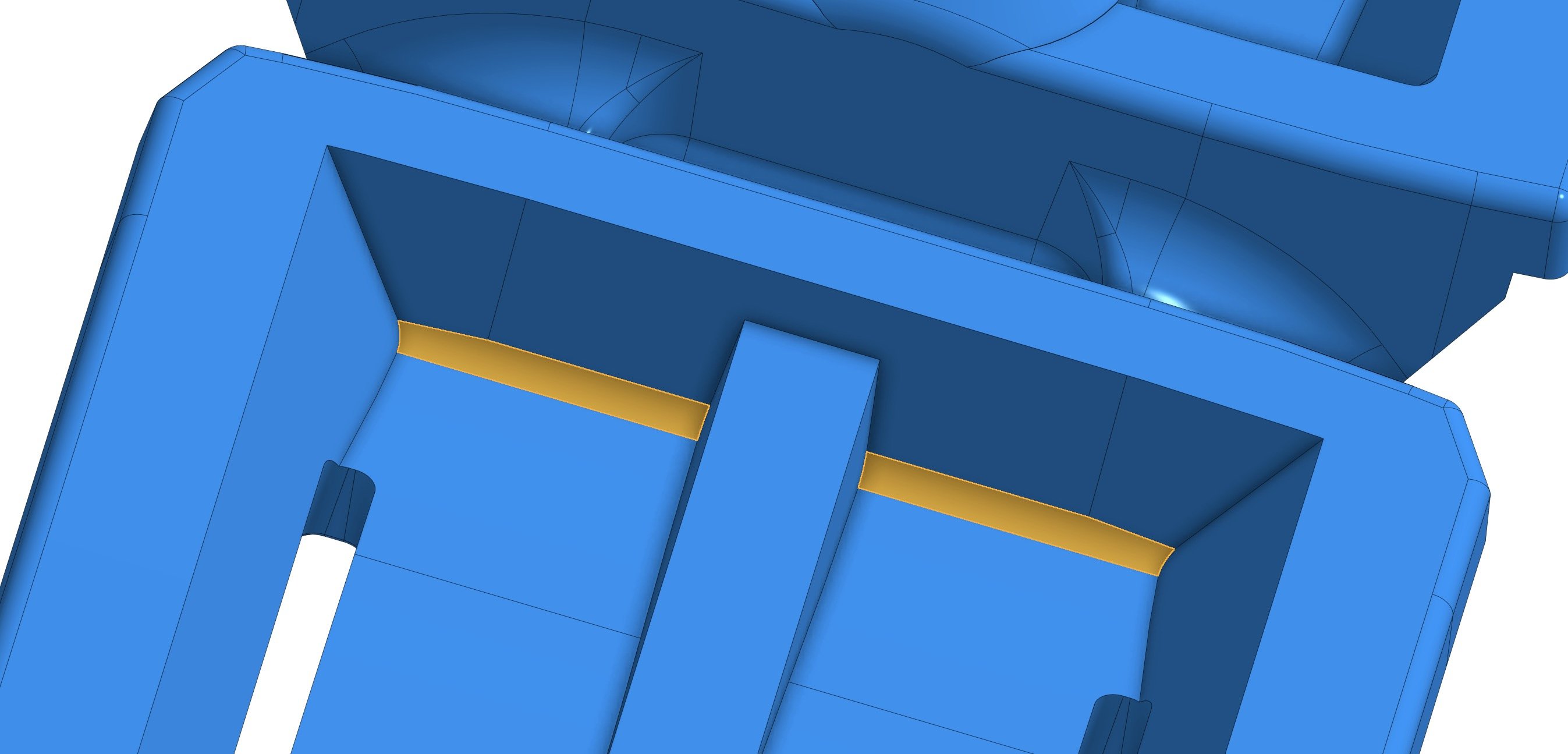

    In Onshape, I'm needing to do it in several instances. Not a problem per se..
    But these I just can't
    Since both are based on the Parasolid kernel, I would think they would be equally powerful in handling the "underlying math"
    Could this be tied to some sort of Modeling Tolerance Preference? (NX has Distance and Angle and I have mine set to 0.001mm and 0.5 deg
    Could Onshape be using a bigger or smaller tolerance?
  • S1monS1mon Member Posts: 3,739 PRO
    With delete face issues like this, I might try the unintuitive order, and see if you can delete/heal the problem ones first. Also be somewhat careful with the "delete fillet faces" option. Usually the default being On is a good things, but occasionally it can behave badly. I don't know if there's a similar option in NX, but it's definitely different than the equivalent Parasolid based tool in Solidworks.
    As far as I know the distance tolerance is on the order of 0.001mm, but I don't know about the angle. There's no user way to adjust these tolerances.

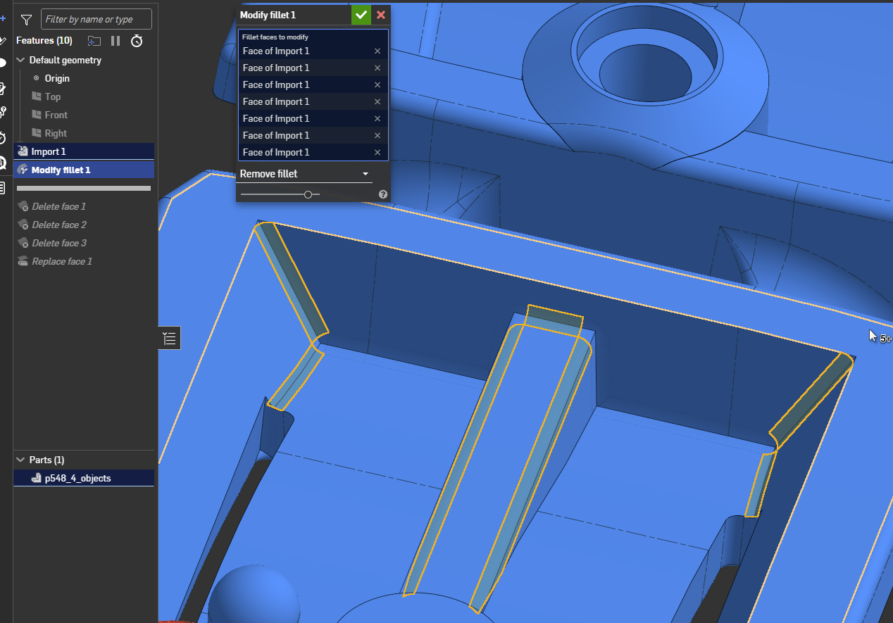

  • eric_pestyeric_pesty Member, pcbaevp Posts: 2,467 PRO
    If you use the "Modify fillet" feature you can delete all of these in one go (or change the radius…).
    I think that tool does things a bit differently from the "delete face" specifically geared towards managing fillets.
    @eric_pesty I always forget about this trick. Thanks.
