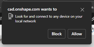

Hi all,
Logged into Onshape this evening and got this popup in Edge?
Anyone know what it's about? A little worrying to grant these permissions.
  • NeilCookeNeilCooke Moderator, Onshape Employees Posts: 5,925 image
    This was a recent update to Chromium based browsers (Chrome, Edge, etc.) and has nothing to do with Onshape. I'm not sure exactly what it is for, but if you block, certain things don't work. Somebody more knowledgable may have a better answer, but to be sure, it is not coming from us.
  • S1monS1mon Member Posts: 3,748 PRO
    For Chrome, I could see it being necessary to find Bluetooth 3DConnexion Spacemice.
  • chadstoltzfuschadstoltzfus Member, Developers, csevp Posts: 168 PRO
    This was something that affected some of our extensions with Chrome v142. There's some more in depth information here: https://developer.chrome.com/blog/local-network-access.
