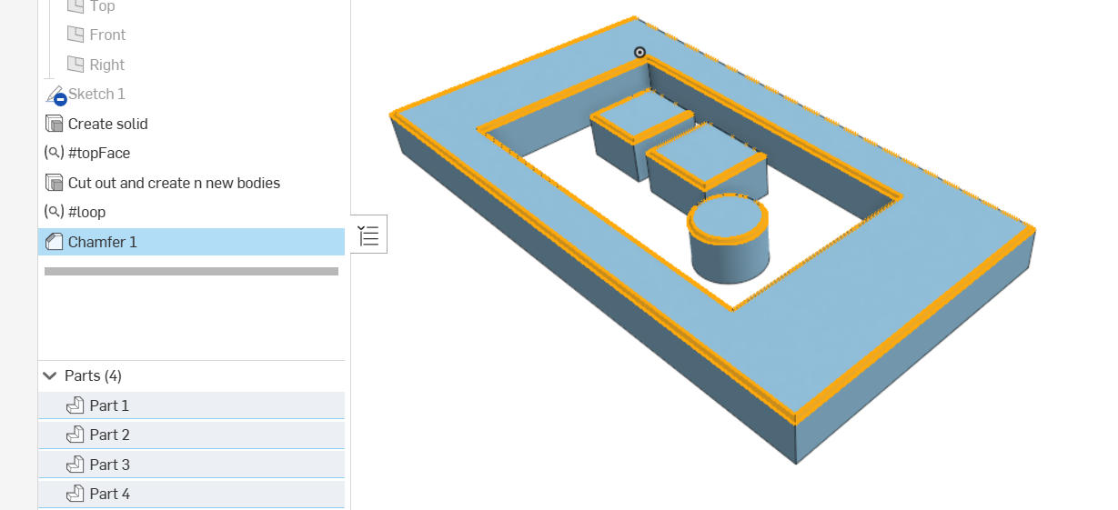

I have a situation where there could be an abritrary number of bodies - and I'd like to use Query Variables to help me apply, say, a chamfer to all of the edges on the top face of all bodies like this (Example 1 tab):

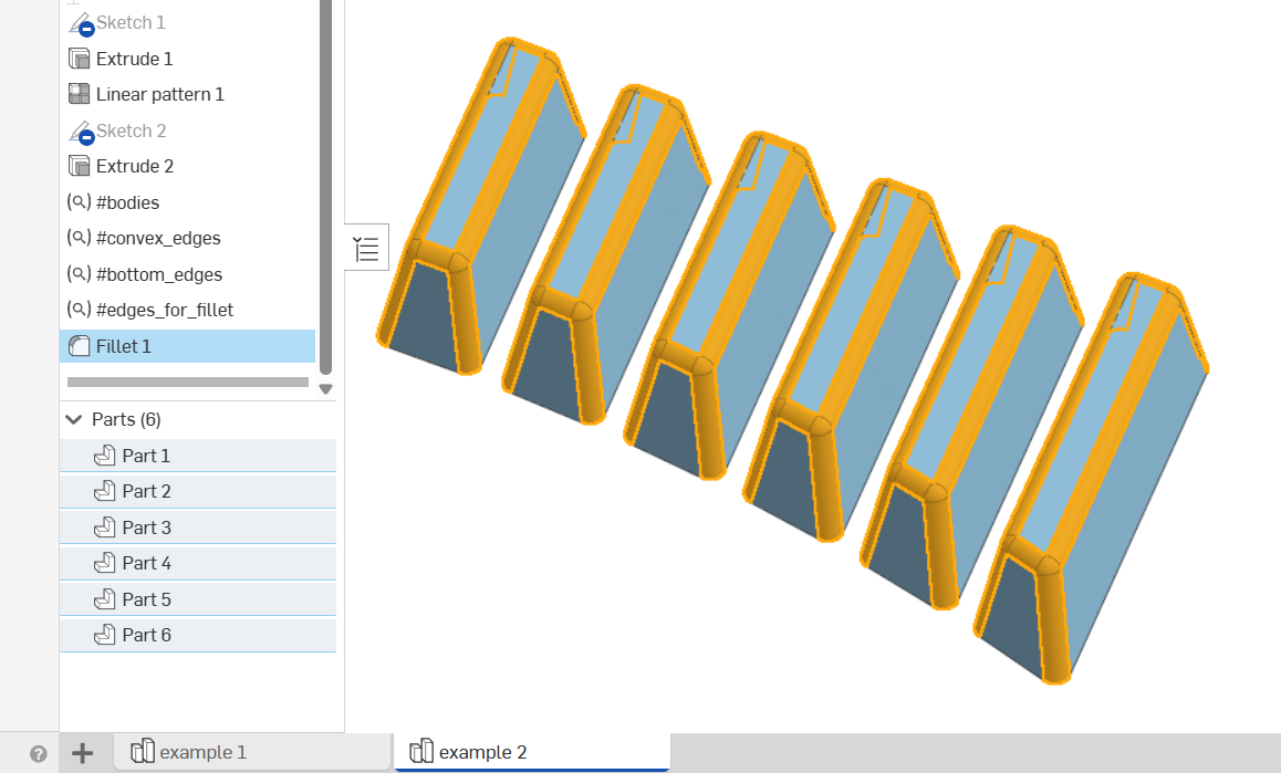

Or, apply fillets to all faces of an arbitrary number of bodies EXCEPT one face, like this (example 2 tab):

Does anyone have any suggestions / tricks? I find that I can't propagate a selection across bodies the way I'd like (for instance, the "#bottom_edges" QV in example 2 just selects all the bottom faces - which I don't want to do).

    Yeah these kinds of scenarios are part of the reason I jumped into developing QV+ because there are gonna be situations where stock QV just can't simulate an adjacency check with the available queries. Even just selecting the "top" faces of parts is something I don't think can be strictly defined by stock QV because it came with no directional checks.
    Yep - that's the problem I'm finding. I sure like your QV+ though!

    "loop chain connected" can sometimes be used instead of "adjacent" to exclude entities belonging to a face but I agree the stock QV is missing a few things…

    QV+ is just invaluable in cases like these. also qCapEntities or qNonCapEntities would work very well for these examples.
