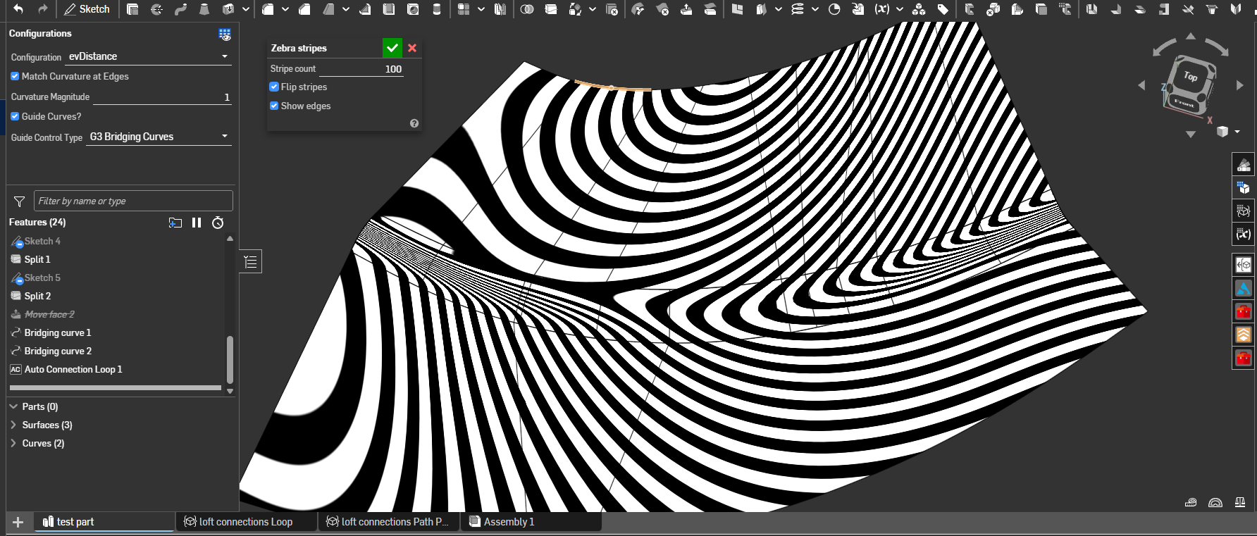

  • S1monS1mon Member Posts: 3,914 PRO
    edited December 2025
    It's hard to tell. I would want to see this with high quality turned on. The zig-zags in the zebras seem to be artifacts of the tessellation, not necessarily true results. I'd also want to look at the curvature color maps, and curvature analysis - combs, CVs, and knots.
    Just looking at the connection curves, I would pick EV distance - they seem more normal to the flow and with less wiggle.

  • Derek_Van_Allen_BDDerek_Van_Allen_BD Member Posts: 630 PRO
    Here's a demo that turns all the options into configuration variables to play around with. It looks like path parameterized gives slightly better curvature continuity but with a lower performance. I'd also expect that it would handle corners worse than the evDistance method but that's largely a guess. I made it an option to turn on or off curvature matching at each edge and it looks like it's smoother with it on.
    With this particular set of inputs, I find that evDistance, Match curvature: off, curvature: 2, and guide curves: off produces the cleanest results. In theory, turning match curvature on would be a good thing, but Loft just adds a lot of extra CVs/knots to the edges and makes things more wobbly than necessary.

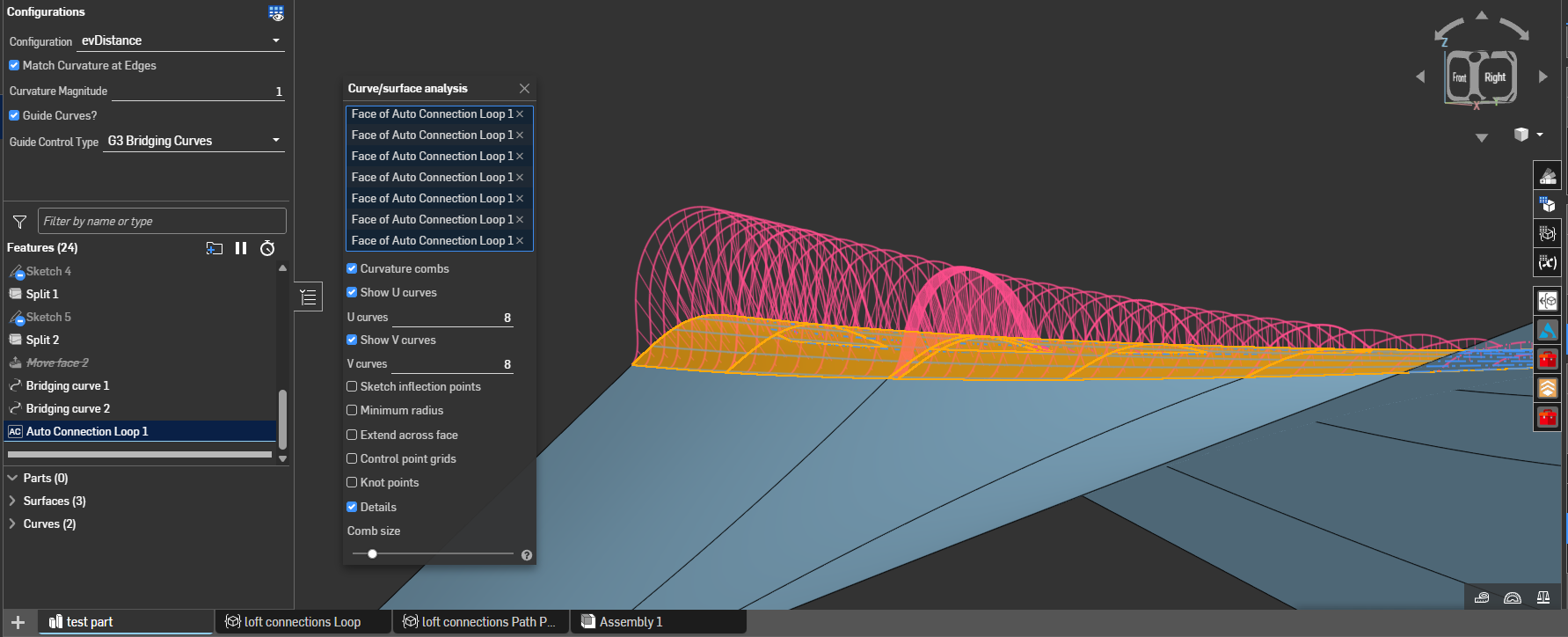

    I think these are qualitatively the best results I've been able to come up with. The biggest single difference maker is changing the outer guide curves to G3 flow instead of tangent. With these settings evDistance vs path parameterization doesn't seem to be meaningfully different to my eye so I'm willing to call the distance method superior for performance and cleaner lines. For this particular example anyway.
    The combs look nice too
    Should the bridge curvature generation be wrapped into the code? Probably another time. I got what I was looking for out of this exploration.
    Edit: actually my blue combs are very slightly marginally smoother on path parameterization mode. Wiggly connections aside, the surface quality is ever so slightly better with the path method.

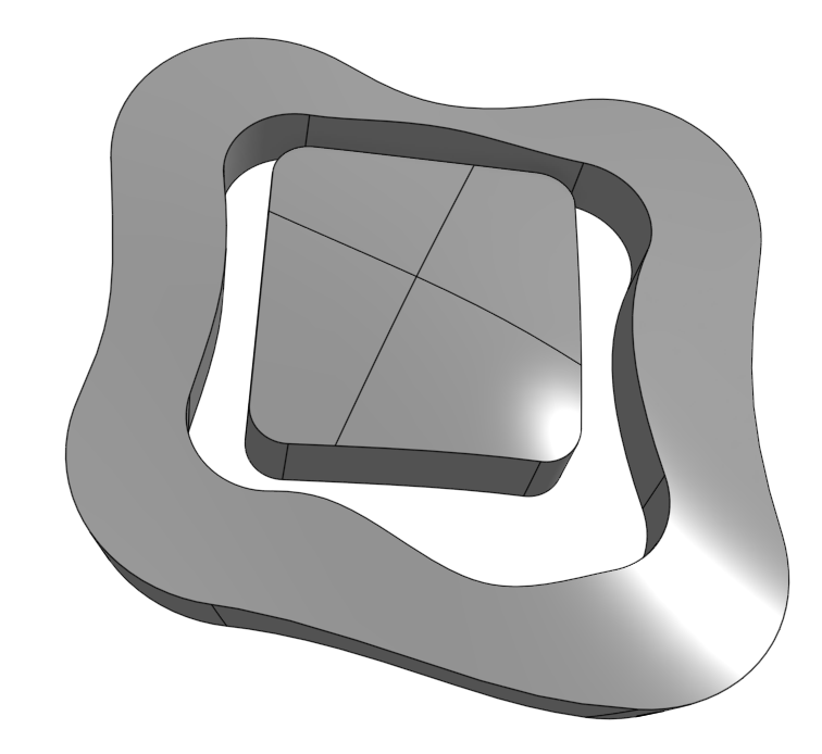

  • jelte_steur_infojelte_steur_info Member Posts: 638 PRO
    @ry_gb & @Derek_Van_Allen_BD : Auto Loft Connection is definitely worth publishing separately. I have use cases in mind.
    One of the use cases (can't share it: confidential client work) would have a few straight sections and a few bends in it. I'm not sure the normalized length solution would work well in those cases. an individual evDistance for each case would yield better results i imagine.
    Imagine a square with rounded corners and an offset version of that. the rounded corners with evDistance method would result in lofts for rounded corners and straight pieces, but I think the normalized lengths wouldn't work that well…
    Imagine something like this: I drew this up just for testing.
    I imagine a separate Auto_loft_connection would just split edges to make the nr of edge segments match.
    (and perhaps set queryVariables for edges so one could do a manual loft/boundary curves afterwards?
    The only focus there would have to be the edge selection. perhaps a boolean option for qTangent edges and leave it open for the rest to the user to enter edges with a QV?
    In the example i have in mind, i was working with a set of edges that did have to stop at a tangent connection point, and the other set of edges was a combination of edges and curves connecting them…

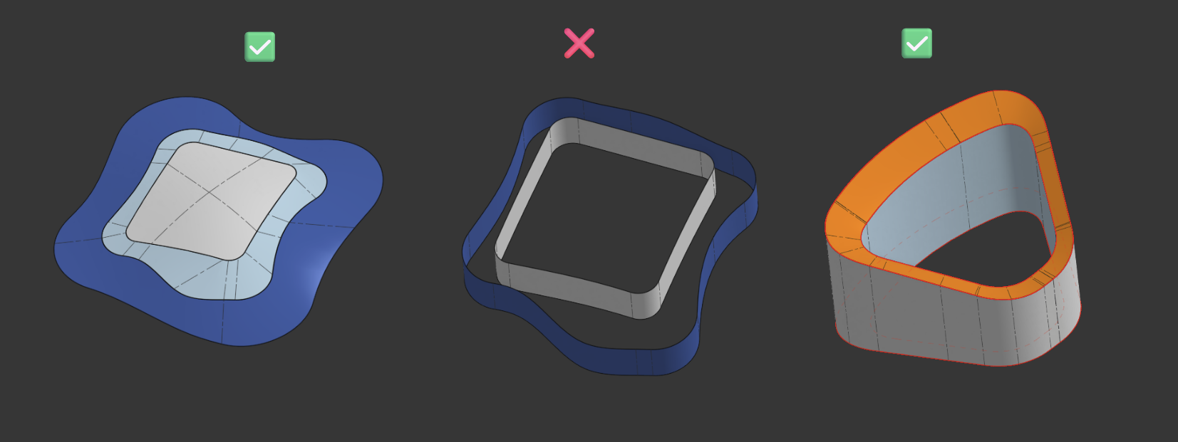

    @jelte_steur_info I tried your part. I sort of got it to work, but I'm having a hard time understanding when it fails.
    It looks like it fails if the reference faces are "perpendicular" to the loft, but succeeds when the faces are mostly parallel to the loft. However, I have a different case where that works just fine. I'm a bit puzzled at the moment, but I'll keep investigating.

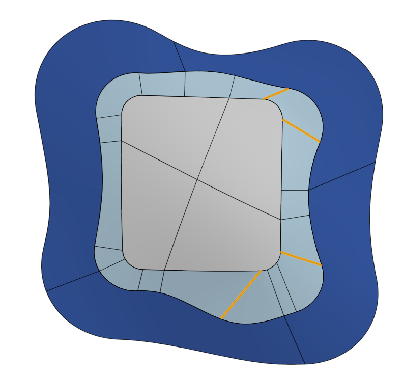

    Hi @ry_gb:
    good progress! I'm looking into it.
    First off, even though the first loft in your line up is working, these orange lines don't seem to have actually found the shortest distance:
    possibly because these edges were already connected and are therefore omitted by your generateNearestDistanceConnections function?
    perhaps an evaluation of how far from the ideal evDistance the actual connection is and filtered that way to still create new connections?
    I'm still trying to find why the loft error "Could not align profiles to loft direction" is coming up…
