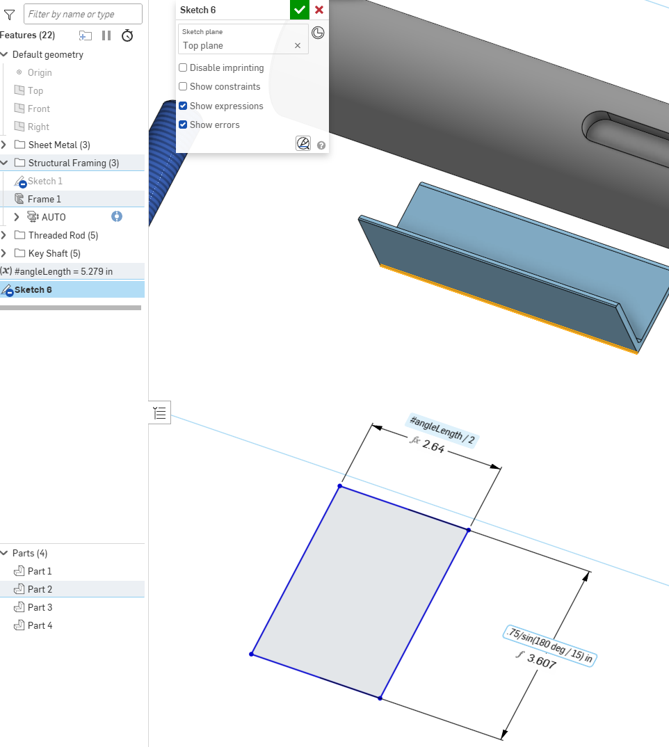

When in a sketch, it would be great if we could make dimensions equal so the dimensions change together when I make a dimensional change.
  • Matt_ShieldsMatt_Shields Member, Onshape Employees Posts: 893 PRO
    Yeah, Onshape doesn't do dimension relations.  But you can make a variable on the fly.
    Or you can use constraints.

    @Matt_Shields this, as mentioned (in one of the posts i saw with regards to this) creates a feature tree full of functions.. is there really no way that onshape will take on this mod to enable the dims to have equations in them? this is a really neat function of most cad systems that ive used anyway..
  • john_mcclaryjohn_mcclary Member, Developers Posts: 4,027 PRO
    Dimensions do have equations in them. You can even use comments and such.
    I used to miss being able to set dims equal to other dims from SolidWorks. But then after a while in Onshape I found it is not necessary at all.
    The on the fly variable works just fine, you can also create a variable from the measuring tool with a single click.
    Between that and the equal constraint, you're fully covered.
    If you end up with a bunch of variables on the tree, then you can use the variable menu on the right side flyout to manage them quickly. Otherwise you may just be abusing that style of relationships. I actually like the variable method since you can see at a glance the design intent without even opening the sketch. Whereas in SolidWorks this was hidden until you edited the dimension.
    you can also check the show expressions option in the sketch to see all your equations.
