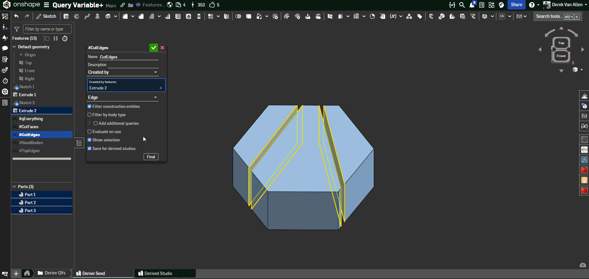

    Looks like one of my previous updates overrode the qEverything and qParallelish options. Restored them and added the icon in V13.
    Next update coming today likely. Trying to make it possible to pass QVs through a derive operation to save selection sets in one document and reuse them in another document using attributes.
  • Derek_Van_Allen_BDDerek_Van_Allen_BD Member Posts: 606 PRO
    V15 release brings the ability to save and load Query Variable selections to pass between derived part studios. Set up a QV in your seed document and check the box to save that selection for use in derived studios and now all of those entities will be labelled with an attribute that stores information about the name of the QV on those entities. Then when you derive those parts / entities into another document the attributes come with them and you run a second QV+ targeting the derive operation, all of the attributes that QV+ picks up from the geometry will get reconstructed into new QVs with their original names.
    If you're a fan of procedural workflows this update was for you.
