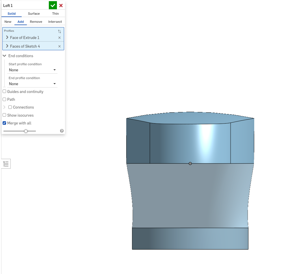

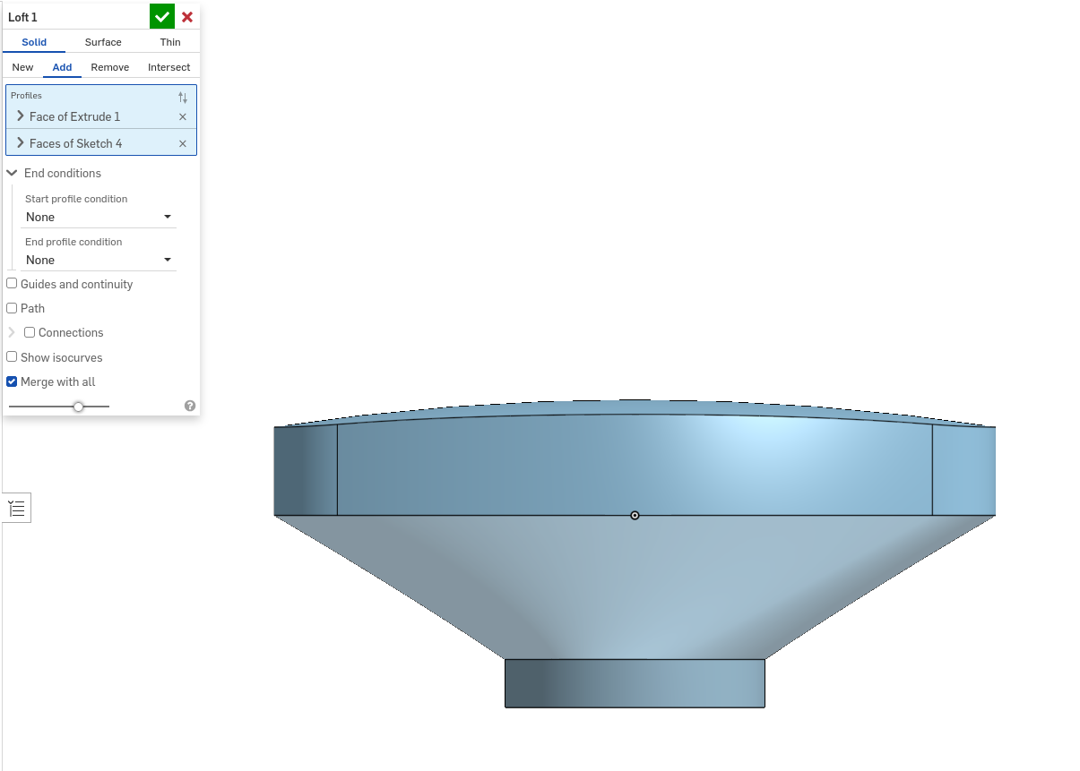

Hi everyone, I've been working through the model mania parts and have been getting a different result with the same procedure as given in the solution. I am aware that this is usually done in SOLIDWORKS so it could be a Onshape specific feature.
I'm trying to loft a feature with start and end conditions set to none. Attached are photos of the desired result on SOLIDWORKS and my result on Onshape.
The front view looks fine but the right view shows curvature in the loft where there should be none.
Any ideas on how to have the loft connect straight with the lower part?

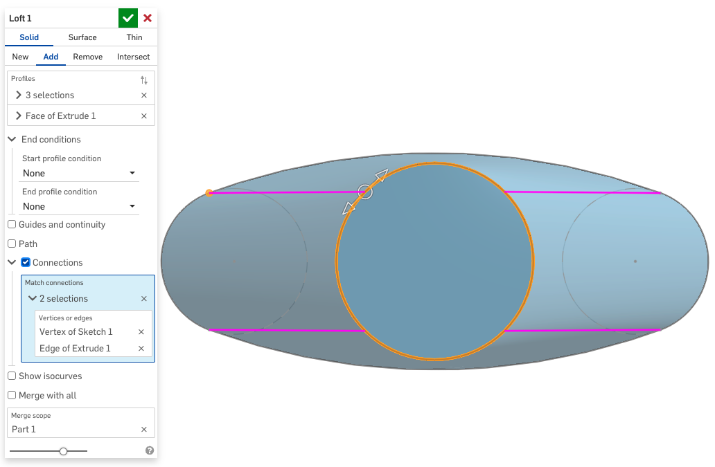

  • GregBrownGregBrown Member, Onshape Employees, csevp, pcbaevp Posts: 373 image

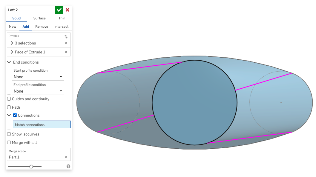

    yes, if you turn on the Connections option you'll see something like this:

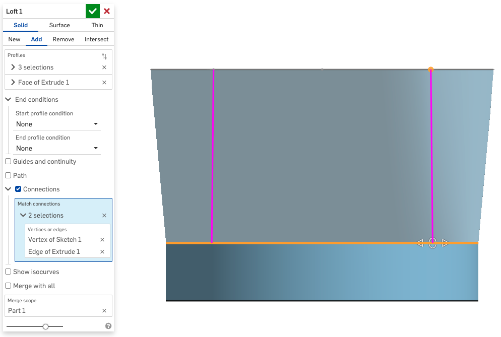

    In this case all you have to do is create one "connection" from the arc to the circle and drag the manipulator around until it's right:
    Screenshot 2026-02-02 at 8.02.31 AM.png Screenshot 2026-02-02 at 8.02.53 AM.png
  • NeilCookeNeilCooke Moderator, Onshape Employees Posts: 5,968 image
    There is probably some twist in it. Turn on connections and adjust to straighten it up.
