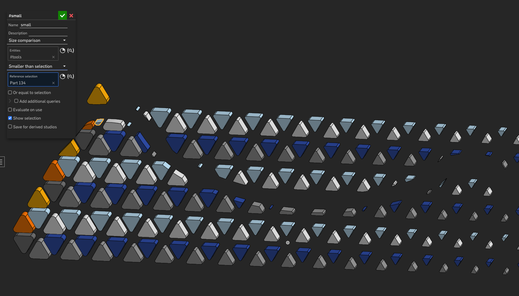

    I'm not sure if I'm making a mistake, but Size comparison seems to be not working correctly.
    CleanShot 2026-02-01 at 11.59.15.png CleanShot 2026-02-01 at 11.59.27.png CleanShot 2026-02-01 at 12.04.41.png

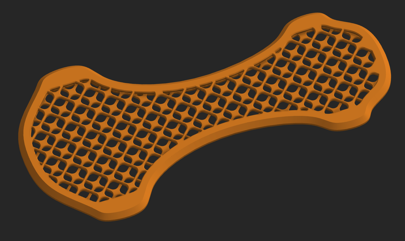

    Also, wanted to say a huge thanks, because I can now stop using Grasshopper with your tools and Evan's attractor pattern for this simpler patterns I use for FDM printing.
  • Derek_Van_Allen_BDDerek_Van_Allen_BD Member Posts: 846 PRO
    Ah, looks like a scale related issue. My tolerance values are not size dependent on the input so it's casting too wide a net at smaller scales. I don't typically work in mm scale so that explains why I missed this. I'll look into updating that to be some percentage of the input reference instead of a global tolerance for comparison.

    Another one one I've noticed is in the Positional > plane normal, it selects faces that are normal to the chosen face independent of direction. Would love for that to have the ability to have it only allow if the normal is actually in the same direction as the reference face.
    For example, the orange part I posted earlier, those internal crosses are identical on top and bottom and exist on the same plane, but I just wanted to select all the ones that were facing upward in order to chamfer. Had to split the part into two bodies, query the faces, then boolean, then chamfer.
    @armandoRR looks like there's an overload for the parallelPlanes query that I could use to toggle parallel / antiparallel geometry so I can pencil that in for an update as well. Currently I'm messing around with sheet metal queries (and inventing a few new ones that I would argue should already exist) so it may take a moment before I push that update.
