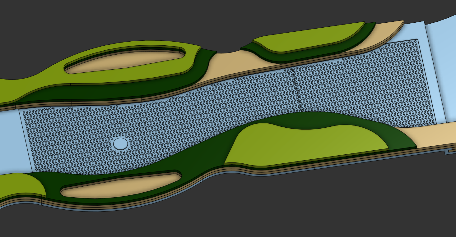

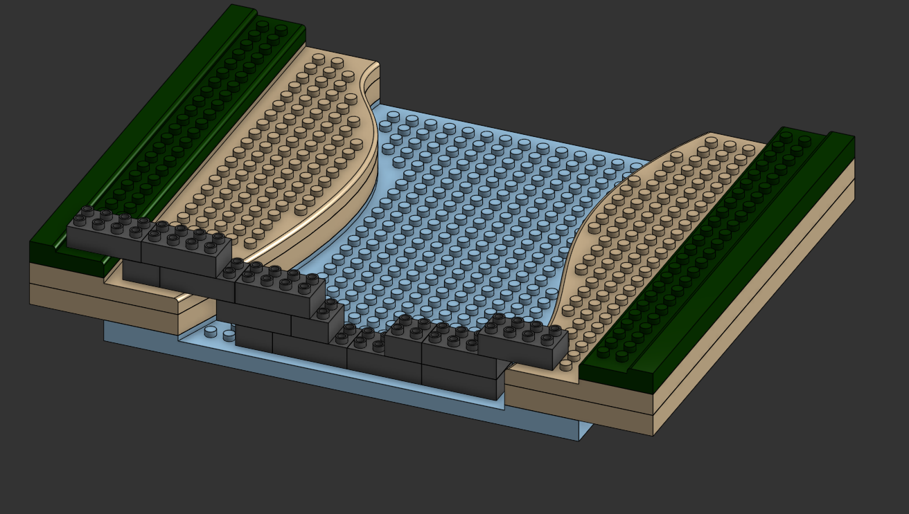

    edited February 3
    It's for CNC routing full 4x8 sheets of them. Gotta be one solid when we send it to the mill. Oh and they're not perfectly square grids, there are islands in the middle and random topography scattering the edges so it's gotta be a fill pattern with offsets from the walls. Also no, we can't do a .dxf export of them because we care about manufacturing tolerances in full X Y and Z dimensions and our entire mill pipeline works on raw parasolid imports.
    This kind of jam.
    Except with the bricks going up onto the topo too.
    The mill department loves these.

  • Derek_Van_Allen_BDDerek_Van_Allen_BD Member Posts: 662 PRO
    @sebastian_glanzner the management of the Boolean count is the performance drag, not the tesselation of the final result.
    @EvanReese the job is equal parts dream and nightmare. If you've ever wondered why some of my scripts end up the way they do where a simpler approach would cover 90% of everyone else's use cases but I choose an implementation 10x more complicated for that last 10% of use cases it's because of parts that look like the above images.
    We do already have some fill pattern suppression happening for keeping things light during our workflow but a 3 second rebuild on duplo fill has to happen in the same file as 40 seconds of other highly interrelated model structure so everything I can shave off helps. The single mondo boolean at the end is still gonna run 1000 comparisons between each little stud and the final sheet so if I dice everything up into regions and chunkify them and then memoize the chunks I can probably cut that down to at least sqrt(1000) booleans which would be a huge improvement. Assuming Onshape works anything like Minecraft which it kinda does.
