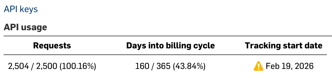

    One place this is really painful is developing custom features using an LLM. I had some great scripts set up which would push updated code to Onshape using the API. I've managed to burn through my monthly limit in less than 1/2 a month. I'm back to scripts that rely on copy/paste/commit in the browser. This approach is very brittle and depends on the browser focus. To me it makes zero sense. If anything this is more of a drain on servers to do things this way.
    Somehow my almost 1000 git commits since turned into 2504 api calls since each API powered Onshape Commit involved a GET and POST to push the .fs file, and then two GETs to check the Feature Studio contents response and the featurespecs response (is this necessary?). So in less than a month I've burnt through a year's API usage????
    @Vajrang_Parvate Any possibility that there can be a better way to manage these resources? I'd love to have MCP integration within Onshape so that any LLM that can communicate that way can easily read the Onshape monitor and profiling tools and commit .fs changes. As it was, even with my scripts which could commit FeatureScript updates, I had to either manually cut and past notices back to Codex, or get it to scrape the browser window (not very reliable) to get feedback to Codex.

    Simon: just so I understand what you're getting at: are you saying that API for committing .fs is inefficient (requiring more client-side calls than necessary) OR are you saying that Onshape is counting client-side API calls incorrectly?
    We have gone to great lengths to make sure the API counting is accurate, so if it's the latter, please send in a support ticket with additional details if you may have and we'll get that looked into asap.

  • S1monS1mon Member Posts: 4,077 PRO
    edited March 16
    @Vajrang_Parvate
    Codex wrote the scripts to commit FeatureScript to Onshape documents. I didn't look too carefully at how it was doing it since it worked so much better than copy/paste in the browser. I'm not sure if all the calls that it's using are needed. It seems like the initial GET and POST are required, and the subsequent GETs are there to check that it worked, but I don't fully understand the API. Perhaps I should understand it better.
    More my points:
    • The API limits are painfully low. I burned through a year of tokens in a month.
    • I wish there was better tooling to connect LLM models to Onshape for FeatureScript development. I would like this for a number of reasons (mainly having a better closed loop for test driven development and performance tuning), but one would be to avoid burning through API usage.
    Follow up questions: how do I get my API allowance increased? Where do I go if I'm willing to pay, or can I get some sort of help here? I don't want to upgrade to Enterprise to do this.

  • Vajrang_ParvateVajrang_Parvate Member, Onshape Employees Posts: 19 image
    @S1mon: You don't need to be an Enterprise user; the paid API plans are available for purchase for Standard and Professional users as well. https://www.onshape.com/en/contact-sales and they'll get you sorted.
    I would strongly recommend "taking ownership" of code that you're generating with any AI tool - be it client side code that's calling Onshape API or FeatureScript. You should know and fully understand what that code is doing since it is operating on your behalf with your Onshape account keys.
    @Konst_Sh: Submitting an App in the Onshape App Store with the sole purpose of bypassing Onshape's API limits, or enabling end users to bypass those limits, will not get very far. This is documented here https://onshape-public.github.io/docs/app-store/ and in the API Agreement (shown on first login to the dev portal).
    @Vajrang_Parvate
    Part of my point about the API limits and the lack of tooling is that instead of using the API, it was actually more useful today for me to get Codex to write tooling for Chrome's new Devtools MCP and Playwright. In addition to getting a more stable sync/commit featurescript updates to Onshape, this gives me good access through the DOM to gather regeneration times, and run profiling on multiple part studio tabs automatically. It seems odd to me that Onshape charges for API calls, but it's entirely possible to automate a lot of things through the browser that aren't even available through the API.
