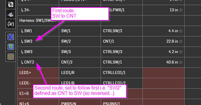

    @NeilCooke, just submitted a ticket about what looks like an issue with "follow first route" not respecting the clip order from the first route when set to "follow clip order"…
    I'm guessing the ticket will find it's way to you but here it is anyway… https://onshape.zendesk.com/hc/en-us/requests/409147
  • NeilCookeNeilCooke Moderator, Onshape Employees Posts: 6,048 image
    Wouldn't surprise me - "follow first route" was added at the start and i never really kept up QA on it because usage was low. I'll take a look at the ticket.
    @eric_pesty fixed the "follow first route" issue in 1.212.0
  • eric_pestyeric_pesty Member, pcbaevp Posts: 2,753 PRO
    Thanks, it's still not working for me but it might be partially my fault…
    Because I have three refs, my "second" route ended up defined starting from the other end (ie.. the from and to refs are swapped) from the one I am trying to follow. I can see the route is literally following the same clip order as the first one from the wire route feature, but in this case it happens to be exactly backwards!
    I guess you would have to define the "route" as having no direction and/or check the "to" and "from" refs rather than just use the order of the clips in the first route for this to work...

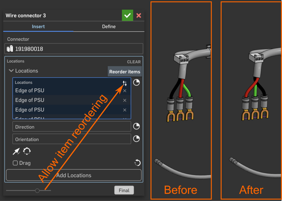

  • scott_fraser105scott_fraser105 Member Posts: 1 PRO
    Love the feature, recently I replaced a part in the assembly, and several of the connectors got shuffled…
    I wonder if it's possible to allow for reordering when inserting Wire connectors?
    Something like: Route connector FeatureScript → line 99 add: , "UIHint" : UIHint.ALLOW_QUERY_ORDER
