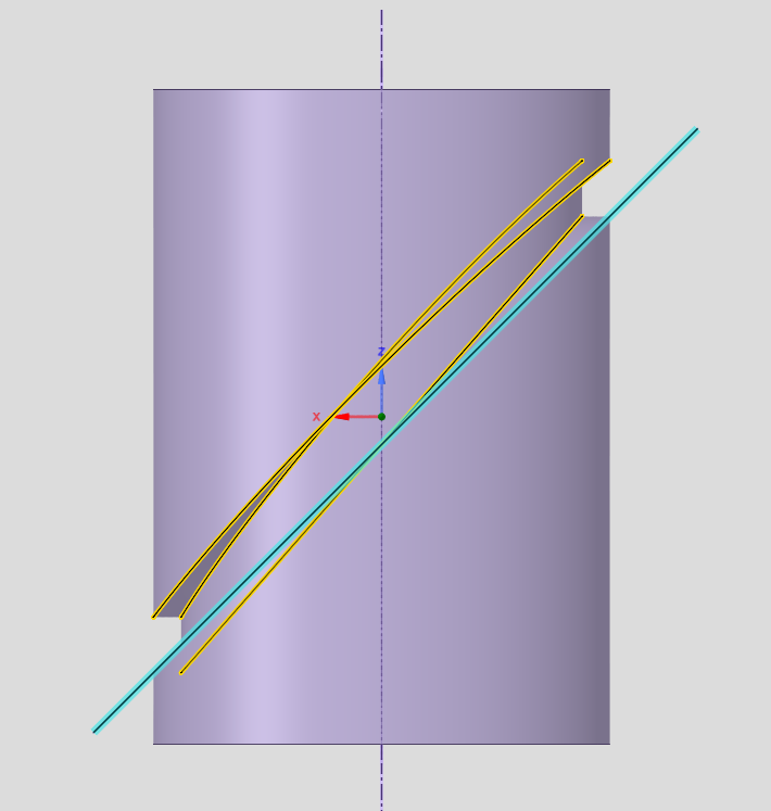

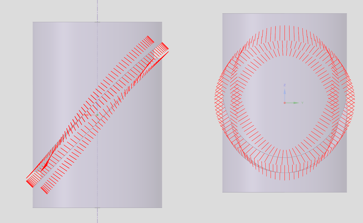

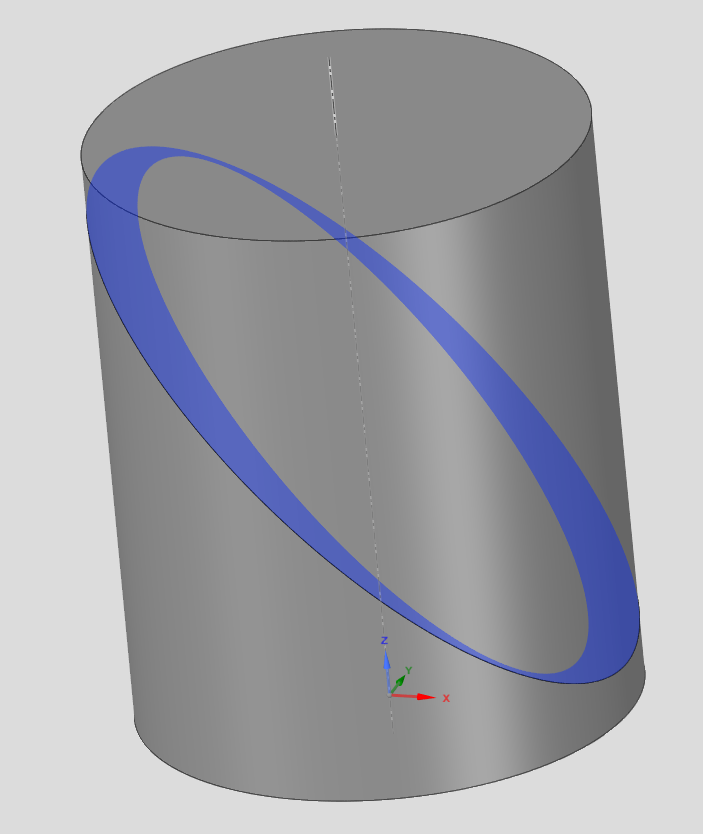

Alright here's a few more section views and illustrations to hopefully elucidate the unintuitive cutting path this geometry takes:
Those wonky angles you see in the cross section across the side view? Those are supposed to be there for the pin to move through the slot. That's because we're not cutting a path relative to that cross section, this whole slot is cut on a 45 relative to that origin. If you look at the side view of where our cutter would engage with the side geometry, the cutter doesn't interact with those faces at the exact midpoint of the toolpath from that view. Those faces are getting cut at those points before or after the "midpoint" of the side view of the tool sweeping through.
In this image the purple dotted line is your wonky section view where you see non-parallel cuts, and the adjustment I made in my gif above shows the true cutting dimension of the toolpath when positioned at that point in the green line as a cross section. You can see where the tool actually engages with the top face of the purple cross section drawn out in orange, and the bottom slot face drawn in pink. This is why you see those angled faces is because the cutter doesn't actually engage with those faces in the mid-plane of the part like you'd think it would. It happens both before and after the tool sweeps through the side plane.
@glen_dewsbury this example, too, falls prey to the minimum slot width constraint that the other sweep examples do because the sweep options don't allow you to specify both locked sweep direction and locked face orientation sufficient to keep the width consistent for this kind of manufacturing geometry,

This part is destined to be 3D printed (mSLA), at least in the first instance, so toolpaths are not a thing. If the overall design works out to the point I want a metal version, I wouold use lost polymer investment casting (ala:
https://www.youtube.com/watch?v=lJ4qE95lAXs) )
If it were ever to be manufactured at scale, MIM would be my first choice. The g-code required to generate this profile accurately would be a nightmare. Close to hypoid gear level of complexity.

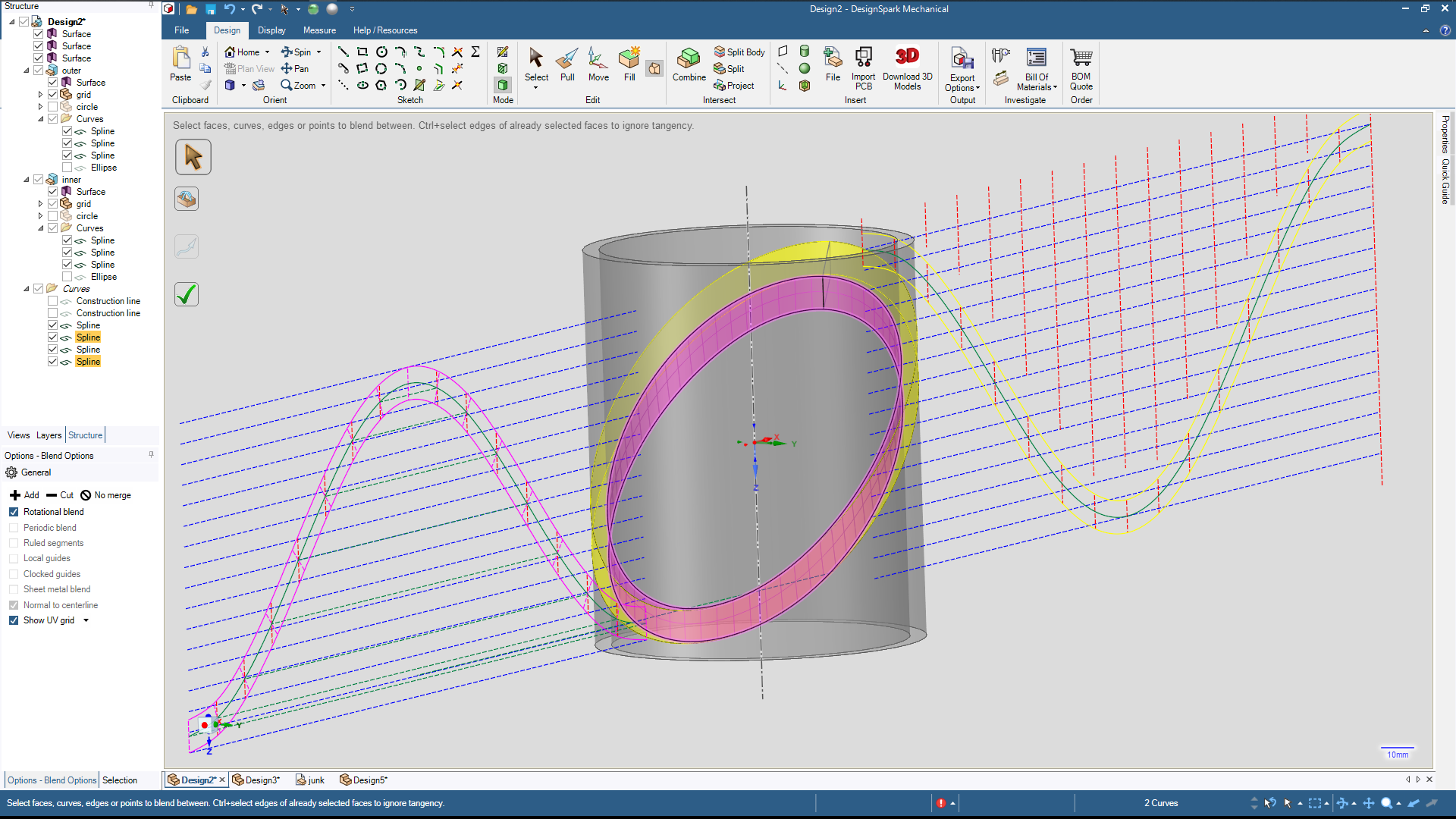

The only way I've come close to a "totally accurate" model is to forgoe the builtin tools and resort to old fashioned methods:
This involves projecting the ellipses (from both outer and inner cylindrical surfaces) onto 2D maps, constructing offsets normal to the projected ellipse (sinewave) at each point, and projecting the ends of those points back to 3D.
Which is incredibly tedious, time consuming and error prone, though much less so with electronic help. There's also the problem that whilst your caught up in the minutiae of all the 2D and 3D projections involved; its easy to miss a (glaring above) macroscopic mistake that renders it all nearly wasted. (I mentioned a long, bad day!).
I've no idea if this is even possible with OS given you cannot easily reference existing geometry from within a sketch, nor (based on my knowledge so far!) construct curves directly in 3D.
Perhaps constructing the maps for both inner and outer cylinders, wrapping the around their respective cylinders and the blending between the resulting curves might be possible. I did look, but do not yet see the method for the latter step.

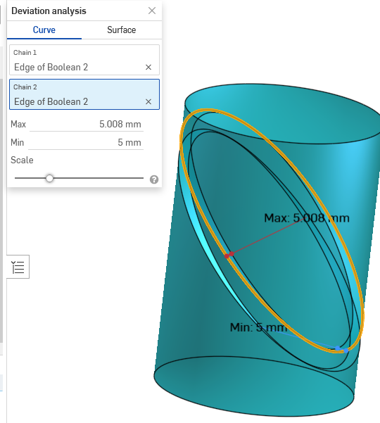

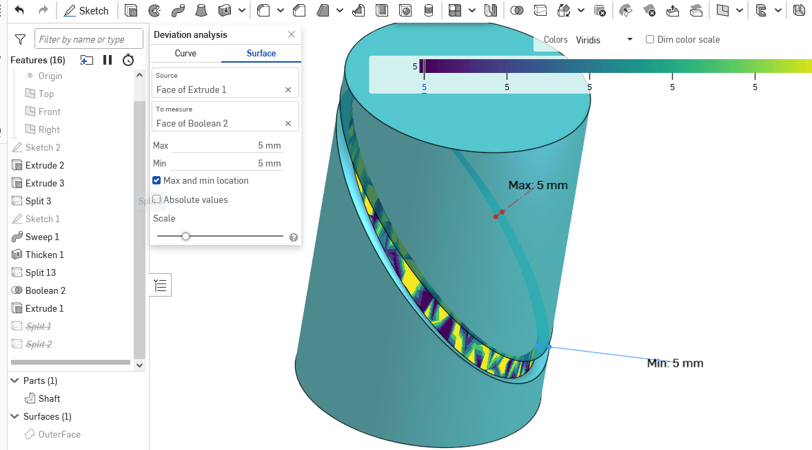

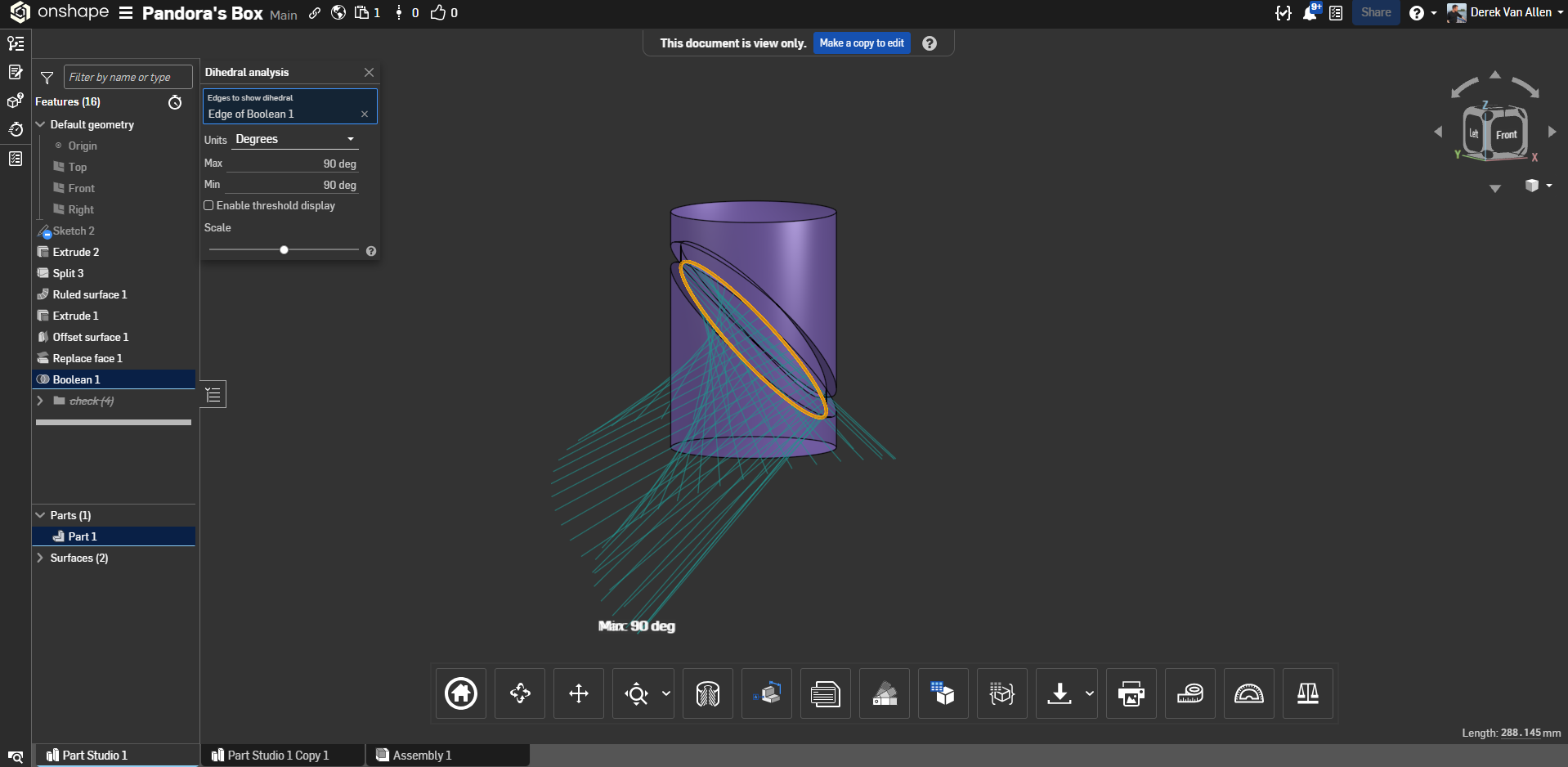

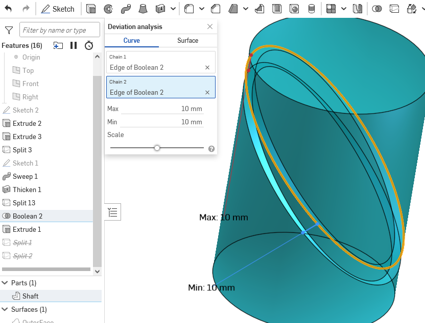

Alright @buk_browseruk here is your perfect slot request 10mm wide by 5mm deep all the way around (according to the onshape measure tool) Now all the way up to 8 features. Link below.
https://cad.onshape.com/documents/cd0e5334223b19e0dba8d520/w/744c358faa2dab182ab0251b/e/41aa787074b7aa33745bd517

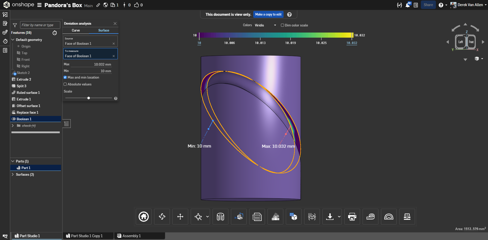

Bringing some more analysis tools to the table to inspect these surfaces shows that your slot width varies from 10mm thick to 10.032mm, which is pretty good. A 10mm pin will definitely not get stuck in the slot.

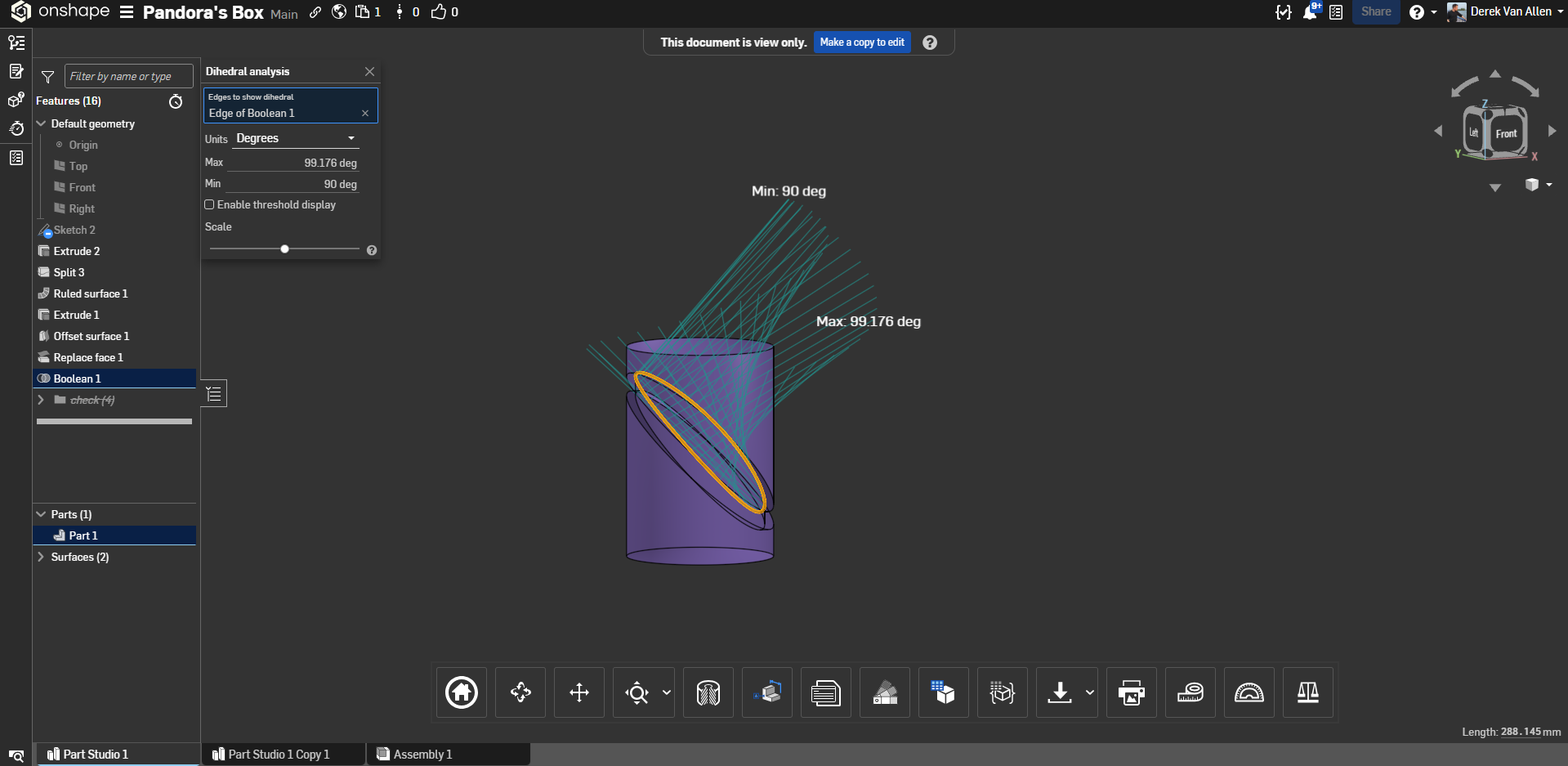

The inside edge of the bottom face of the slot also has a perfect dihedral angle as well:
The top edge of that slot, however, has an almost 10 degree deviation in angle across its geometry.
So although the bottom of the slot might claim a label of perfection, the top side of it appears not to be an entirely perfect match for it.

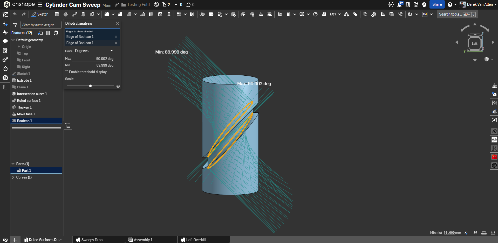

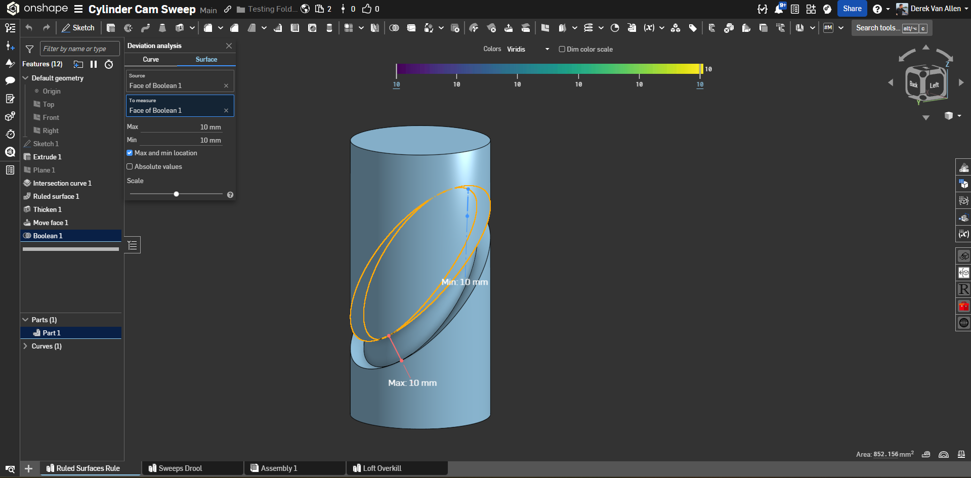

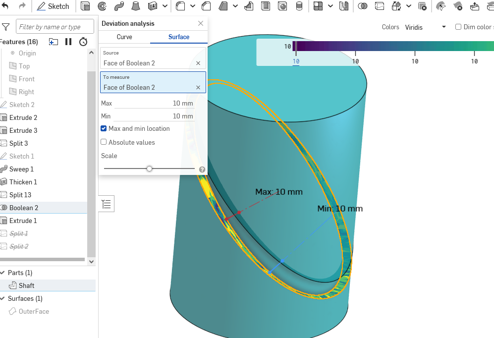

In my example with the ruled surface thickened from the middle out we see 10mm max and min dimension via surface deviation inspection:
And dihedrals that are +- .002 degrees at the root of my slot geometry.
And I'm not entirely sure that the dihedral analysis tool is fully capable of analyzing these surface conditions entirely accurately to that level of precision, but given that my slot is generated via ruled surface it would not surprise me if this angular deviance is a result of the approximation routines that feature runs.

Derek Van Allen | Engineering Consultant | MeddlerThanks Mdesign. That downloads via STEP and is true to < 5nm, so good enough.

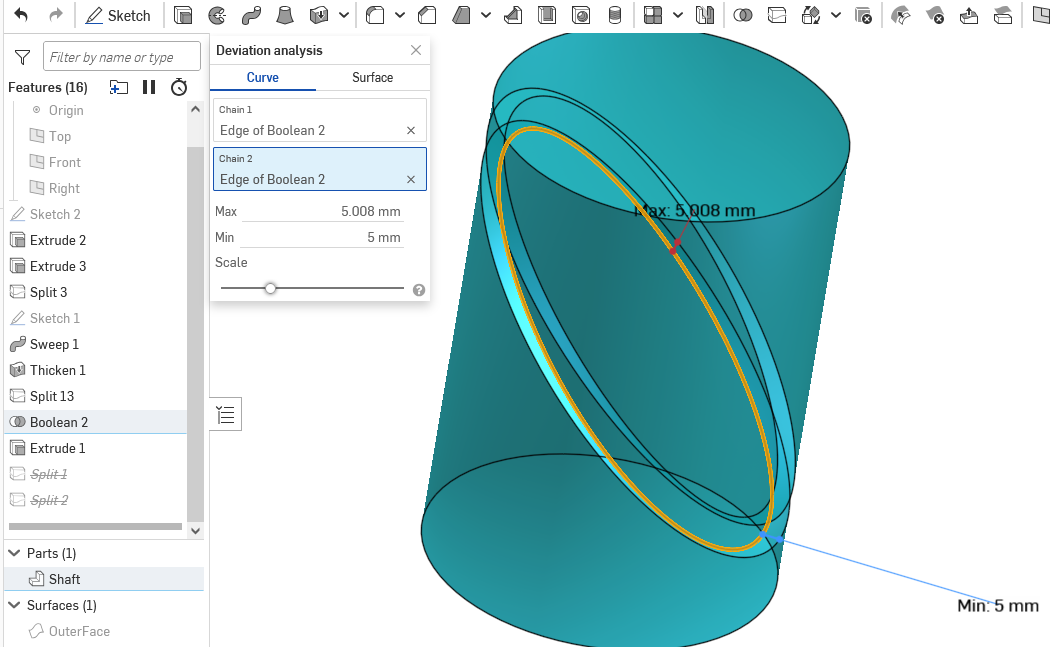

Like, Derek Van Allen, I performed some analysis on the results:
One interesting point is the process you use produces an asymmetric groove:
You an see that the outer edge of the bottom face of the grrove, is on a plane and the inner edge almost so, but the upper face of the groove has both edges bowed distinctly upwards in the middle.
A symmetrical groove would ensure than the linear motion of the follower would have consistent acceleration profiles in both directions. The differences are small, but show up down stream.

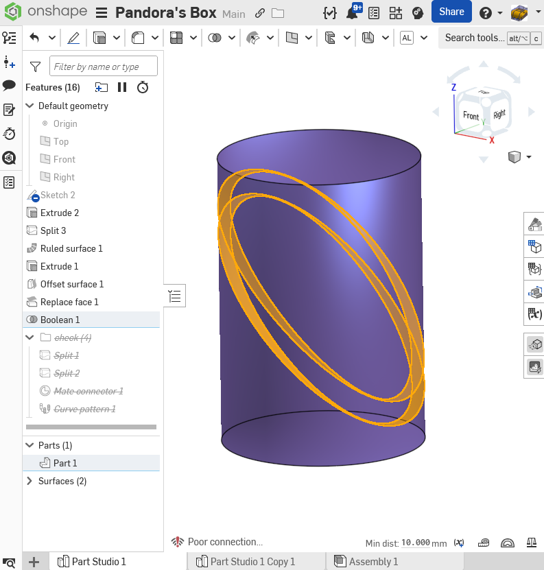

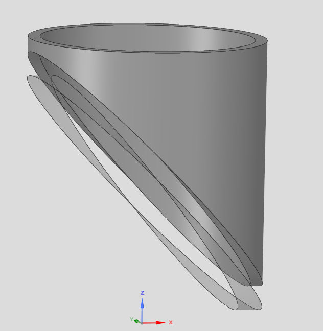

You create the elliptical split:

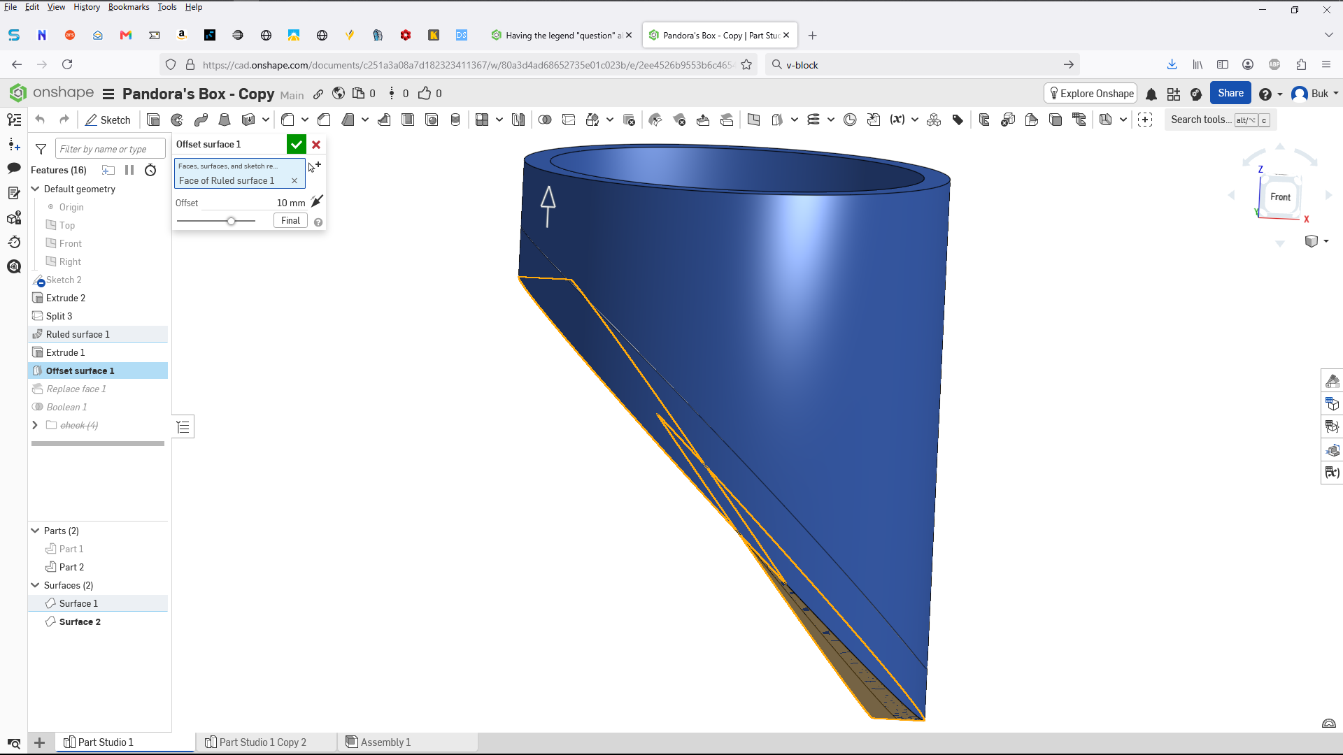

You create the 'normal' type Ruled surface, with a 10mm offset (rather than 5mm required radial depth), which may or may not be significant.
You then do a (mysterious) (new, thin) extrude of the top edge of the cylinder, that during operation produces a second solid (something like this):
But when the operation is complete, the solid disappears (thin! with thickness 0), and a second surface — the bottom face of that temporary solid — appears in the parts list:
This (visually) looks like a complicated way to duplicate the existing surface, offset 10mm above the existing one, whilst reducing its axial width to 5mm; but is obviously more than that as simply offsetting the existing surface 10mm leaves a minimal gap of 6.something mm:
Besides, the next operation is an offset surface of surface 1, not the new surface, by 10mm. However, during this operation the mysteriously vanishing part 2 reappears (temporarally) in the parts list, despite that surface 1 is referenced (not surface 2 that was derived from it!?)
(No attempt to re-create this as I have no idea what is going on at this point. :( )

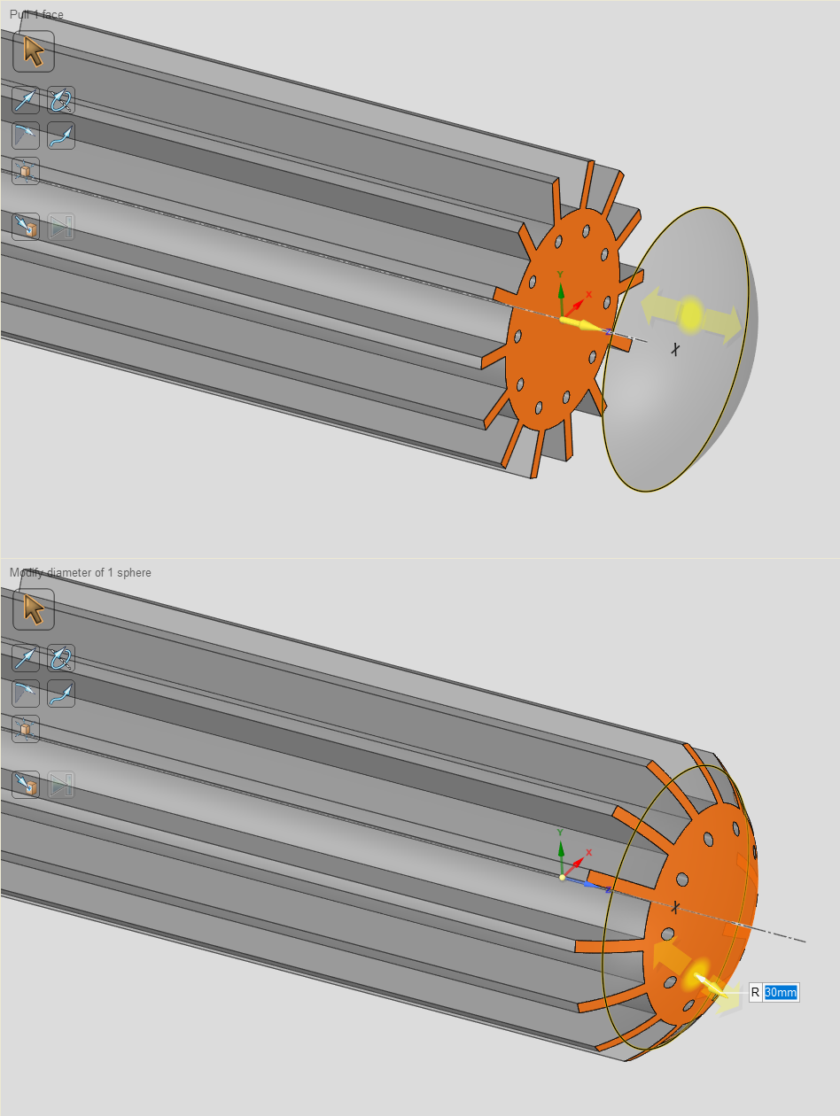

At this point you do a Replace face. Which is a clear operation that in SC terms is a "Pull face upto face". I can easily replicate the example of Replace face shown in https://cad.onshape.com/help/Content/PartStudio/replace_face.htm#Examples:
But applying that understanding to the operation you perform, in the absence of understanding the preceding operation, leaves me cold.
Once again the transient part 2 reappears during this operation, despite that none of the elements that created it — sketch 2, extrude 2 nor surface 2 — are referenced in this Replace Face.
Utterly befuddled is the best way of describing my mood.

Wow, You put a lot of time in that response. I've been entertained by the exercise but have spent way more time than I probably should have on it. I was generally curious as to what I would learn through the process.
The thin extrude was simply an attempt to control the depth better than the prior attempt( which fixed the width of the slot but then exposed the depth changing). Nothing disappears when that is created as far as I can see. I'm simply trying to create an accurate slot that is solid which is subtracted from the main body.
I hadn't noticed the asymmetry but suspected that would be the case probably with what I was doing (I was just trying to save effort with less features and still meet your dimensional requirements), Thanks for pointing that out. That most certainly is due to the nature of not using a center slot control feature. I simply offset the full 10mm instead of 5 each way.
The ruled surface not being 5mm is insignificant as its only used to control other geometry. Sometimes it helps to have controlling geometry overlap a bit to prevent some issues.
The replace face is simply easier to do that a split which is why I chose to use that.
