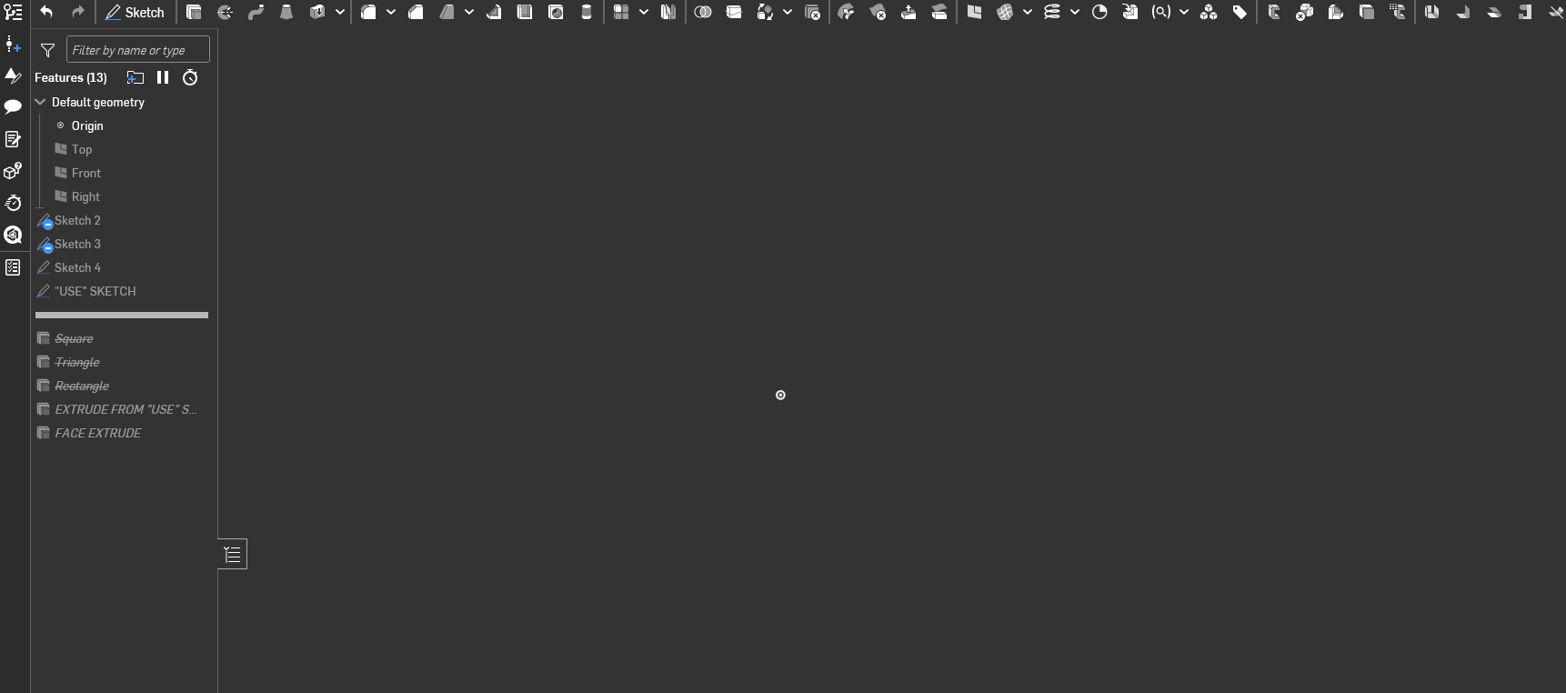

    I run into this issue a lot, so instead of sharing a more complex file, I created a public document to showcase just this issue, and I will leave it in it's error state.
    https://cad.onshape.com/documents/569c6012692b856c4357c414/w/fffe73a22d2593b0556cad9b/e/67f113b51f1685d90a9fe2ee?renderMode=0&uiState=6a276866d9438d41c20d5c38
    The basic idea of this file: I have 4 bodies that all overlap. A circle, a triangle, a rectangle and a square. I boolean the Triangle, square and rectangle together, then start a sketch on the resulting face, and use the "use command" to grab all of the outer edges of that face. I call that the "USE SKETCH", and then extrude the sketch called "EXTRUDE FROM USE SKETCH". This works perfectly if I do this in this order. But now, if I go back to the boolean and instead of the square, I pick the circle, the result is a single body with a face on the same plane, but the outline of that body is different. Now "USE SKETCH" fails, still referencing the edges of square having not updated to circle.
    Oddly enough, if I skip the sketch stage and just use the face generated as the input to an extrude directly, the resulting extrude does update with the boolean (FACE EXTRUDE in my example doc). Why does the direct extrude from a face work, but the sketch fail?

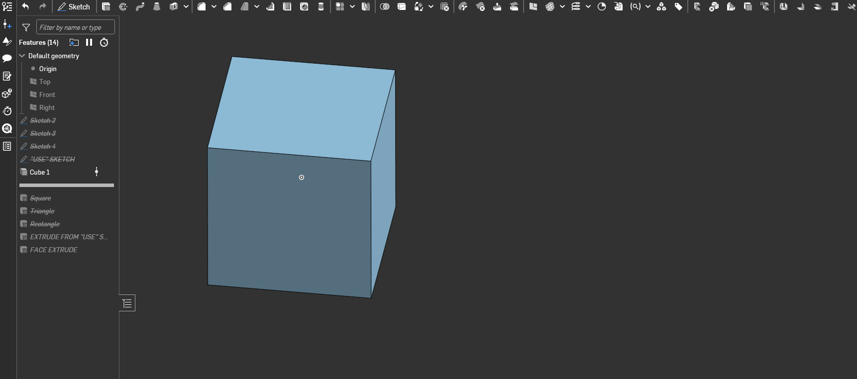

    I see what you're trying to do now. I'm not an expert on the subject, but maybe I can shine some light on what's happening. I created two simple examples that I hope are more hlepful. I'm posting some gifs and will come back and explain them later because I'm out of time. The way I see the scenarios, they're pretty equivalent to what you're doing.
    But the simplest explanation is that:
    1. When you change the boolean scope (switching from a square to a circle), you're breaking the link between the edges you selected previously.
    2. Inside a sketch, USE takes the face and extract the edges from the face to create the sketch lines. But now those sketch lines can't point back to their source.
    3. I would use Query Variables to try to fix this, but as far as I know, you can't summon query variables inside of a sketch, especially not for the Use command.
    4. Faces are more stable than edges. So when you extrude from face, you're still selecting the same face (has the same ID).
    5. Faces can break too, but you're happening to select a cap entity, which is a pretty stable reference.
    Example 1:
    Example 2:
    The good thing is that you already found a solution to your problem.
    Ramon Yip | glassboard.com
  • christopher_whipple454christopher_whipple454 Member Posts: 6
    I appreciate the detailed reply and the gifs, the first one is exactly what I was trying to showcase! I agree this is accurate to what is happening behind the scenes. I am working on a feature script that takes in a face and generates a sketch dynamically, leveraging the stability of faces to my advantage. This will work well with operations that prefer sketches (in my experience, there are a few that work better with sketches instead faces) but maintain flexibility in the feature tree.
