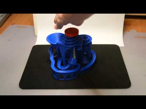

As I wrote in this thread: https://forum.onshape.com/discussion/2694/after-using-onshape-for-a-few-months, I have spent a lot of time waiting for Onshape while working on this particular model. The worst waiting is (naturally) when going back in history to do some modifications. Everything is then quite slow, and in many cases there are no indication (not even the spinner) to show that Onshape is working. While I had kind of hoped that someone from Onshape would reply to that thread (I feel I raised some valid issues), that hasn't happened (at least not yet).
My experience with that model tells me that it is too large for Onshape to handle with decent speed, so I am wondering how large models other people make with Onshape? I do realize that this is a difficult question, because it largely depends not only of the number of features, but also what kind of features are used. Some are more computational intensive than others, probably causing even more slowdowns than "lighter" features.
Here's a screenshot with model statistics of the model I am talking about:
As you can see, my model has a lot of arcs and splines (and sweeps), which is probably giving Onshape servers some additional work.
Am I asking too much when I want to have a model of this size and complexity in a tool like Onshape?

  • philip_thomasphilip_thomas Member, Moderator, Onshape Employees, Developers Posts: 1,381 image
    Oyvind - this is very impressive and I will be showing this image to some of our senior developers to get their input.
    I may be reaching out to you privately to ask if you would be willing to share this with us so that we may run a performance profile against it (we cannot see anyone's data unless they explicitly share it with us). Thank you.
    Oyvind - we are very impressed. Onshape is evolving rapidly, but we have to admit, we have been optimizing for mechanical design (castings, machined parts and mechanical assemblies). We fully intend to give you a complete toolset to complete projects like this, but as you have clearly demonstrated, it's doable today. I don't want to gloss over the acknowledgement that we know you have struggled at times and we want you to know that we are committed to making Onshape the go-to tool for industrial designers, plastics engineers and mechanical engineers alike. Stay tuned for more enhancements that are coming. Again - well done! :)

    One more thing,your model is very impressing, I really like it.
  • øyvind_kaurstadøyvind_kaurstad Member Posts: 234 ✭✭✭
    Thanks. You should know that you helped me a great deal when you answered my question about creating a marble rail. That was of course the precursor to this model, so you can take some credit too.  :-)

    Is your marble track model done entirely in OnShape from the proof of concept you and @michał_1 discussed in this thread?:
    https://forum.onshape.com/discussion/2583/how-to-model-a-marble-track
    I hadn't gone back to see your previous concept in the end of that thread and am absolutely floored at the execution of the concept.  How robust is the model?  It looked like Michal had made OnShape do some serious tricks to even get the proof of concept to work without 3d sketching tools, so seeing this finished product is amazing.  Absolutely amazing work.

    @matthew_menard Yes, my model is done entirely in Onshape, and my primary take away from the mentioned thread was the concept of extruding to surfaces, and then splitting those to simulate 3D splines. At the time of that thread, Onshape didn't have the split faces tool (iirc), so you actually had to extrude a second surface to use as the splitting tool. However, I didn't use that technique in my model, since the split face tool is now available. That means I can extrude one surface (from the "ground"), and split that directly with a spline on a sketch on a plane normal to the "ground". It is a bit cumbersome, but in the end you end up with a "3D spline" that a profile can be swept along. You can't sweep the actual track profile though, because it will twist uncontrollably, so I swept a pipe, and then thickened the vertical surface to become wider than the pipe. Copy that, and transform the copy so that the top ends up above the pipe, and then intersect those bodies to have a new solid that can be used to subtract the top half of the pipe while maintaining the edges parallell to the ground.
    I don't think the model can be called robust, there are way too many workarounds and shady techniques (and I was also a bit too lazy regarding constraints), but the result is still quite good. And Onshape really generates extremely clean STL files. No repairing necessary whatsoever.

    Thanks for uploading the STL files for your Cyclone.  I'll be printing it on my Zortrax M200 soon.  It would make a nice gift for a couple friends kids.  Once I get done with it, of course.
