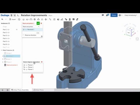

        2. Improvements to relations - More mate types are now supported when creating relations
         https://youtu.be/L1KzfQzA4tI

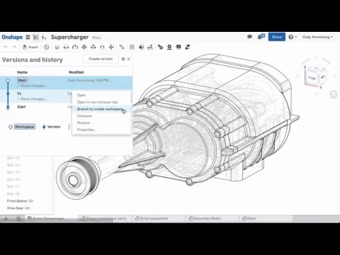

        3. NEW Create version command - A new create version command that creates a version and automatically gives it a name
         https://youtu.be/96havHlaUCw

    Can we please have a dialog for the 'create version' button?
    I have already managed to click the button twice by accident, which created two unnecessary versions that I can't get rid of. Also, I want the ability to turn some versions obsolete. :smile:  It would be nice to have the ability to flag some versions as obsolete with an option to hide them from the version graph. Nice and tidy.
    Dries
    The new "hot buttons" is too hot to touch.
    I agree needs a dialogue with a rename and cancel ability.

  • 3dcad3dcad Member, OS Professional, Mentor Posts: 2,482 PRO
    +1 for ability to remove / suppress obsolete versions (that are not referenced in other docs)
    +1 for marking instances that actually change the model from history list, I've had couple times broken assembly because colleague has been inspecting some part studio (hide/show & rollback) - it is not easy to see if there has been some actual changes between hide/show
