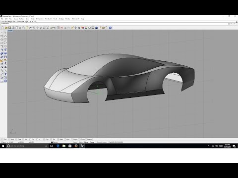

    In this image, I've got a spline and I want to attach it to the next spline, such that the two splines are connected and the result is one spline.

    Not sure what you mean; I provided a picture in the beginning of the thread of how I wanted to attach a spline to another spline; now this spline comes from some other work, so I need to attach this specific spline to others which would make up a surface. This is quite basic work, working with NURBS. Here's a video of someone working in Rhino, attaching and detaching splines:
    https://www.youtube.com/watch?v=9_voQevw9T0
    This is basically how you work with splines and surfaces. You create a cage of splines, then you create surfaces, until you eventually makes it a solid.
