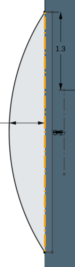

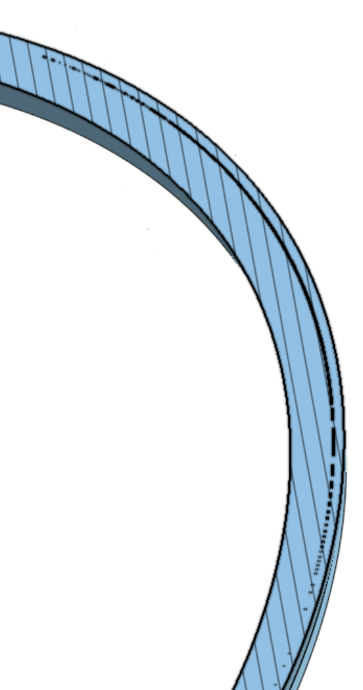

  • Isaac_9Isaac_9 Member Posts: 1 ✭✭
    I also had issues with voids.
    I slowly realized this after my 3D printer slicer (Cura) was simulating some very strange wall geometry that I could not resolve in the slicer settings.
    I was about to finish with Neil & philip_thomas' solutions using the Boolean feature. That's when I noticed the negative space wasn't producing additional parts to union with.
    I thought the boolean operation must have filtered out this small void because of a small feature limit or something, or because it treated it as a gap rather than OP's voids. This would have been easy to just re-create the part with a final boolean operation.
    Then I realized my mistake.
    The voids originally came from a sketch profile for a revolve feature closing itself at 0mm from the curved sidewall. For whatever reason, this wasn't perfect (the plane might not have been orthogonal to the wall) and was the source of my issue. I resolved this by offsetting the closed surface into the wall of the part with an offset from an internal wall. This completely solved my issue, and I no longer needed a workaround.
    In other words, good design practices help avoid issues.
