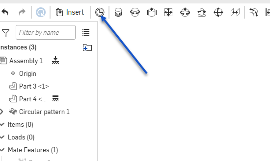

    @vincentpelletier1 Onshape does have default planes and the ability to make planes and axis in assemblies.
    Remember, a mate connector is a [Point] [XY Plane] [XZ Plane] [YZ Plane] [X Axis] [Y Axis] [Z Axis] all rolled into one feature.
    If you want more construction planes/axis/points you can just add a mate connector here:
    When you try to mate to the origin, you have the option to use all of these, just hold shift while mousing over and you can grab the other options easier.
    When you try to mate to a mate connector and access these secondary functions, you may have to edit the mate.
    Here is an example gif showing how to use the origin as a Z axis for the pattern, and all the planes to mate the tubes. I don't ever recommend doing this… Onshape has better mating options than planar... As I show in the end the video, when I delete all the mates and just fix / group the parts, taking literally 2 seconds, rather than a minute doing the SolidWorks way.
    And stop trying to run Onshape like "other CAD", learn how to properly use Onshape and you will forget why you ever thought you needed a plane in an assembly ever again.

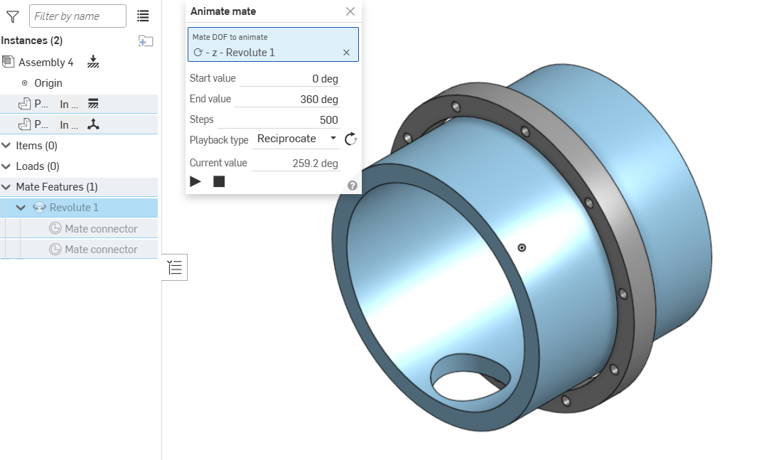

    Ok so I get how mate connectors work but I genuinely think there are use cases for planes in assemblies. Let me give you an example.
    In the image attached you can see a cropped view of a part I'm working on. I would like to create a section view in the direction of the arrow. Problem is there are 0 flat surfaces on this part in that orientation. Every surface is drafted. The 'section view' tool is asking for a 'Section Plane' But I have none to work from. So I ask you all. How do I create the section view in this instance? Please don't tell me I need to create a surface in the Part Studio and then insert that into the assembly to use as a reference.
  • S1monS1mon Member Posts: 4,088 PRO
    Oh believe me this is one of my biggest gripes in Onshape, but in this case, I would try selecting the cylindrical face of the hole that's nearby since I assume it's on the same plane as the draft split.
    If that doesn't work, I would make sure to add either assembly MCs or part MCs that correspond to commonly used section planes. Worst case, you can add big rectangular sketches and assemble them to make something that's easy to select and hide.
  • eric_pestyeric_pesty Member, pcbaevp Posts: 2,638 PRO
    In your case it looks like you have a bunch cylindrical/conical faces that can be used for a section directly. Wen picking a cylindrical face, Onshape will snap the section plane to the closest of the closest of part plane relative to the current view.
    You can also add mate connector(s) to the origin of the assembly and use that, or right click your part and "add mate connector at origin) so you at least have a starting point…
