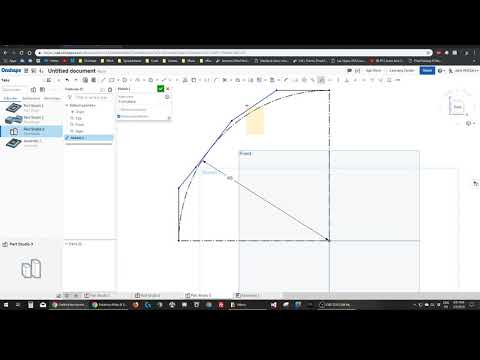

someone sent me how they did it in solidworks and wanted to know if the formula method is available in onshape

    Yes, but you will need to make variables rather than explicitly calling out "D3@First GOre" for example

    To be honest, I don't see why you need any variables or equations... that can be defined with only one dimension
  • digitalcarbondigitalcarbon Member Posts: 105 PRO
    how did you do that?
  • john_mcclaryjohn_mcclary Member, Developers Posts: 4,055 PRO
    edited March 2019
    All segments are tangent to the radius construction line.
    All 3 center segments are equal to each other.
    the end two segments are equal to each other and perpendicular to the horizontal and vertical lines respectively.
    Then just add a radius dimension, works with any angle.
    https://www.youtube.com/watch?v=kpU3T7A-x64
