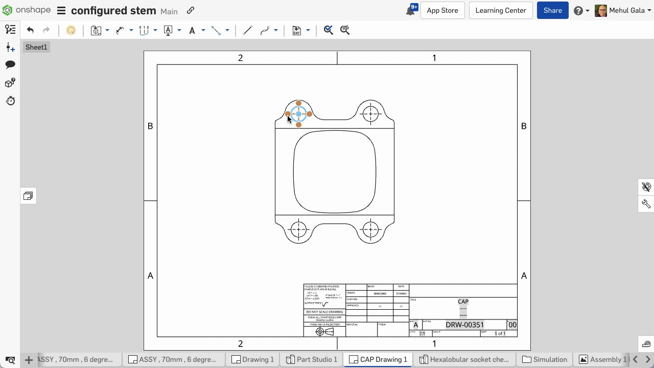

Hi - new to Onshape, but old at Solidworks - how can I create a center mark that extends past the hole? Like this:

    Hi @Paulo_C - welcome to Onshape! The centermark tool only puts crosshairs at the center of the hole. If you want to extend them you have to use the 2 point centerline. Please create an improvement request to have an option to change this behaviour in the category on the right -->

    I have also sent this question to the support and they answered that they are working on it ...
    The workaround is ok for a complete circle.
    It does not work properly for a partial circle, because the quarter circle points are not caught and it is difficult to place the line exactly.

    If I understand the request correctly, it would appear that this was released in the most recent update of Onshape last week.
    Improvements to Onshape - November 21st, 2022 — Onshape
