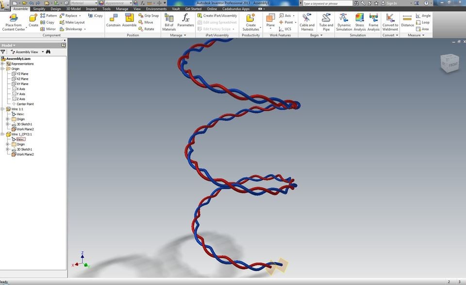

@S1mon im also facing this problem but my path is 3d not like 2d like the one above, And i tried this method but it wont work
I want to make some thing like this but in onshape
Is there any way to do that ?
@shin_chan990
You could try my helical path feature:
https://cad.onshape.com/documents/07469e1ecb66233675cf1e17/w/640e35f8ac294f2435fbcefd/e/b7c9c0f661277e76b9a76087
